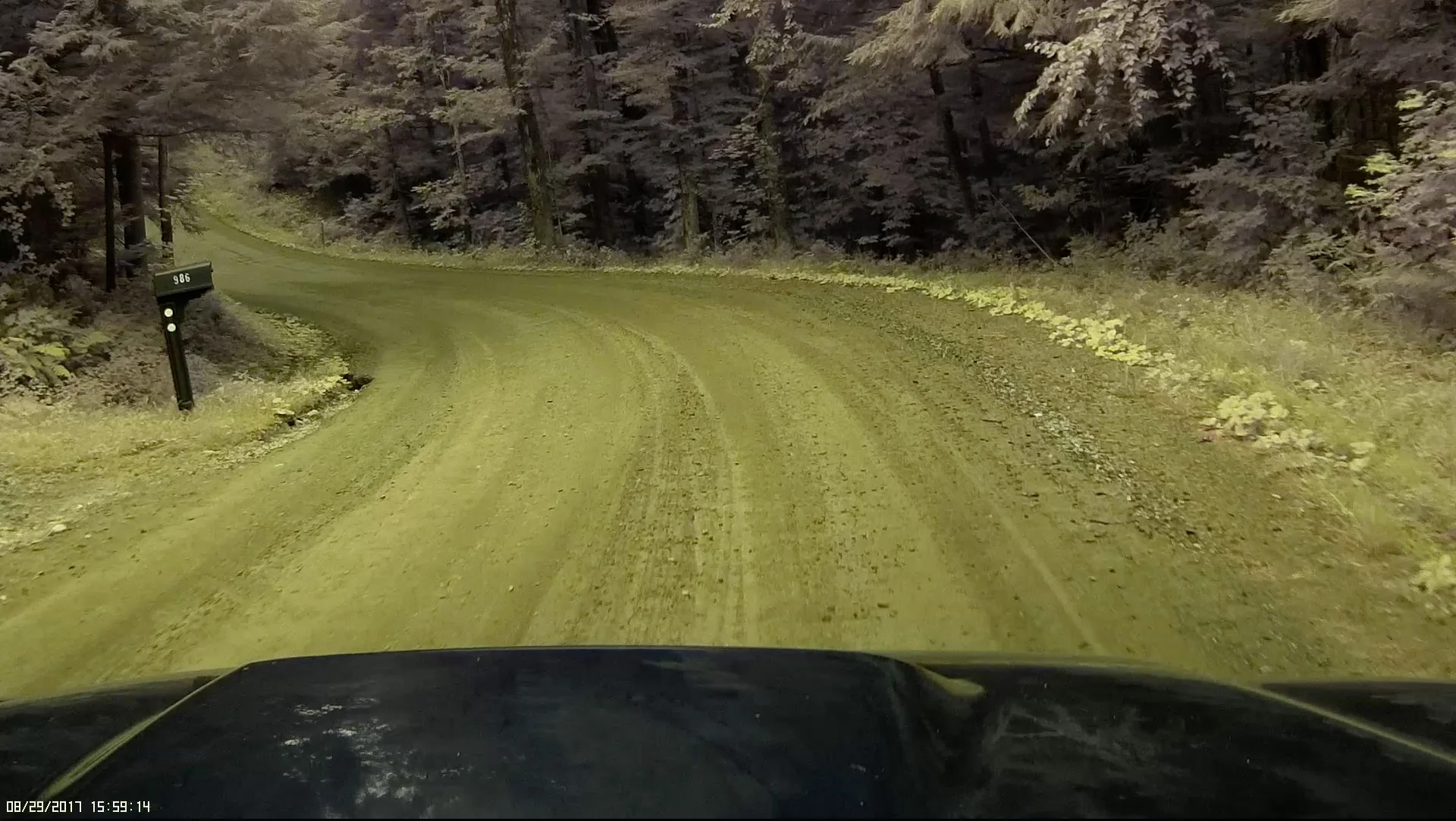

So, I've been doing some experiments mounting a polarizer on the 2.8 - 12mm varifocal lens with some interesting results. I just happened to have a 24mm (30mm) CPL which is exactly the proper diameter for this lens. Apparently, a standard CPL completely alters the color balance on an IR lens while having no effect on the color balance of an IR corrected lens. I'm still striving to understand exactly what the polarizer is doing to create this effect but at this point my understanding is that the polarizer is creating a dichroic effect that allows certain wavelengths of the visible and near-infra red spectrum to pass while blocking certain other wavelengths.....or something like that. Still doing research on this but I thought I'd post some examples in the meantime. It's a cool effect, at any rate. Oh, BTW, as a CPL it does what it is supposed to in ameliorating reflections (and making sky, clouds and vegetation look pretty cool!)
Dichroism - "In optics, a dichroic material is either one which causes visible light to be split up into distinct beams of different wavelengths (colors), or one in which light rays having different polarizations are absorbed by different amounts."
IR- No CPL
IR-With CPL
IR-With CPL
