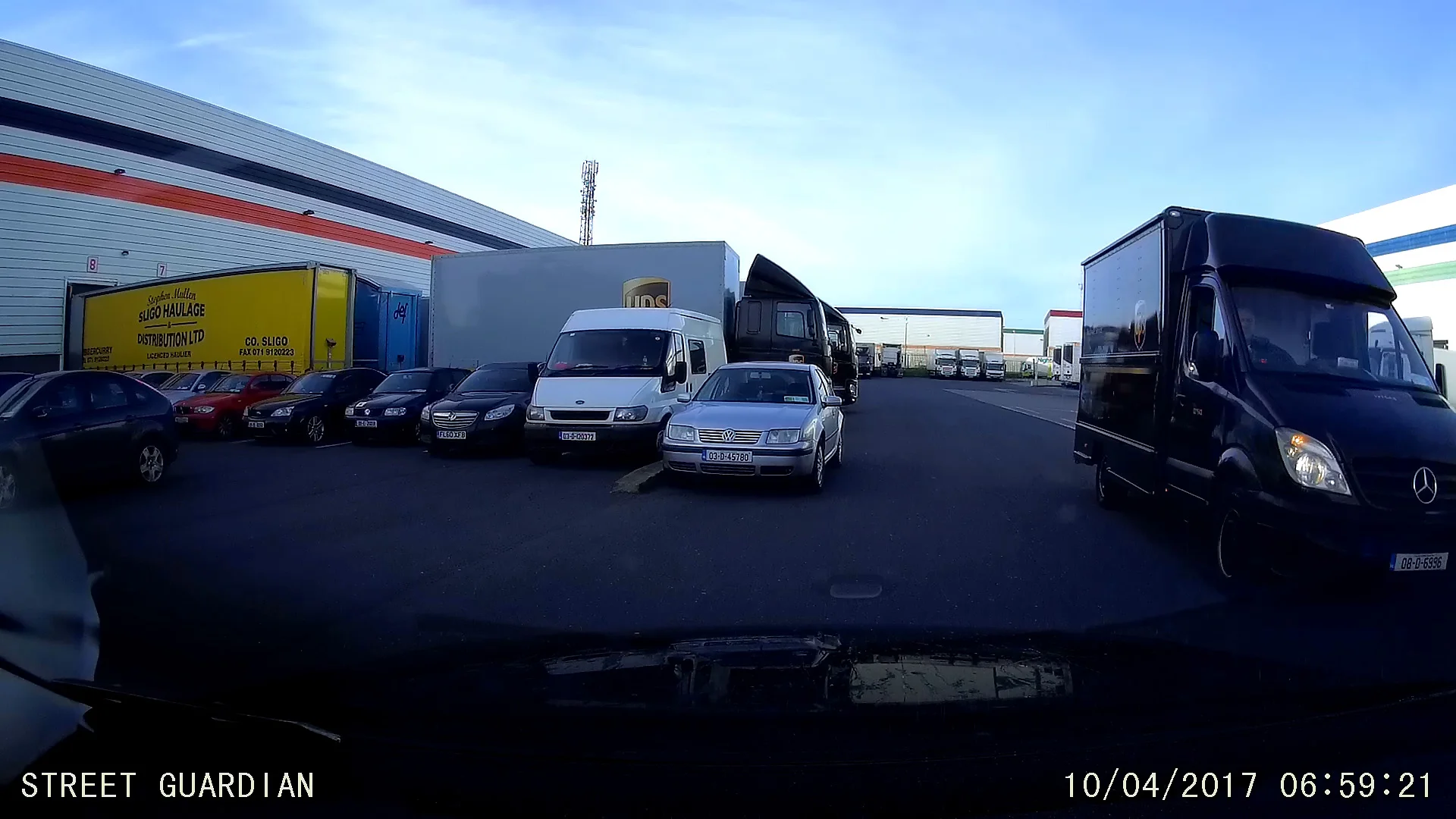

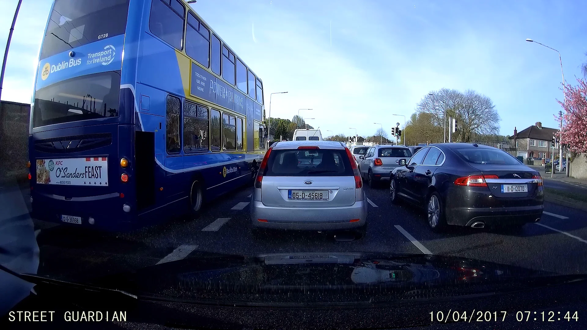

The angle of the sun after 2.5h isn't that much different that it would warrant such a shift in focus on the right hand side. Also on the last 2 sets, there is no difference in sun angle (same time, different day). As in all my previous comparisons in this thread, temperature is the only afflicting variable :/
Drove to work and parked the car with the replacement SG9665GC V3 facing the sun and drove off again a couple of hours later. Today was sunny, but temperature was only +-12°C.
Despite the low temperature, the problem became clear again: the replacement unit has the same issue, although it seems to be roughly limited to the right half of the frame this time. I'm not sure if it will stay like this in summer, it could get worse on the right hand side, or it could start to affect the whole frame. Either way, I don't think I'm ready to accept this from a 200€ dashcam @ 12°C, I'm sorry.
Even on a rather cool day..the direct sun through the glass must be warm enough..... There is no way your going to see what the OP was talking about on a smart phone. It's like looking at the lcd on the back of a DSLR Camera, thinking your photos are sharp, only to be shocked how out of focus they are when you open them up on the computer. On my computer..I can clearly see the before and after Sharp/Soft problem. The video gets a "dreamy, diffused," look, where in some cases, I could not read the plates right in front of me. After parking in the shade for 20 minutes or so.....it was greatly improved. I've had two units in a row that have the same issue. When you end up doing your detective work to find out the cause, I would definitely recommend viewing on a decent computer screen. Just a side not: I'm not talking about stretching out the videos screen to a larger than normal size and pixel peeping ...just to around what equates to a 5x7 inch on my computerthere's no way a 12°c day is warm enough to cause focus shift, must be something else going on here, not sure what yet but we'll work it out
