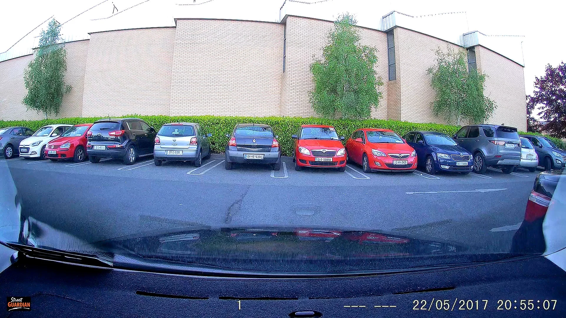

Hard to judge focus from footage while driving nearby trees.
Best way to test focus is to park car in open space car park or opposite brick wall, or if you will have combination of both this would be perfect. Something like below. For more detailed result do this test in non-cloudy day time (not evening like I did). Its just reference picture of the place how to test focus.

here it is, non cloudy day:
1 parkinglot - just before drive
2 parkinglot - after 5 minutes drive
