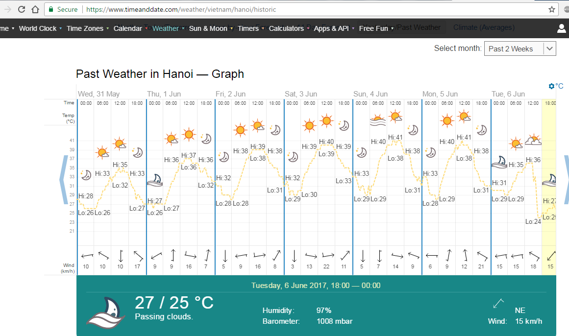

weird. Because my country's climate is very hot. Last week, the outside' temp is above 50 oC and everything's fine.
my car always parks in garage avoid directing heat from sun.
