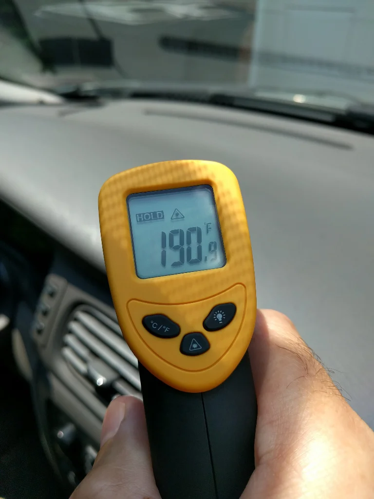

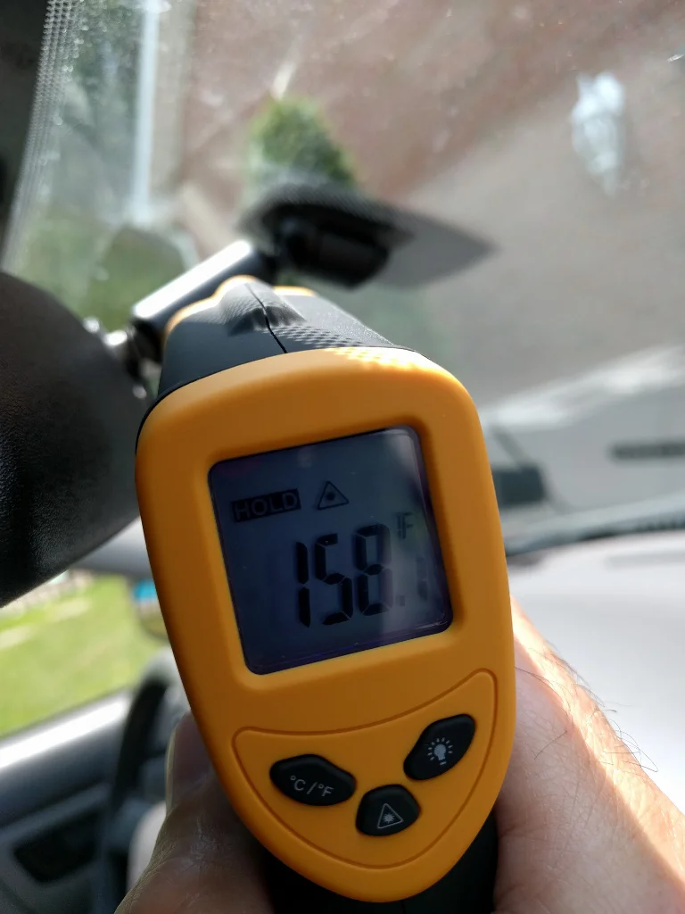

Remember to always check to make sure conditions are within specs:
Perfect! (Average sunny day in cloudy Pittsburgh) 🙂
View attachment 31538 View attachment 31539
don't know what that is in Celsius but I've measured 72°c at the camera on a 22°c day when parked in full afternoon sun facing west, the CMOS sensor is only rated to 60°c stable and 70°c operating temps, can't underestimate what sort of impact it can have
Just tells you how powerful a little bit of sunshine is.
