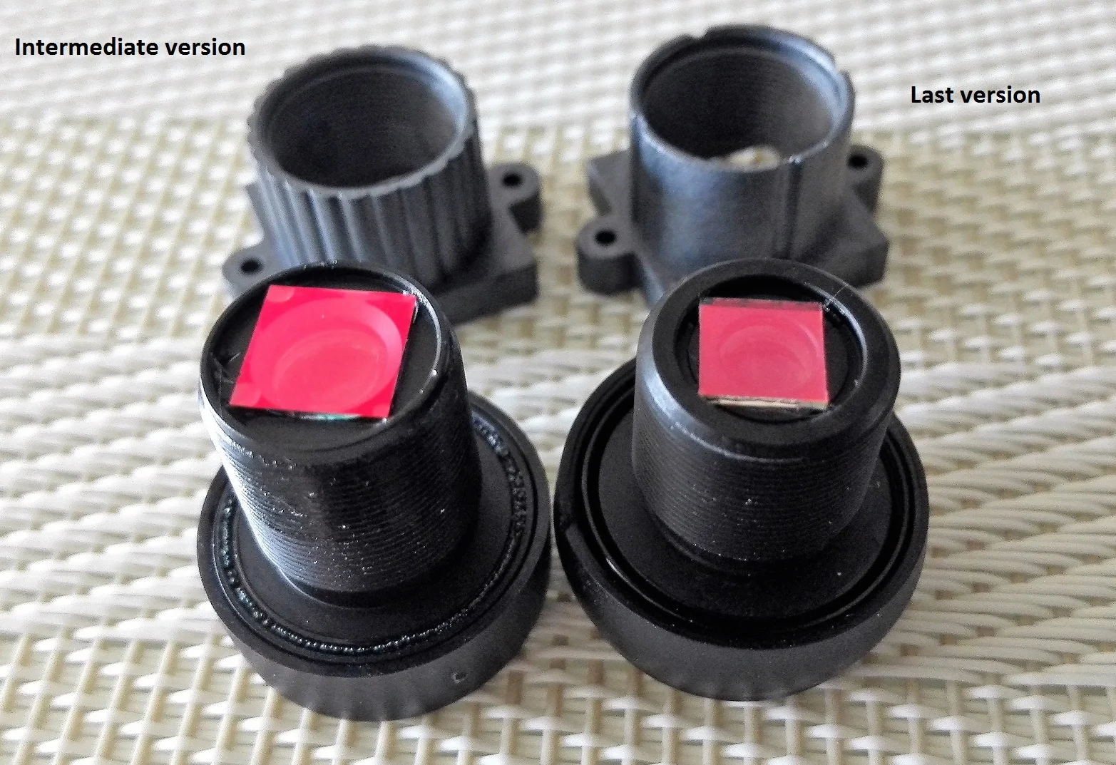

The lens holder on this new lens had a much flatter base and all the moulding marks were indented so didn't affect it sitting flat on the PCB - big improvement on the last one.
Don't know about the image quality, the 0906 doesn't stay turned on for long enough to be able to focus the lens and it doesn't record anything!

Thanks @Rayman.Chan I get last version.
Please find couple comparing pictures of intermediate and last version of lens.
lens2.jpg lens3.jpg lens4.jpg lens5.jpg lens6.jpg lens1.jpg lens8.jpg lens9.jpg lens10.jpg
you have a very good focus on the lens details.
we can only do this with a 100X micro lens on SLR camera.
The sensor on a DSLR is too big for this type of photo = the depth of field is too small, you need to use a small aperture setting to get anything reasonable.
Before I focused the new mini 0906 lens it could have taken images like these - small sensor = big depth of field (everything in focus). I got a good video of my fingerprint!
Gosha probably used a phone cam with a very small sensor and smaller aperture than the 0906.
That new lens are unlike any i have seen in relation to the 0906, the socket also i think cant remember if the replacement one was smooth or also had that ornamented thread "barrel"
