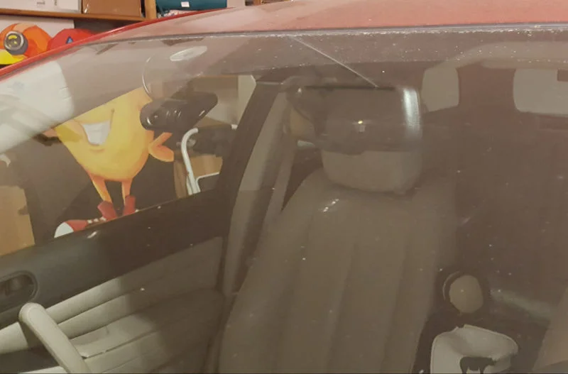

OK, I finally got around to setting this up with my second A119s. So far my impressions of this suction mount are not good. The construction is pretty cheap, particularly the connection between the camera mount and the suction portion (you'll see what I mean in the pictures - fitment/alignment isn't even close). None of the adjustments get tight enough to prevent the camera from being moved. If I could recommend this for anything, it would only be for a short term, temporary placement. If you can, I highly recommend using the adhesive mounts/GPS mount.

Looking at the pictures I think I see your problem. The locking ring at the ball is cross threaded. As is you cannot tighten it up enough to get it as tight as needed. I had the same problem with mine when I first got it.

That's how mine was received new as well, but it doesn't tighten any other way.
It will. It takes a bit to get it right but once you do, it makes a world of difference. I could get mine nice and tight with no flop or movement of the cam whereas before it would wiggle around and move with bumps, potholes and such. I think the design is a bit off with it all being far too easy to cross thread that ring.
