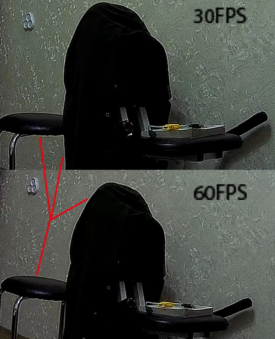

I compared, 60 much better !!
For low light 30fps will give better results but for 60fps it probably drops the frame rate or frame doubles to achieve the same result anyway, 60fps will generally look better in good lighting conditions
Regardless, use what you feel is best, there's no one set answer

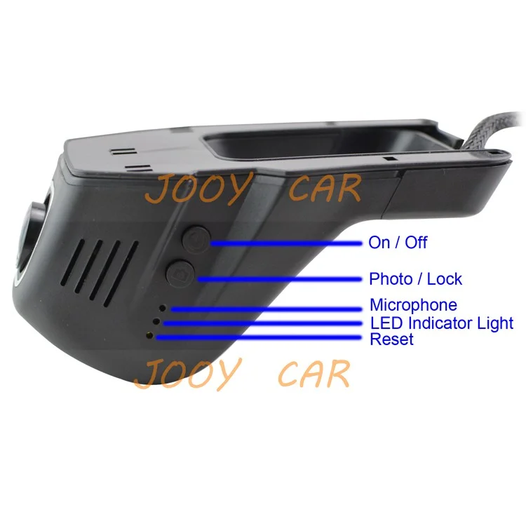

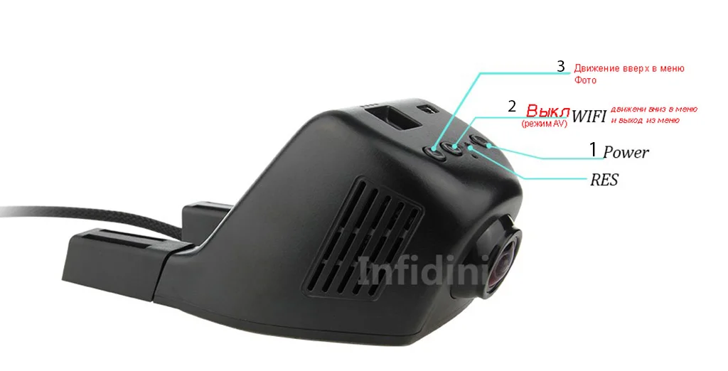

Can someone with JOOY A1 tell me the button presses needed to log into WIFI?
I am hearing or seeing responses only from power button and down button on my A307 so I am guessing A1 only has 2 buttons on the side and no other?
there is no such button, the last firmware made by Wifi is not disabled.
There is a firmware in which in a few minutes, the Wifi will shut down.
A short press on the power, turns on the wifi.
