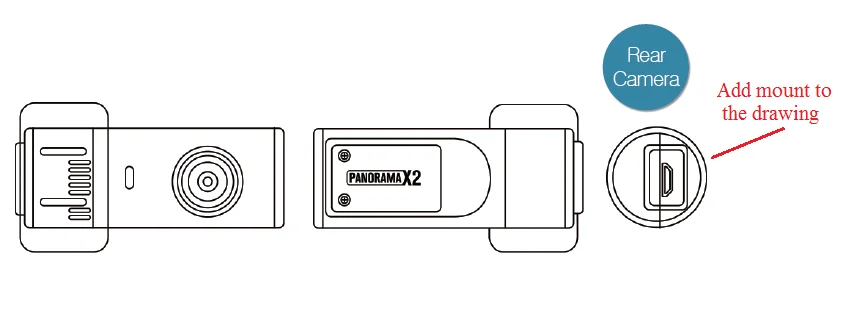

Page 12 has good images of the mounting bracket of the front camera unit. If this X2 uses the same cylinder mount as the 2 and S mount, then add a comment that the mount cylinder is the same. I can see that there is an offset in the drawing. Just add note stating the cylinder width, diameter and indexing ribs are the same (or not).
Page 13 needs a better side view that includes the mounting feature.

13, I can help with that once I receive inventory. I have a new lightbox studio setup to take photos.
