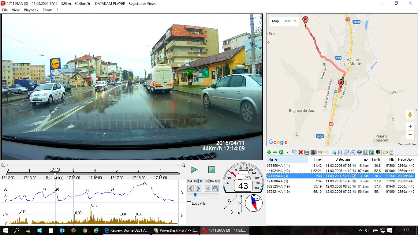

Sorry for the late response, but I was out of office. I use v6.0.0.8
Now download the file from you, see what displays in datakam player, after that I'll upload a screenshot.
Thank you Cristian.
Will be great to get this figured out.
BINGO!
The issue is the actual version of DATAKAM.
Release 5.9 and 6.001 do not display speed.
Downloaded 6.008 and I have speed.
OK, now look how it looks. I set speed in Km/h in the player, because it is used in my country.
Thanks again Cristian.
With your assistance we have the answers everyone was looking for. :)

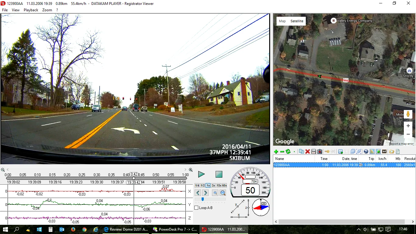

I notice that the date of clips with full GPS and speed data seems to be set to 2006 for both of us.
Any ideas?
I left the office and I got home, I had not noticed this, let me a while to check.
