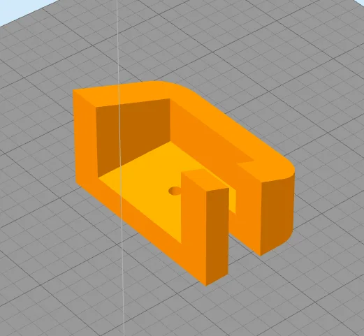

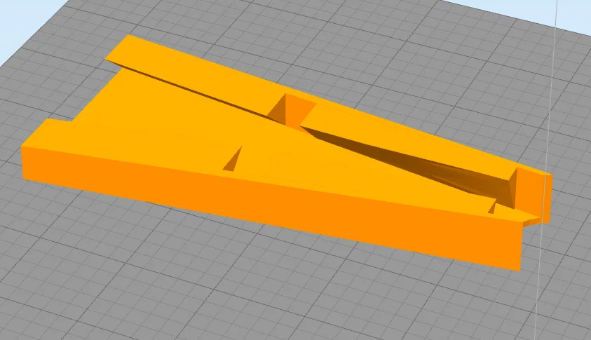

Here are the models for my rear view mirror 202 mount.
It requires 2 m3 screws at least 20mm for the base mount and 1 10mm m4 bolt for the bottom mount, you need to file the sides of the head of the m4 bolt so that the diameter of the flat sides are 6.5mm. If you leave it round A. It wont fit in the spot i made for it and B. if its left round it can rotate in place, if you flatten opposite sides it cant rotate anymore.
I made it for my mazda 3 rear view mirror which has a mount diameter of 20mm. I used 2 layers of black electrical tape as a little padding to keep it snug and tight.
Hopefully these can help you with a great mount with little to no modification for your car.

I have created a superior mount that is directly from the windshield.
requires 1 10mm m4 bolt and a 1mm washer/spacer
https://www.dropbox.com/s/a2vexy1iv732a5d/2016-04-16 23.42.01.jpg?dl=0
https://www.dropbox.com/s/jcrma65yscwuwxv/2016-04-16 21.49.31.jpg?dl=0
no camera shake when driving.
This was designed for a 20 degree angle windshield. Adjust as needed.
