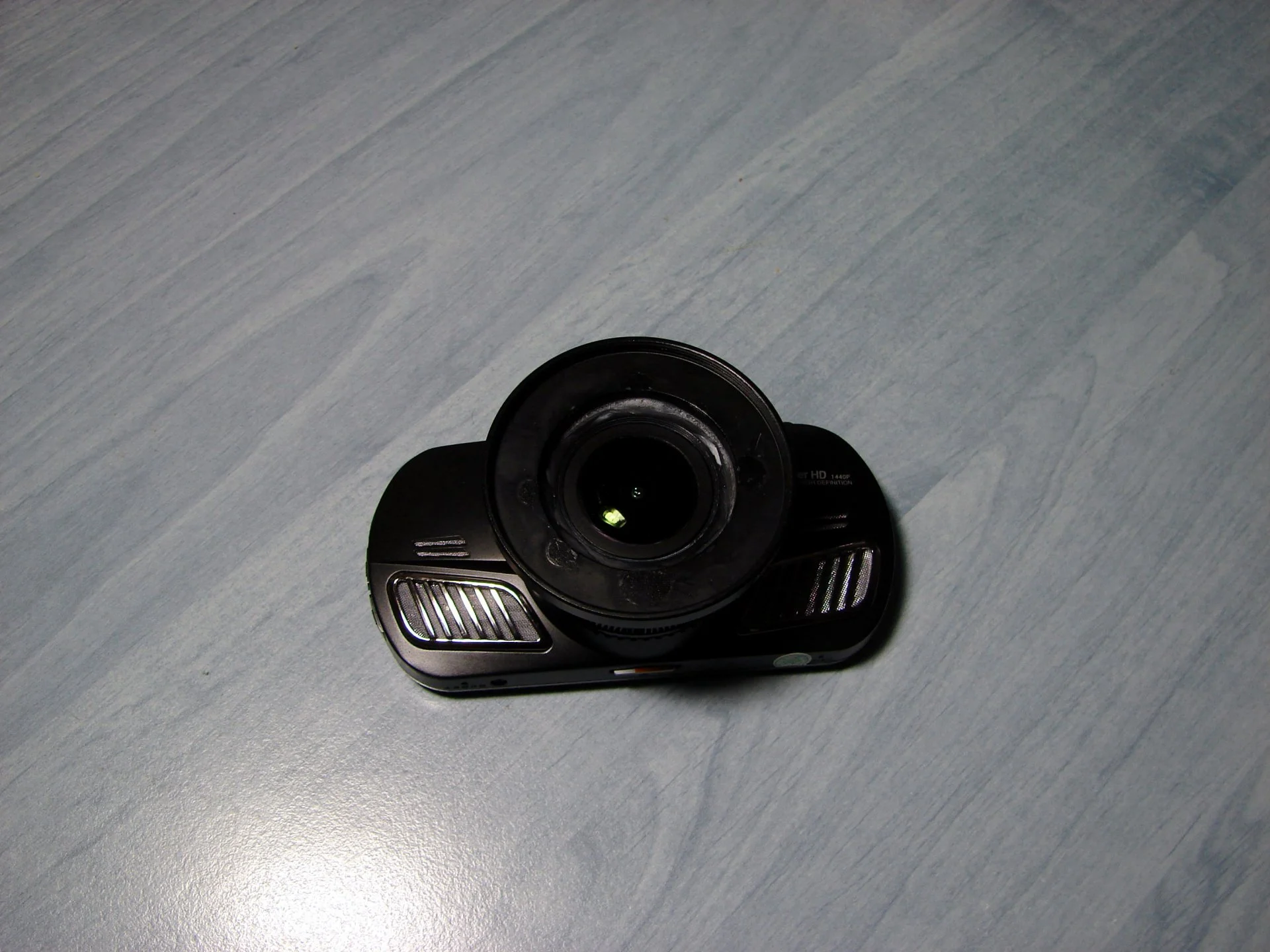

Now im trying to add CPL filter to my dvr as I did with G1WH. Im after attaching ring that will make it possible. It is a 49mm>52mm reduction ring. Now I'm waiting for 52mm CPL filter, should come in few days.

Please tell me that in the seal between the ring and the DVR ?
It's a rubber sealing ring,. I think it's for PCV pipes like in kitchen sink.
MATIN on D201 and Selco on G1WH

I believe the outside diameter of the lens housing on the DAB202 is about 35mm. Should be pretty easy. Just need to decide how much you want to spend on a CPL.
