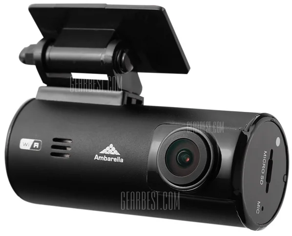

Looks kind of cool in that color but I hope mine does not fade. By the way, have you noticed there seems to be a design mistake on the mount? When mounted in the car it keeps the camera back away from the windshield. If you flip the sliding mount around, the camera sits closer to the glass with a minor downside....the two mounting surfaces, camera and mounting bracket end up a little off center... no big deal to me. I rather have the camera closer to the windshield to avoid unwanted reflections.
