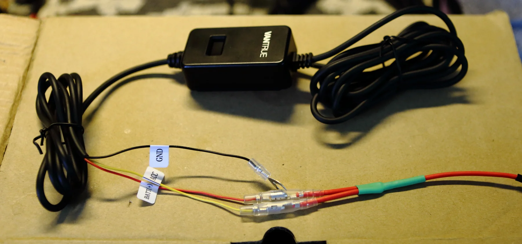

Since her sparse driving pattern isn't super conducive to using parking mode, I altered one of the fuse taps instead of altering the hardwire kit so the camera would turn on and off with the ignition and not occupy the 12v utility port in her dash. I figured altering the add-a-fuse and making it a Y cable preserves future flexibility for reinstalling the hardwire kit in a different car or using it with parking mode later on.

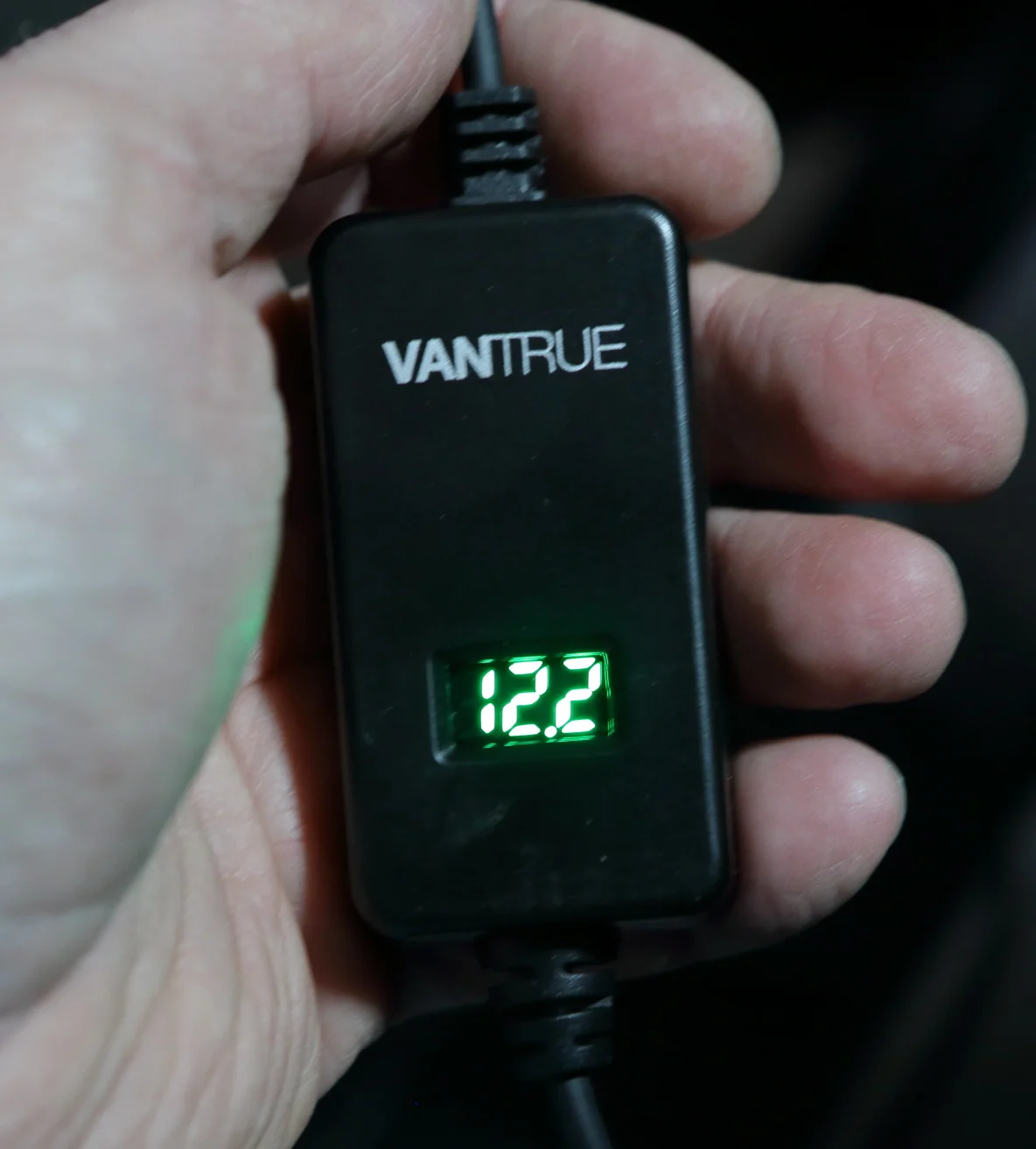

The next step was to test the functionality of the power supply. Success! Power goes on and off with the ignition exactly as I intended. It's surprisingly hard to get an image of this LED voltage meter as the individual segments flicker at a fairly high rate, so I kept getting images of a partially lit LCD panel until I slowed down the shutter speed a bit.

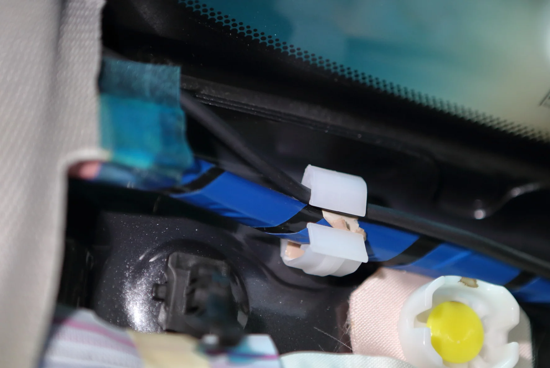

Getting the A-pillar trim piece off was a bit of a trick (more details below). Once this is off, the rest is easy. The black wire just above the blue-wrapped wire is for the dashcam.

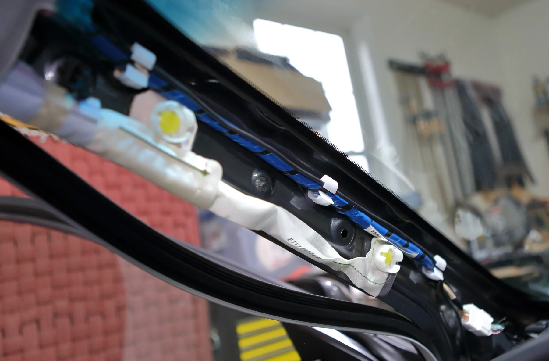

Again, to my pleasant surprise, there are three wire clips that readily accepted the dashcam's power cord, keeping it safely out of the way of the side curtain airbag. This is VERY important when hardwiring. You don't want the dashcam wire to interfere with the side curtain airbag unrolling during an accident!!
From there, I used the orange trim tool to lift the headliner away from the inner windshield so I could tuck the wire in and run it across the top of the windshield. At first, I was thinking the cord wouldn't be long enough to reach from the fusebox, up the dash, then the A-pillar, then across to the rearview mirror. As it turns out, this wasn't a concern at all, it reached exactly where I needed it to and I have a few feet left over. Cool!
The A-pillar cover on the Camry has this really annoying black rotating clip that I presume is intended to allow the airbag to deploy but still hold the trim piece in place and keep it from flying at the driver during an accident. This is annoying for working on it, but this is a good thing during an accident! You can see the black clip in the image below. You start removing the A-pillar cover at the top, it will pull out about an inch and then you have to stick your fingers under the cover and rotate that darn clip 90 degrees so the T-shaped part passes through the rectangular slot in the pillar cover. Then you can pull the cover the rest of the way off. This was the hardest part of the whole process.

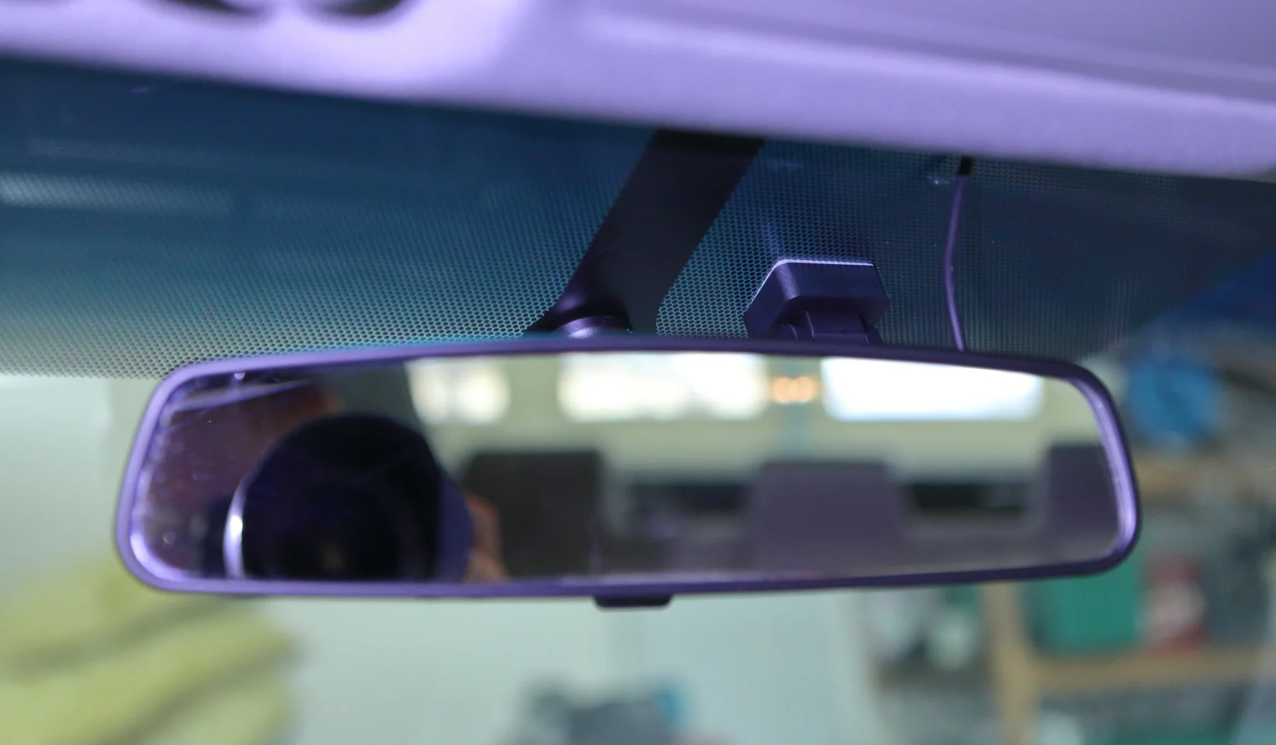

So here is the camera, tucked behind the rearview mirror. The 3M VHB sticks to the little back dot texture just fine and the camera peeks out beneath the dots through the clear part of the windshield. This is the view from the driver's position. Super clean install! It's nearly invisible. I might have been able to move the camera down anouther 1/2 or so, but this works well.
And below is the view from the passenger seat.
