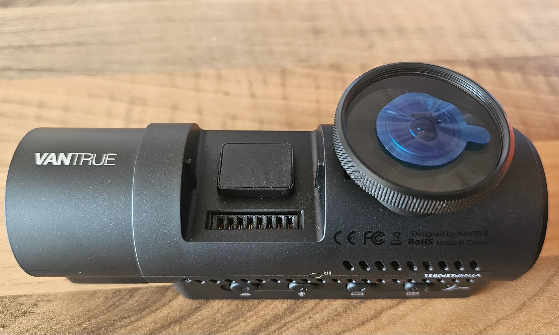

It seems odd to me that the rear camera CPL filter requires no adjustment (just cover and your done) but front cameras have filters that require precise rotational position. Why is that?
I'm wondering if it's got something to do with the threaded mounting method for attaching the polarizer to round lenses. Due to variations in the manufacturing process, I'm guessing it might be possible that the "start thread" might not be consistently/precisely oriented from unit to unit. Or, it’s got something to do with the orientation of the glass lens itself relative to the threaded mount. Similarly, with DSLR cameras and lenses, some outer lenses rotate as you zoom/focus, while others handle this internally, keeping the outer lens fixed as you zoom/focus. Thus, some ability to rotate the polarizer lens would be necessary in order to achieve the desired result.
The polarizer "plate" sold by Viofo is likely created in a similar manner as polarized sunglasses that don't need to be rotated for the best effect.

What orientation is the CPL on the camera? There are two notches which I presume will be at 3pm and 9pm (not 6pm 12pm)?

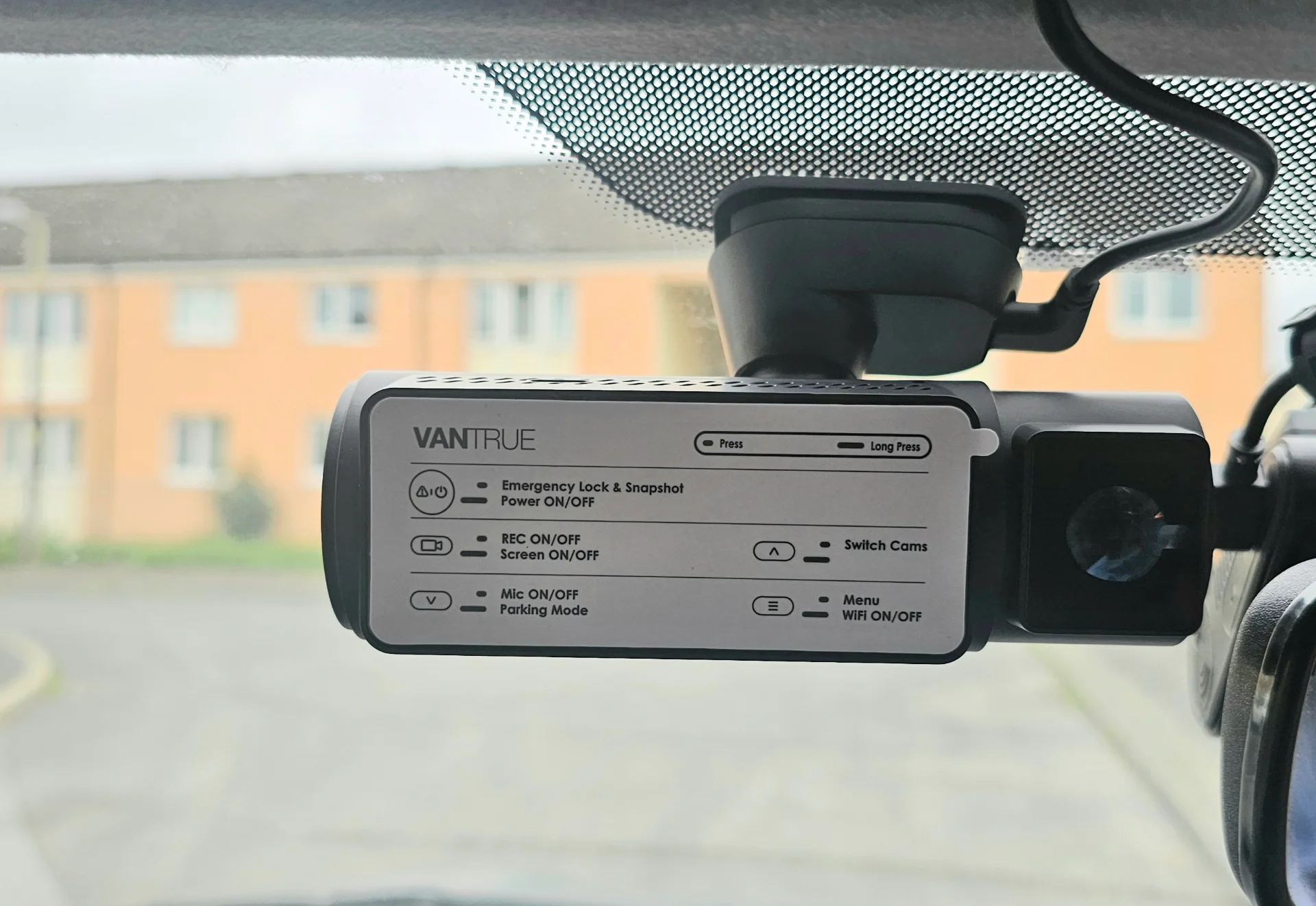

It is BIG on the windscreen as noted....
Rotate it until you have the desired result.
Just check for reflections of the dashboard on the display while rotating it. If they are gone or minimal, leave it.

As for polarizer orientation, I just checked three of the cameras I have installed, they are each different: 2 and 8 o'clock, 1 and 7 o'clock, and 11 and 5 o'clock. Hence, the ability to rotate the lens until if reflections are most reduced. I've found they in different situations, reflections are not always "gone" but they are very much reduced resulting in much greater image clarity.

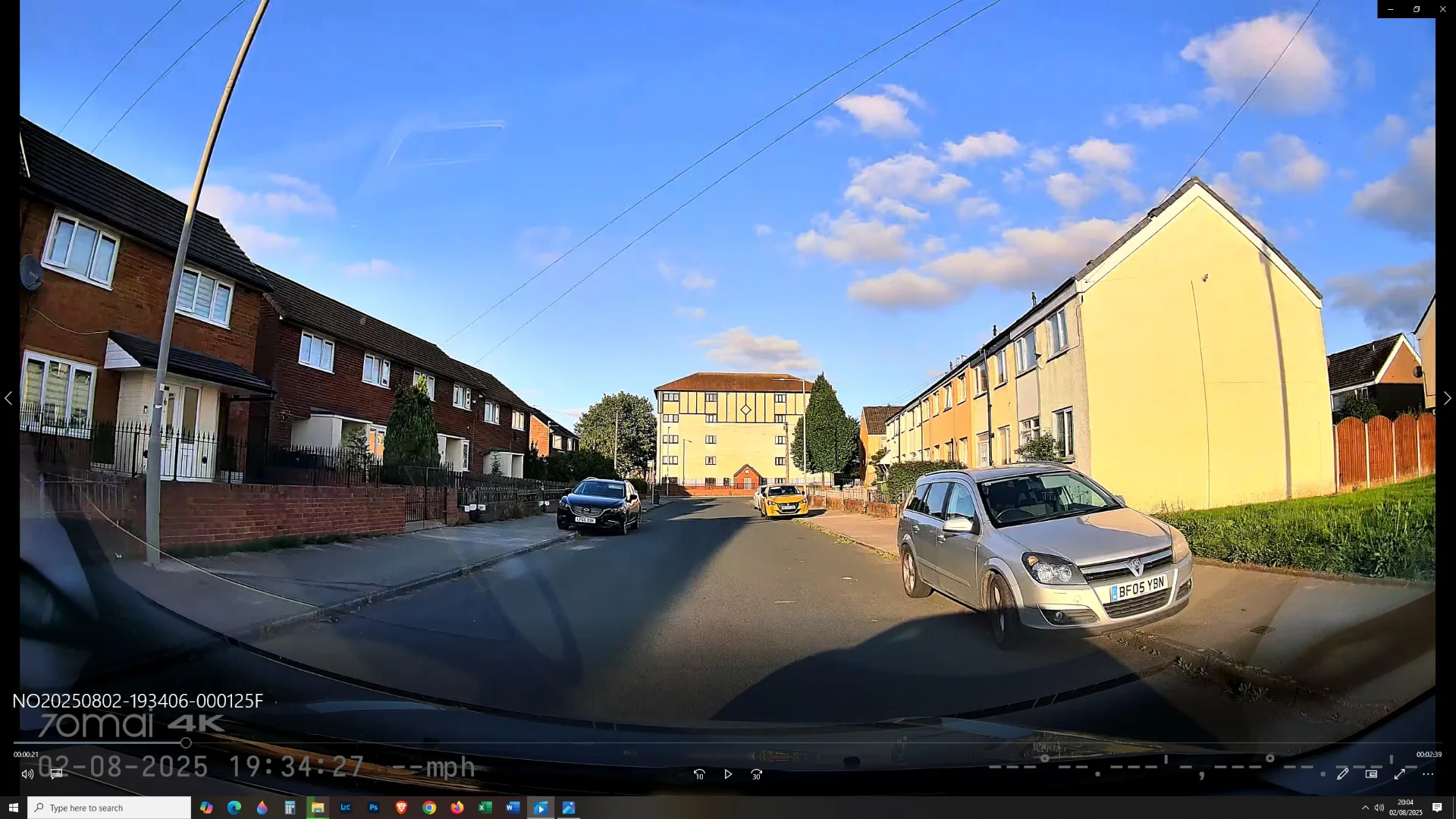

Seems to be some sharpening artefacts on the rooftops.

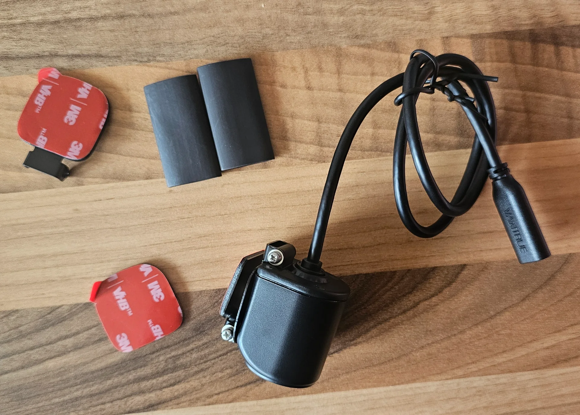

I am thinking of ordering the CPL-300 for S1 Pro Max rear camera. What would you use for the N4 Pro S rear camera as a CPL via Viofo?
I’ve been wondering about this, too. A rear polarizer is clearly useful. The cpl-300 will definitely not fit the RC-09 rear camera for the N4 series of cameras. Someone (viofo?) has a rear polarizer that looks like it has plastic clips that hold it in place, kinda like the earpieces of glasses. I saw it a while ago, but didn’t save a link - not sure whose web page I was on.
That white line is a pretty clear tell-tale sign, huh? From time to time, I’ve wondered if a user-setting would be useful here: low, medium, high).
@jsmith - Think I found it again, not sure which one might work best, but here are a few rear polarizers. Looks like some tape around the body of the camera would hold the polarizer in place by the ears.
