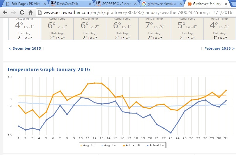

It turn out: SG9665GC don't like cold weather :)
In winter of Giraltovce , the lowest tem is -16 C, but I remember storage temperature range of 9665 is from -20 to 60.
