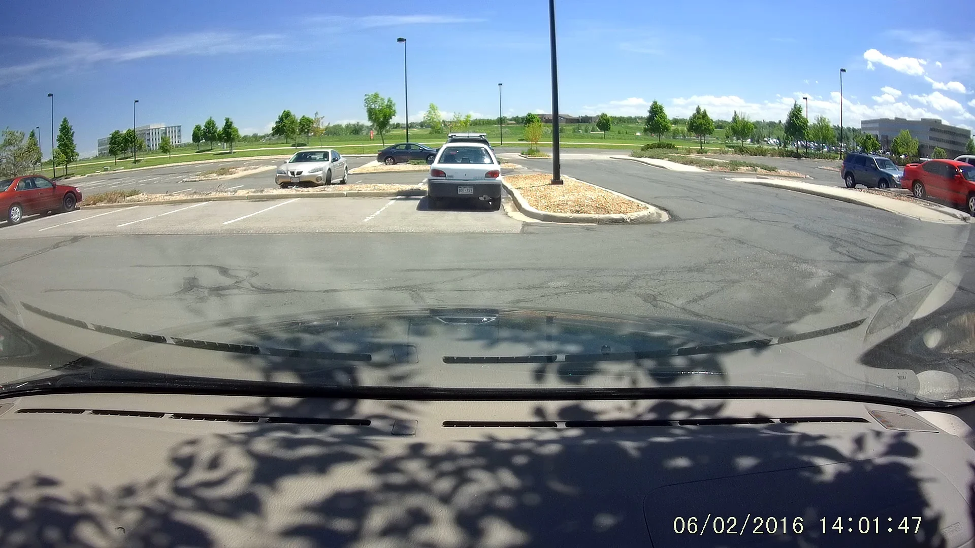

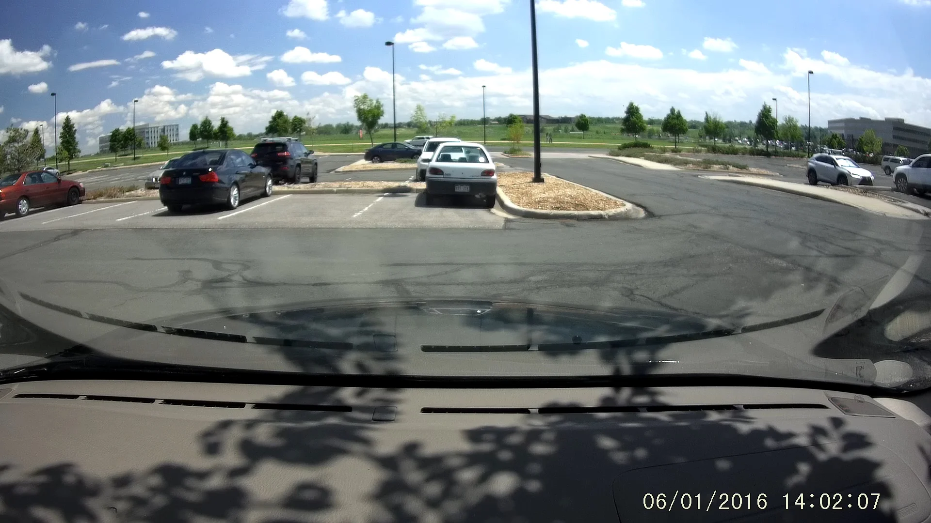

There is definitely a heat component adding to the out of focus issue on my camera. The first picture(6.1.16.jpg) is from yesterday afternoon, temps in the low to mid 70s. The camera stayed in the car all day. The windows were cracked and the camera was not attached to its mount so it wasn't in direct sun. The second picture(6.2.16.jpg) is from today, temps are in the low to mid 80s. I took the camera inside with me for the day. Both are out of focus but yesterdays is very bad. I'm not trying to beat a dead horse, I was curious about the heat and thought I would share what I found.
A replacement is on the way, I look forward to trying it out.
