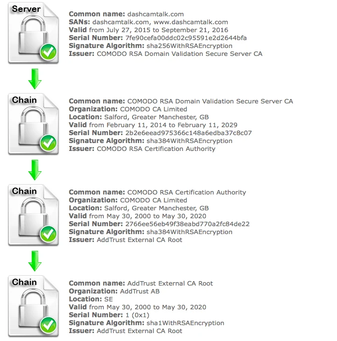

It does look like the cert chains changed recently from 4 down to 3?
From a couple of weeks ago:
And then now (it's missing the AddTrust External CA Root from the end now)
I'm not sure if the missing AddTrust External CA Root is causing problems for some Android apps?
From what I've read Android does sound like it can be a pain in the arse with certain root certs.
I suspect this might have caused the problem. The cert chain should be 3 not 4. (dashcamtalk, comodo, root). I have corrected it yesterday with 3.
Every SSL test that I run on the site indicates that SSL certs are correct though and it works on every device except some Android ones. I will continue to investigate this though.
