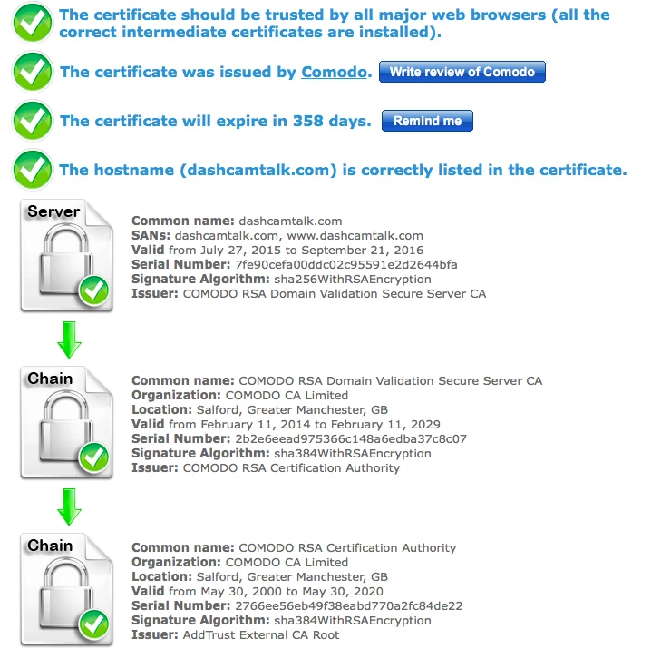

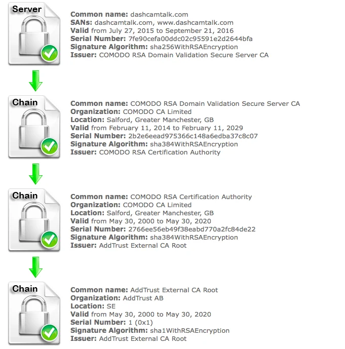

It does look like the cert chains changed recently from 4 down to 3?
From a couple of weeks ago:
And then now (it's missing the AddTrust External CA Root from the end now)

I'm not sure if the missing AddTrust External CA Root is causing problems for some Android apps?
From what I've read Android does sound like it can be a pain in the arse with certain root certs.
Is it worth disabling SSL (or at least stopping all http redirections to https) temporarily just to see if that gets the dodgy Android devices working?
