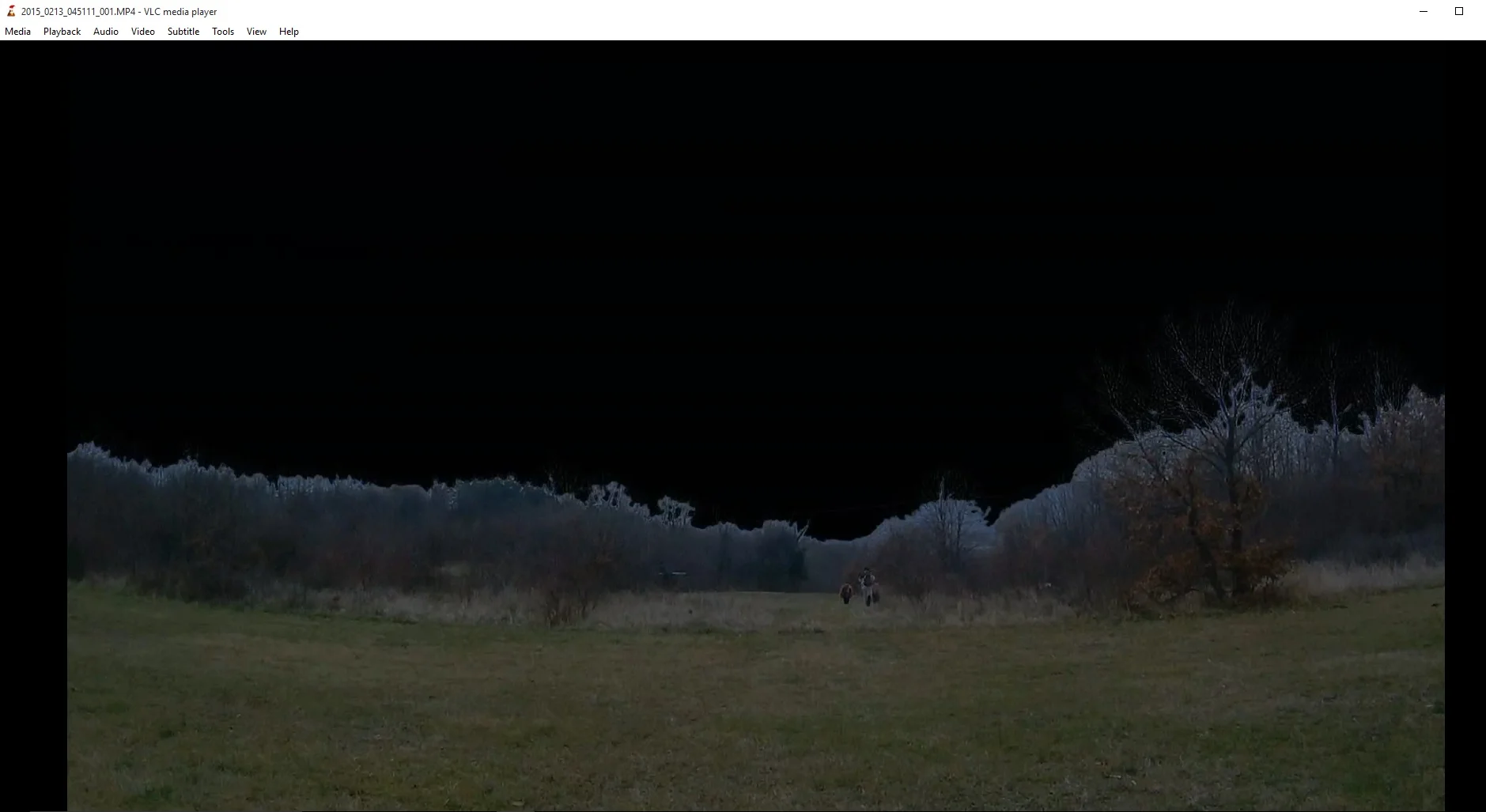

I think I found a weird issue. I am not an engineer, so I can not tell you why it happens, but sometimes my SJ4000+ and SJCAM M10+ (I had two, so happens on both) blackout when camera tries to change the exposure.
So basically, a weird black background appears in 1 frame (fraction of a second).
It is hard to explain, but here is a frame exported.
It would be good if engineers could look into it. Its 1 frame only, but its visible during video.
Can it be fixed in software? Obviously issue appears on multiple cameras not only on 1.
Posted more photos on Facebook https://www.facebook.com/actioncamerafans/posts/1696107380603878
Using latest 1.6 FW.
If you are interested in taking a look at it I can send you video sample.

Just to troubleshoot, do you think it is an issue with the Memory card? Is card formatted in Fat32? We have not seen this issue before.
What are the exact camera settings you are using?
Okay, so I also thought it might be a memory card. But from what I remember (not 100% sure) I used few different cards while testing it.
Here is a RAW video (black frame appears at 0:15) - download it do not view it on DropBox player.
https://www.dropbox.com/s/gat5r1zjn8f32hr/2015_0213_044441_015 1080p 60 fps blackout at 0 15.MP4?dl=0
(I have several on which issue appears basically 70% of videos).
As for settings, nothing special, WB Auto, Exposure Auto, HDR Off, Gyro ON.
It would be good if engineers can take a look at it, and also confirm if the focus of the camera is normal, like on other M10+ you have. In my opinion its quite soft, maybe because of Gyro?

Okay, we are checking this issue out. Thanks for the video.
@Pavle, this is only happening of M10+? Not on SJ4000+, correct?
Can you guys list out the current known issues and we will try to send them to our engineers in the morning?
List format and concise is best.

Don't have SJ4000 Gyro as I gave it away on a competition, it is the best for engineers to put cameras side by side and see if that appears on other models. I will try to see if it happens on some samples that I have left in my PC.
Does this only happen outside? Or in all settings?
When facing a bright sky mostly. I do not test cameras indoors to be honest, as they are action cameras. You can see more examples here (frames exported to photos)
Overall, I told you everything I know, you need to analyze it with engineers and see when if and why it happens, that's why you are paying them for after all.
Okay, we will check tomorrow when there is daylight.
Cheers!
So I just re-watched some of the videos taken in initial firmware on the first M10+ that I had (broke it apart) and same thing happens.
This confirms that this is not a firmware or memory card issue and that it happens on more cameras.
I recorded in 1080p 60 fps, as that's the resolution I like the most.
How come nobody noticed this before? Not even I did :O
Hopefully this will be fixed ASAP, as it really kills overall video impression.

it has all the earmarks of being sensor problem ....

I took a bunch of footage today and other days. Techmoan's footage and many other reviewers did not complain about this issue. I really think it is a card issue. Again, we can upload many raw video files of v1.5 (shot using a Toshiba Exceria 16gb Card). Maybe we are missing something in the frames as whatever issue you are experiencing happens very fast.
These are the cards we generally test with.

The problem that Pavle has was also reported on another forum by someone else, it's very interesting as my M10+ does not have this issue. I was also thinking that maybe the SD card is the culprit. I'm using normal "cheap" class 10 cards from Kingston and some EVO cards from Samsung.
