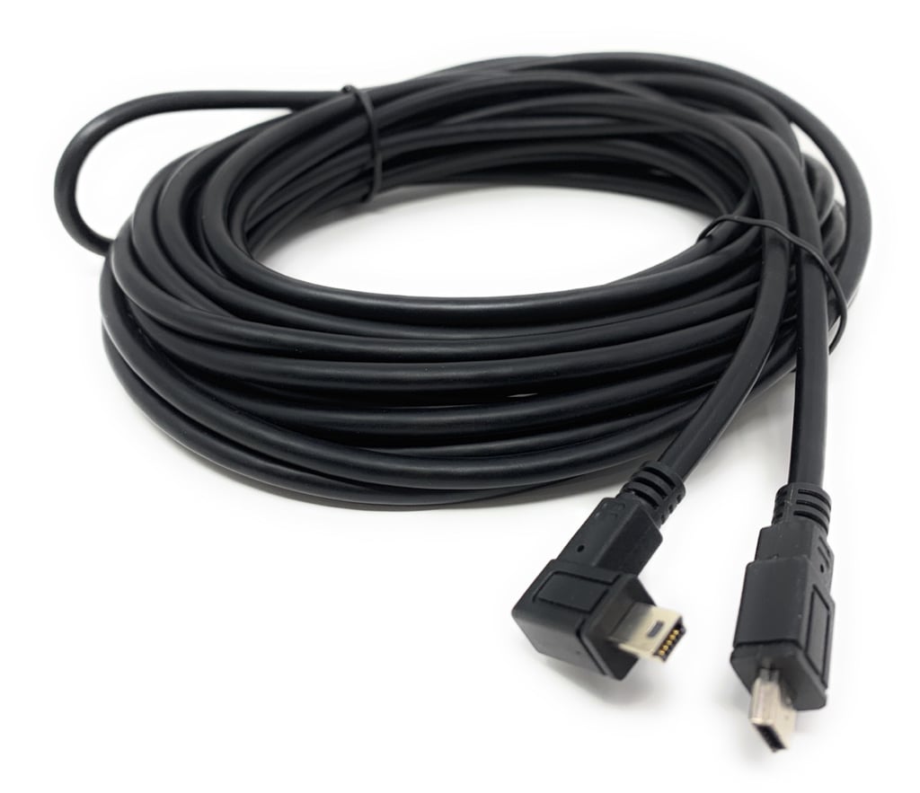

Is it true that the 8m cable has 90 degree plugs on both ends? Just got my 8m from Street Guardian USA but only one end is 90 degrees, another one is straight. Didn't unroll and measure the length though, will be doing that now.
We are doing a photo shoot of the 8M cable and I'll post photos later today. The temp photo on the listing is not correct. (will be updated/fixed asap to show 90 on one end straight on the other end)
