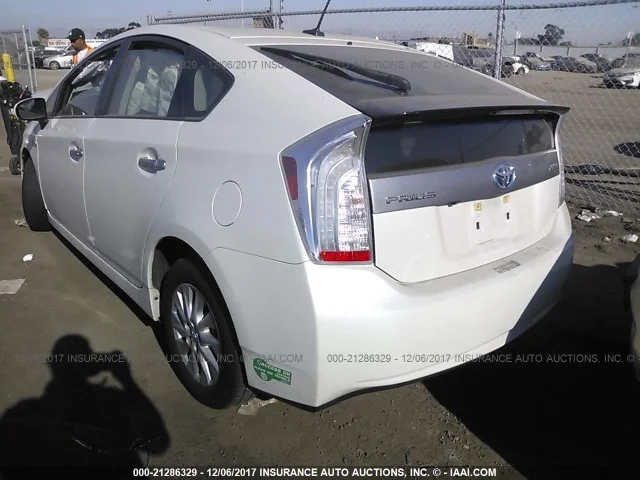

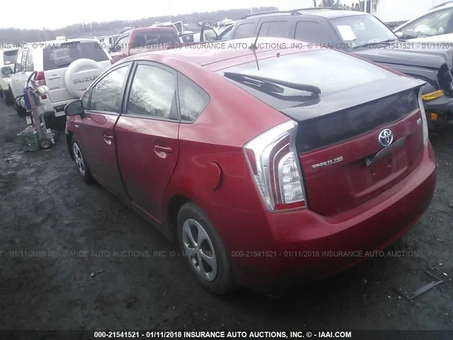

Got hw kit a few days ago, just started mounting the camera and doing the wiring. Didn't realize that one bracket is thin while another is thick. One bracket would fit only after 10 minutes of pushing it, but then I had to remove it since I forgot to apply the EVA foam to the back of the camera. After applying the foam I couldn't get that bracket to fit after another 10 minute pushing struggle session. I gave up on it and tried another bracket, which fit rather easy, within 10 seconds, so I went with that one. I know that a tighter fit is better, but, uh, I'm not going to battle the tighter bracket for 30 minutes.
Turns out I used a thicker bracket. There is no practical difference between the two, right? Aside from having more clearence to turn the camera around with the filter on it.
Debating over where to attach the rear camera in 2014 Toyota Prius. It has two glass pieces in the back. One is very big horizontal-ish window, the wiper is on top of it. Another is a small vertical window right below the spoiler where the car's backing up camera is. The cord is only long enough to attach the camera to the top of the big window, but I'm worried that the camera will have 1-2 meter blind spot right behind the car due to the window angle and the spoiler obstructing the view. Maybe it's better to extend the power+data cable (buy some female mini usb to male mini usb cord off aliexpress) and attach the camera to the vertical window below the spoiler?
Here are pictures of what I'm talking about:
