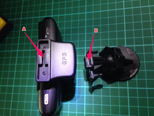

In my previous post I commented on the fact that the mount (with the locking clip) was a very tight fitting in the slot on my Panorama G.
Well I think I've solved it from my point of view.
If you look at the enclosed photo you will see I've marked 2 parts A&B.
Part A is the slot on top of the GPS unit and I've measured the width with my micrometer as 2.3mm, and Part B, which is the inner bar on the mount, I've measured as 2.5mm.
This makes things quite a tight fit, so I took a small file to the sides of Part B, and filed a "small" amount of the plastic away, and "voila", a nice snug, but not tight fit [emoji106]

Nice, better to be too tight than too loose. I'll pass this feedback to the factory for future adjustments.

I made sure it wasn't too loose in the slot, but reasonably tight. I think it's also helped by the locking tab which keeps it well in place.

From my experience after month and a half of use and periodically removing camera I noticed that mount become loose and some times squeaking noise appeared.

Which mount are you using? Swivel Suction or adhesive ball socket?
The G slot is metal and the mount is plastic. If yours is loose and the other post was too tight you might need a new mount. I'll be happy to send you a replacement if needed. (Or even a different type I'm testing). Send me a PM.
