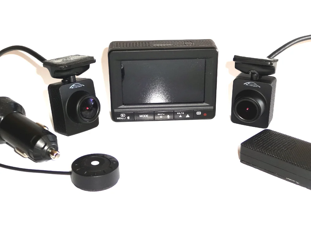

SEE PHOTOS OF WHATS IN THE BOX?
says he got another 2nd unit
for " his new car "
visit Techmoans Website , has a lengthy review or see his youtube channel
read from the users who own / what they are saying on his forums
for more info on the K1S / Techmoans New Favorite DashCam for 2015
