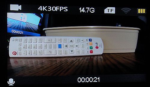

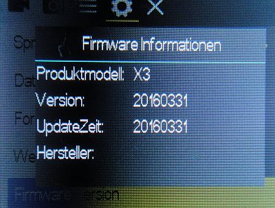

Could you please share the firmware from this guy? (Backup script link above)
Camera was delivered (April 2016) with this firmware
Great! Earlier versions can contain more interesting things. Would you please dump its FW with the backup script?
Thanks... completely new company cst179s_sdv-eng 4.2.2, does your HDMI out work?
