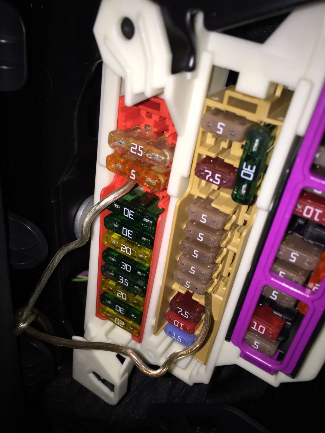

Sorry Janal - I have not forgotten - there was not a decent time I could take the pictures the last couple of days and this morning when there finally was time, dry weather and bright...it seems -5 Celsius is enough to seize the lock on my shed door so I couldnt get to the tools to open up the panel.
Hopefully during the day it will unseize and I can grab the info today
janal - please find attached my setup
I'm pretty sure the middle bank one is the lumbar support and the last bank is possibly the horn...you can have a look at your own setup + user manual that has the diagrams for the fuse layout.
Remember this is a UK spec car so for me, it's the drivers side

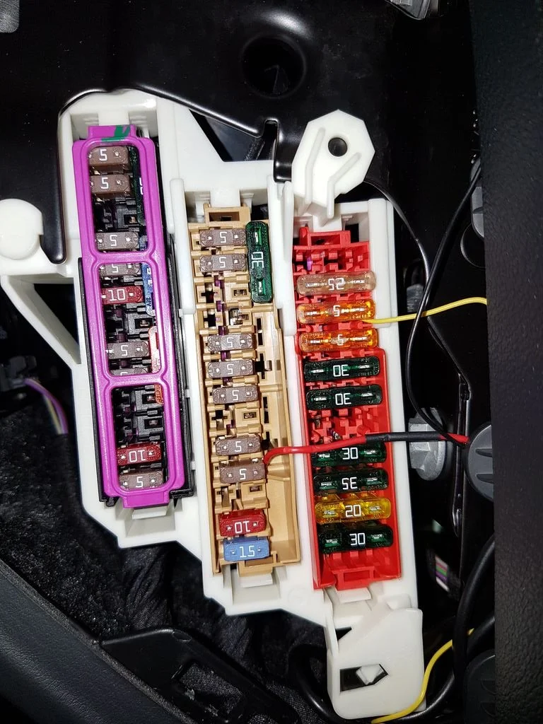

IMG_1482.webp My block looks like a mirror image of yours and is on the left (driver) side. I am not using yellow and red wires. You may not see it well in the pic but the darker wire is the red. I will be putting yellow tape on the lighter wire in the red bank of fuses. When all is working correctly I will change the pic to show a better differentiation between the wires.
Unlike your A6 I have no fuse inserted in the centre row where you do, and have additional fuses that you do not. Should I get a spare fuse to insert into the empty slot I am using for the yellow wire?
The good result is that the f750 now goes into parking mode with stop action. During this phase my white LEDs flash as b4. However, the power ceases between 5 and 7 hours, and all LEDs stop flashing. This means, the F750 is no longer drawing continuous battery power, and no longer takes pics. This is the bad result. Before, everything worked on continuous recording for at least 48 hours. What is your battery run down voltage cut off?
Also, parking mode ceases when I open the door rather than when I press the start button. Is this normal?
My other concern is that in parking mode, the time lapse works fine, but recording shuts down after 2 minutes, and then records again 30 minutes later for another 2 minutes and so on. I am wondering if you experience this.
Perhaps it means that it takes 30 minutes at 1 frame per second to fill each recording file rather than 1 minute to fill at 30 fps if that is the speed. What do you think about that?
