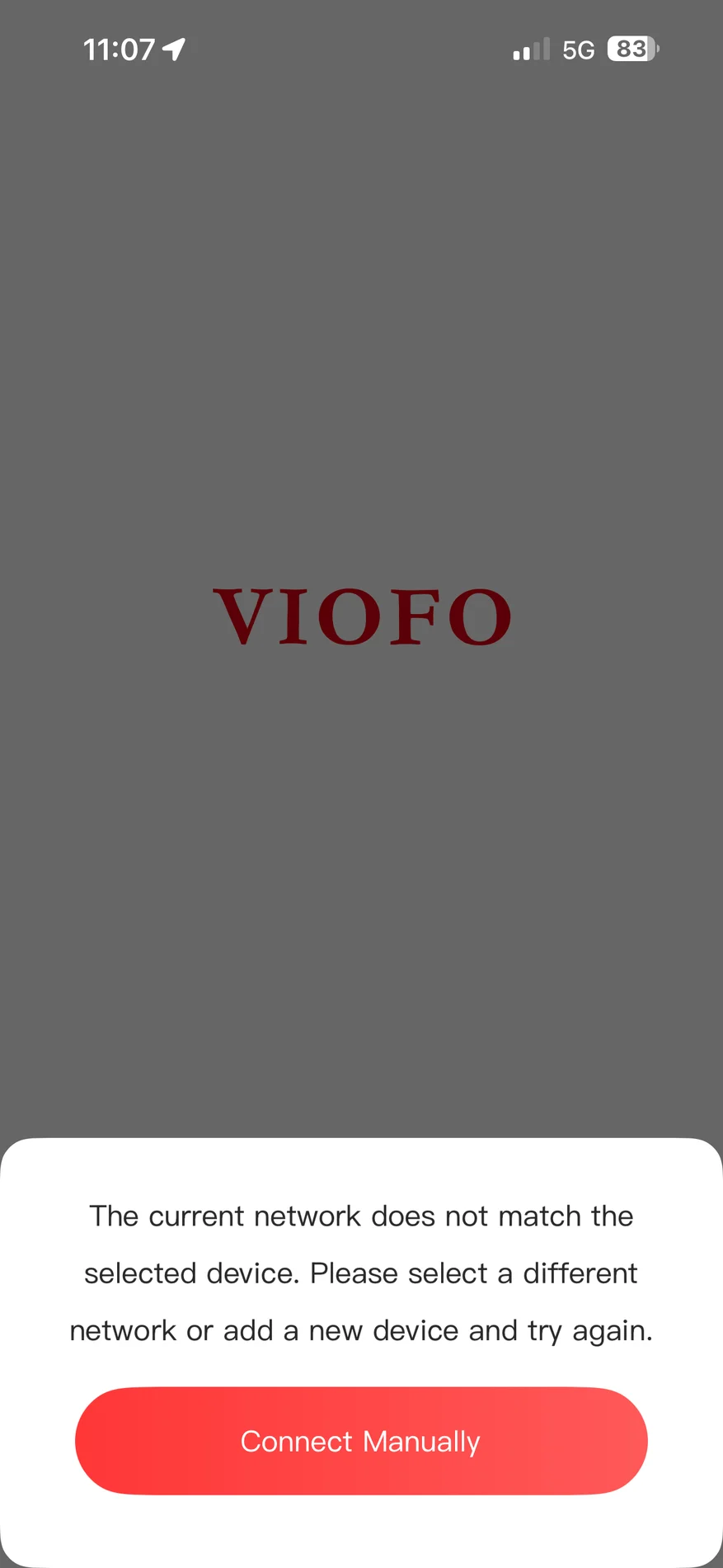

@viofo @VIOFO-Support I am getting a following error when I try to use the new beta IOS app with firmware VIOFO_A329S_V2.0_251027. It works perfectly with the the old IOS app though. Am I doing anything wrong?
what is your app version number? On the app main screen, you can try to click the "+" to add the new camera, then follow the steps to connect the Wi-Fi.
@VIOFO-Support The app version is 1.0.2.15 and I don't see any "+" button.
There is only a "Connect New Device" which then asks me to select the model. After selecting it (A329S) I get the WIFI setup instructions (already connected to the dashcam) and then finally the error message from my previous message.
