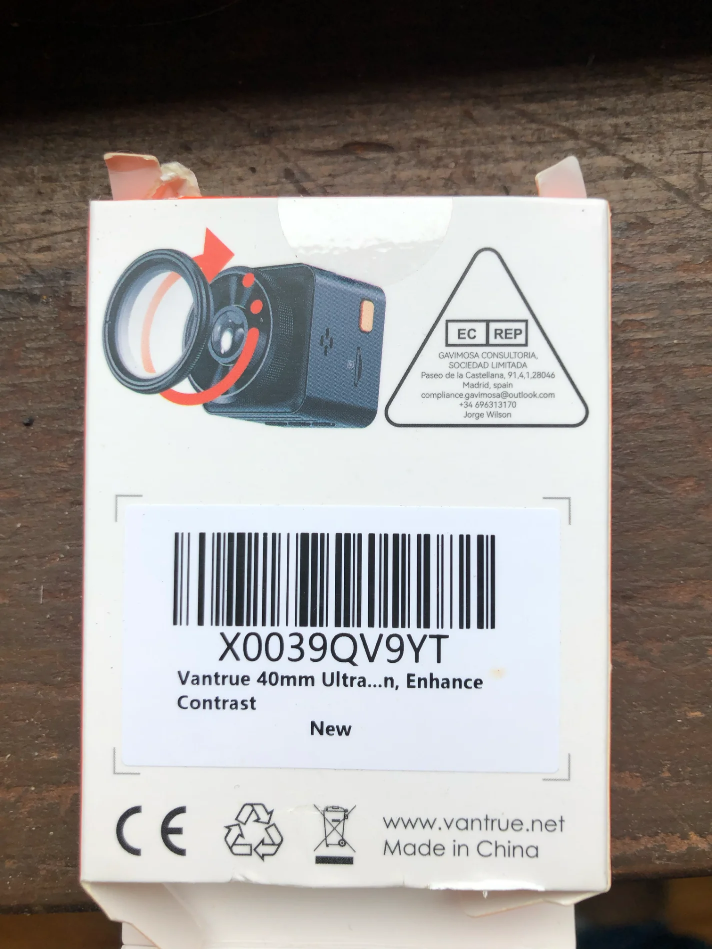

Wow now I understand. That is not obvious. The back of the box gives some indication.
I definitely see now that there are two stiff rings that rotate.
Rotate it while watching the live feed until the reflections are as little as possible and enjoy.
It should improve the image.
It would be helpful if Vantrue offered users some basic advice on how to install a CPL filter, especially since this one screws in so it is not going to be correctly aligned when first attached. There are two indents on the outer ring but it's not clear what they are for. I recall mine ended up at 45deg positions when the filter was oriented correctly to minimise reflections.
They don't make it clear for sure, that you have to turn it (at least for Vantrue) to minimise the reflections as you say. Viofo you don't have to cos it has the lines to show you the alignment. But they are a bit more fiddly for me compared to Vantrue.
Either way I tend to manually check anyways that reflections are minimised ...

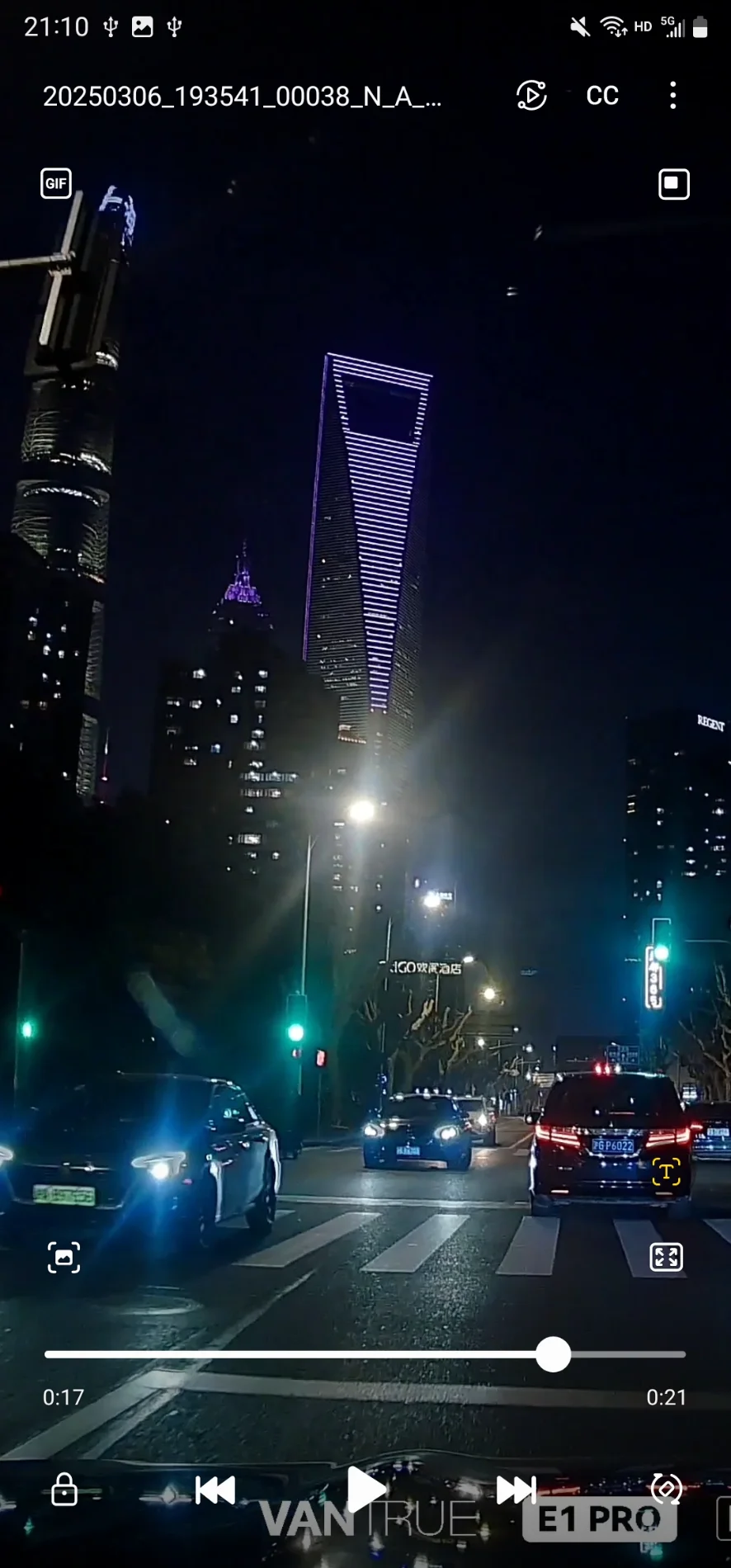

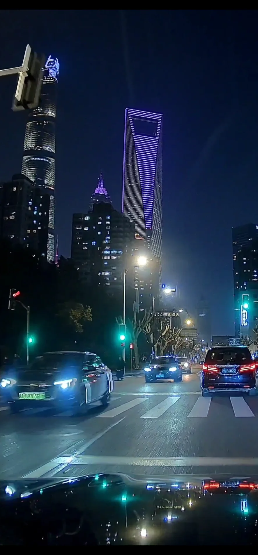

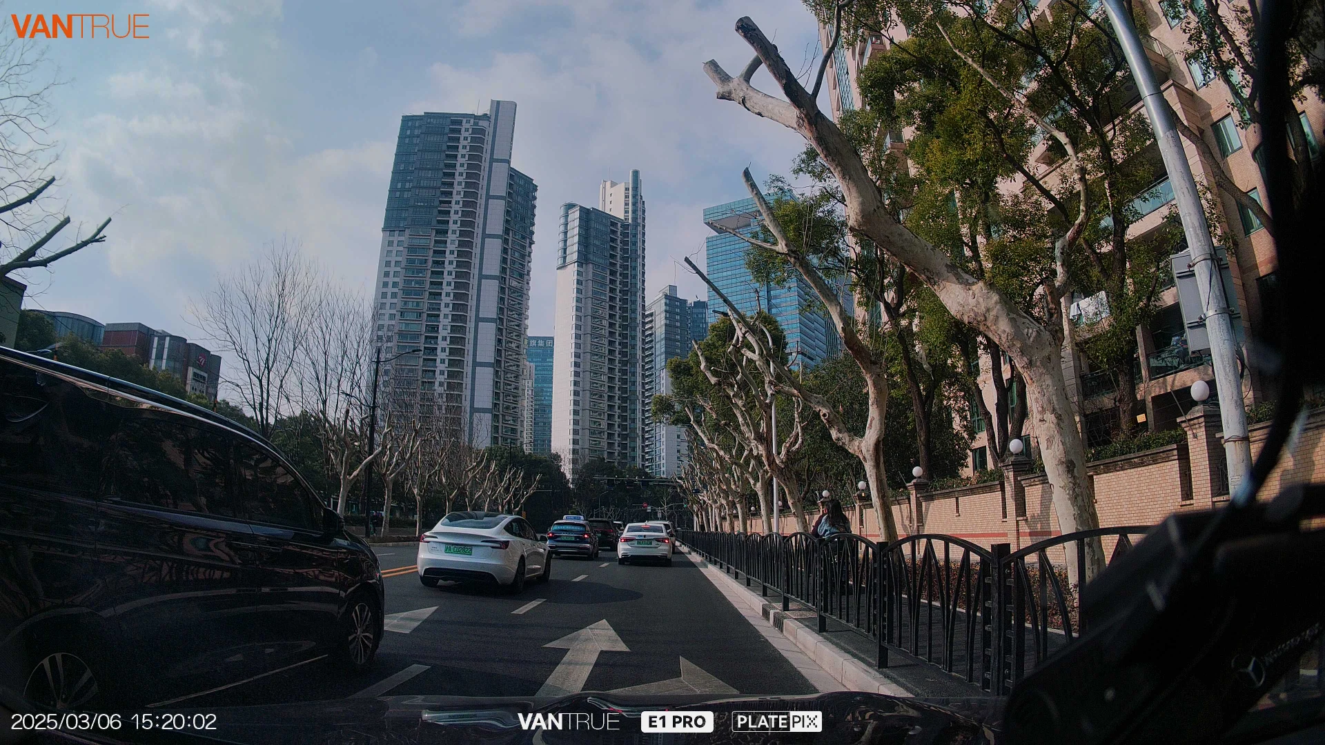

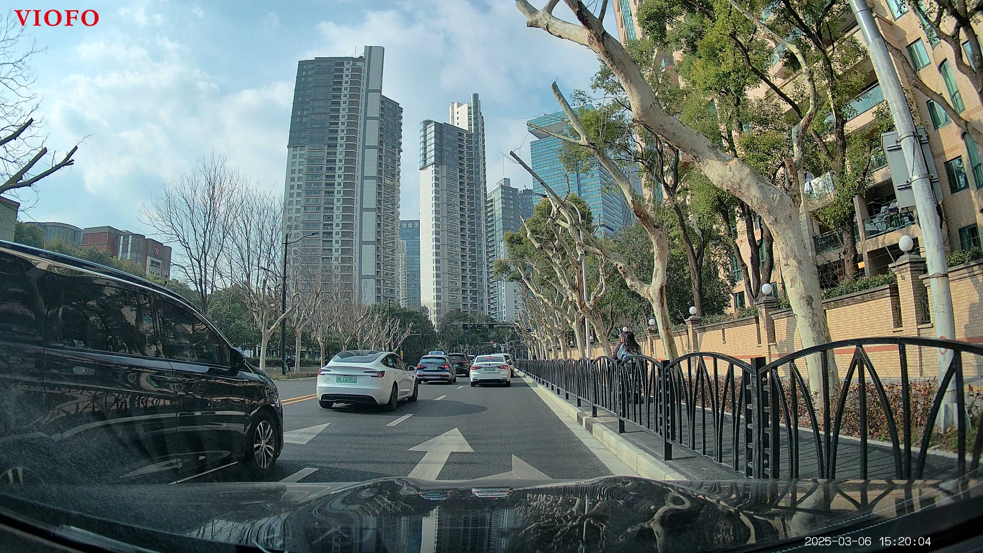

i just buy e1pro today and use it with 229pro together
i think 229pro is more better tha e1po

I agree with @TonyM it's not clear what the indents are for. The picture on the back of the box I think is maybe saying you need to orient it or maybe it's just saying screw it on? In any case I agree the instruction need to be much better.
I see you have PlatePIX turned on, do you also have HDR on for Vantrue? Do both have the CPL filter?

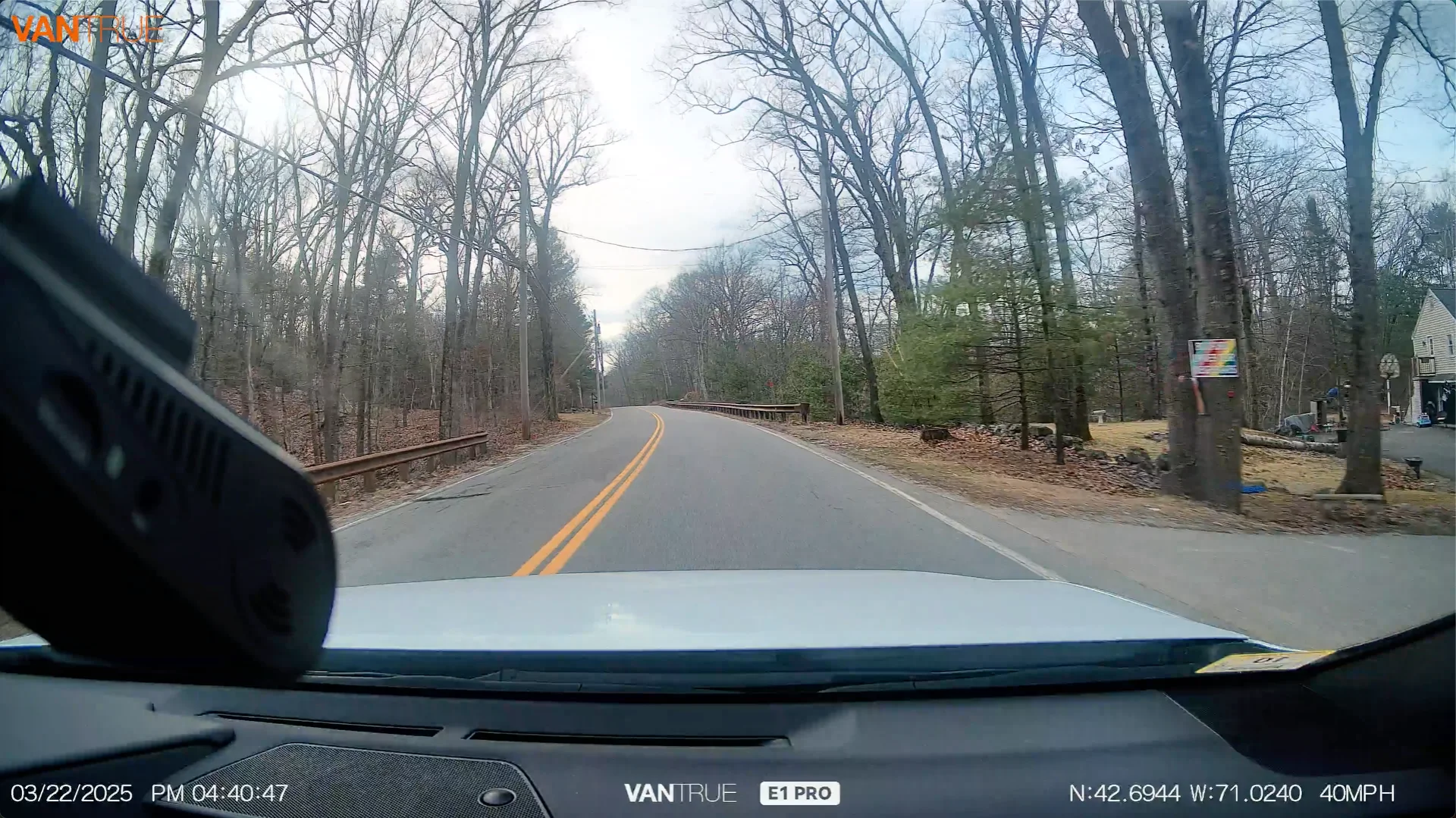

I captured some video traveling 41 mph (66 kmh) in dim lighting/overcast sky.
Take a look at the colored Boxford sign on the right, it's not really legible with the E1 Pro but the A229 Pro looks good.
I may want to do more dim lighting tests. The time stamp is 1 hour too early on the Viofo because I forgot to adjust for DST.
I'm not sure why there is so much difference in the clarity of the sign, other images along the route I viewed are very similar in quality.

The E1 has probably run out of bitrate due to all the tree branches, no bitrate left for the sign.
The colours on the sign probably use extra bitrate, so it may partially be a localised bitrate issue for that sign.
The E1 has also used a slower exposure time, so has more motion blur, but I don't think that is the main issue.
It probably did.
I can notice slight blocking on my dashboard when driving in an area with a lot of trees.

It looks like motion blur to me due to a slower exposure, and possibly HDR blur. Do you have HDR on during the day?
I can see what appears to be HDR double-exposure fringing along the edges of the trees at both sides of the frame on the E1 Pro.
HDR was OFF on both cameras.
Interesting idea that it's a local bitrate issue due to branches and colored sign.
But why would only one camera behave that way?
@Julian23 what is "blocking"?
I will try to get more footage on that route again. I agree it does look like motion blur.

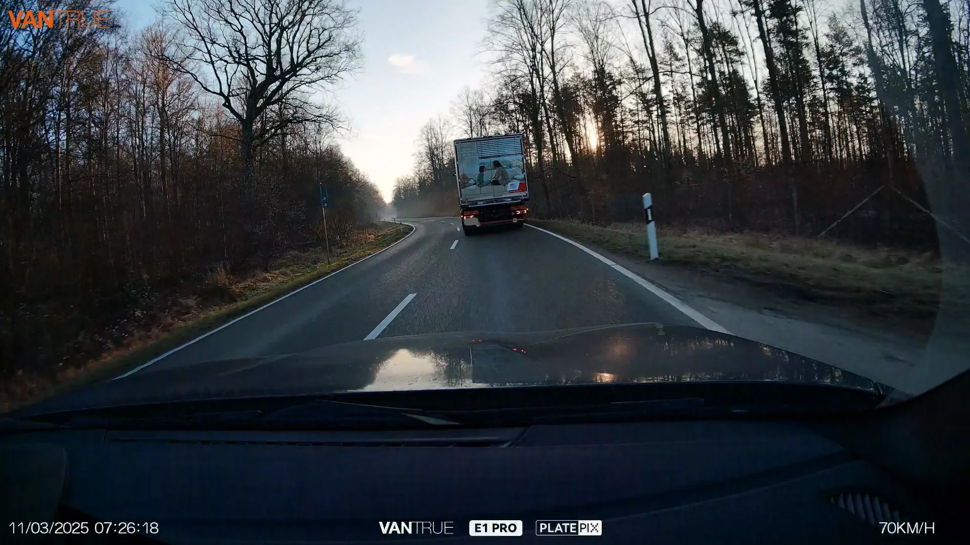

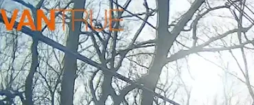

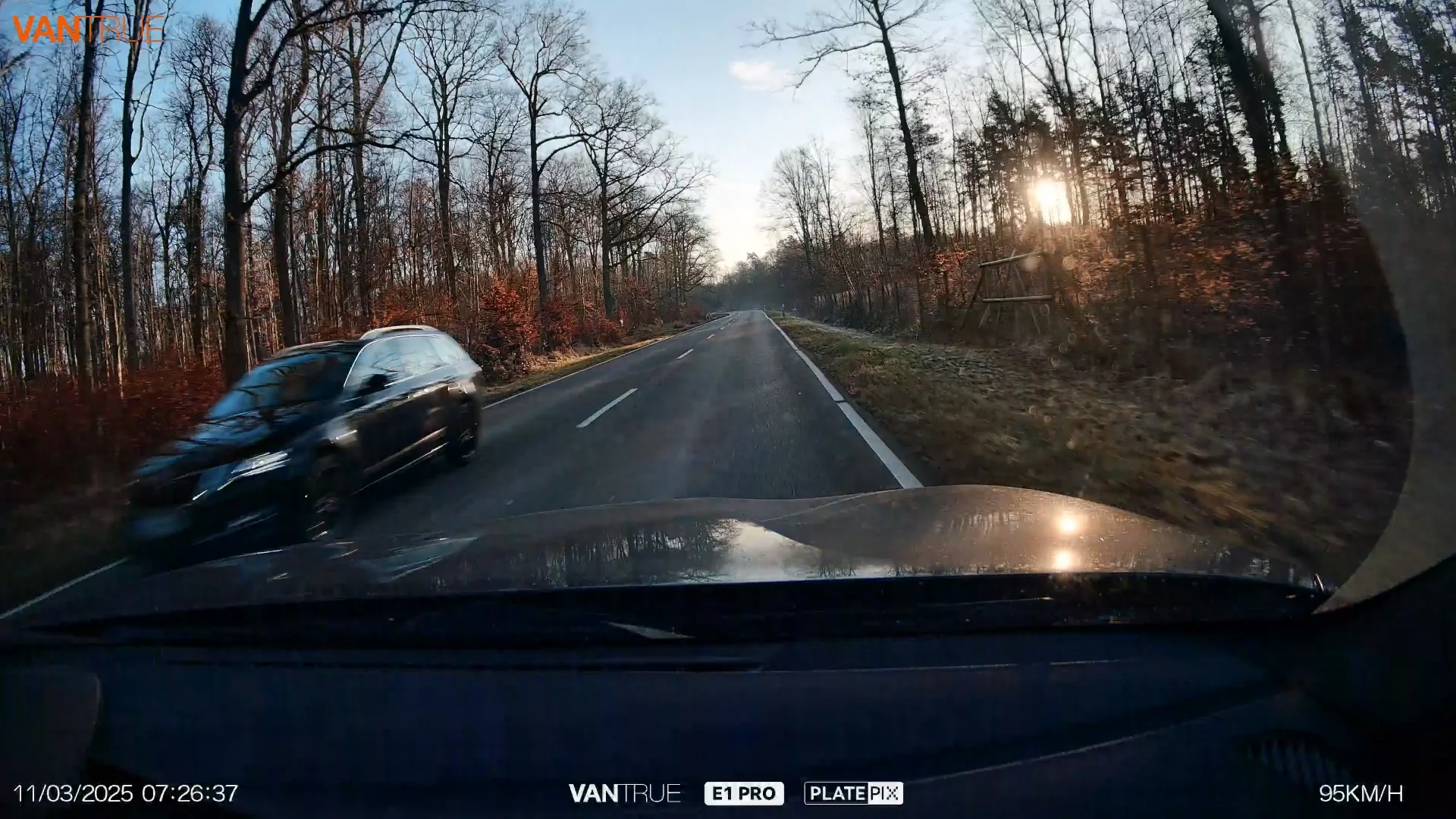

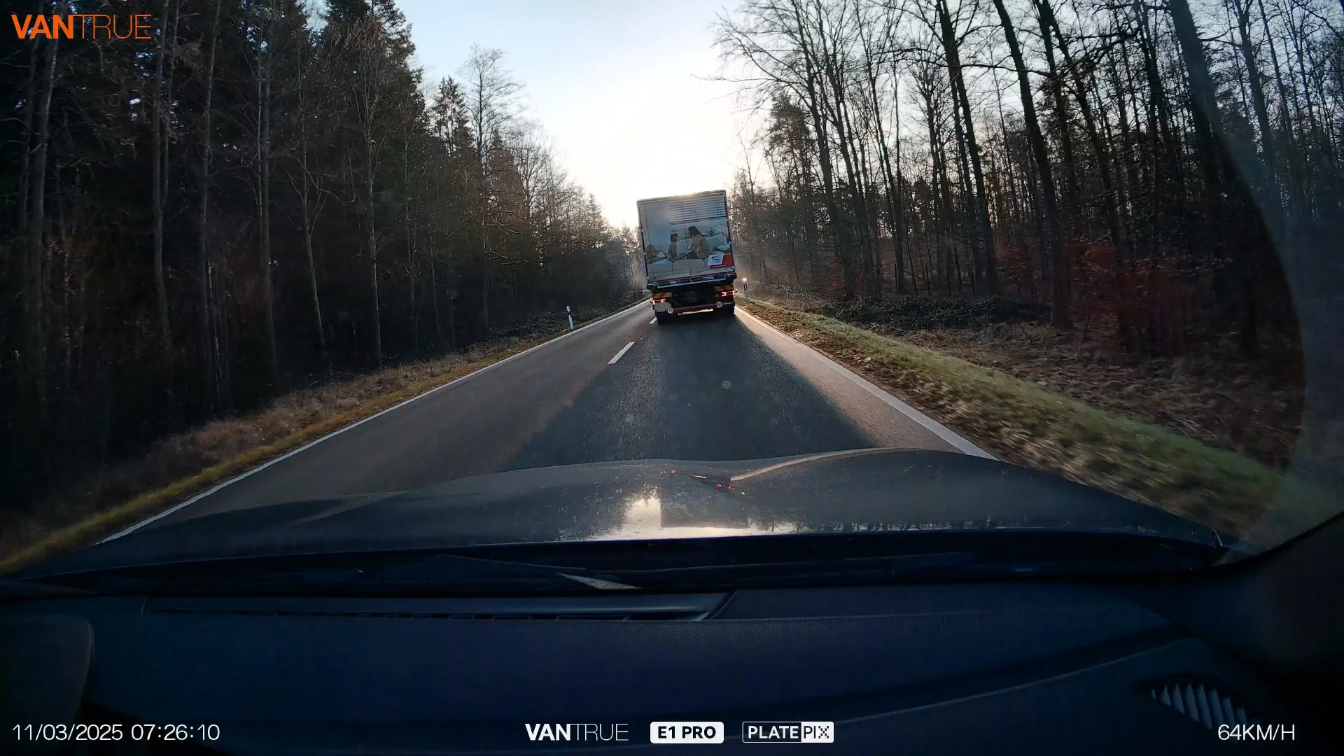

If you take a look at the dashboard you will see what I mean. In this frame it is quite noticeable.
Two more examples:
First image the surface of the dashboard can be seen.
Here it does struggle:

Was HDR set to off via the HDR-Timer or manually?
Because it really looks that HDR might have been active.
I think there might be some kind of bug existing in the HDR-Timer for the E1 Pro.
A partner of us noticed that while doing his review for the E1 Pro (for the N2X as well). I was able to repilcate the error for the N2X (not for the E1 Pro) but I reported it to Vantrue.
They told us it would be prioritised and fixed with the next firmware-update for both models.
(I'm not sure if there really is a bug for the E1 Pro, but If so, for me thats positive because the results might still improve then)
But usually I have to say Vantrue is always very good and fast in bug-fixes from my expericene. 👍
