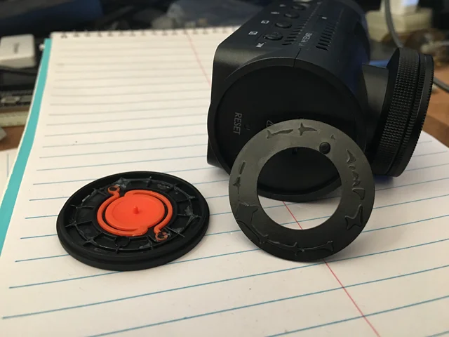

To end my day of testing fun, I went to install the microSD card into the N5 and the plastic door/button cap fell of the magnetic ring that holds it to the side of the N5.
Same thing happened, but with the N4 Pro. The adhesive mount fell when it was sticked to the film provided; now I removed the film - hoping it'll stay on.. but might have to redo the adhesive with a new one or alternatives.
To end my day of testing fun, I went to install the microSD card into the N5 and the plastic door/button cap fell off the magnetic ring that holds it to the side of the N5.
On N5 fell off after 2 hours of work on the table. On the N4 Pro, the cover lasted 10 days in the car at high temperatures.
Perhaps because the N4 Pro heats up less.
We did realize the issue of the SD Card cover on the N4 Pro and N5, and there are two ways to solve this problem. It can be fixed by using glue, or we can send you a new card cover. We will improve this design in the following production.

Thanks for the videos. I've attempted the "glue" fix. I'll test it out this week.
Operation video for reference:
I guess it all depends on the glue. I pasted on N5 a week ago. As long as it keeps.
But we don't have heat. I glued it on N4 Pro only yesterday.
My cover still stick just fine.
And the N5 are chugging along just fine, nothing have jumped out at me the few times i have retrieved the memory card to look at the end result footage.
I will be logging a few KM on Friday and Saturday and will take a look at the memory card again when i get home
If something need gluing here i have a few options, ranging from my trusty shoe goo to CA glue.
