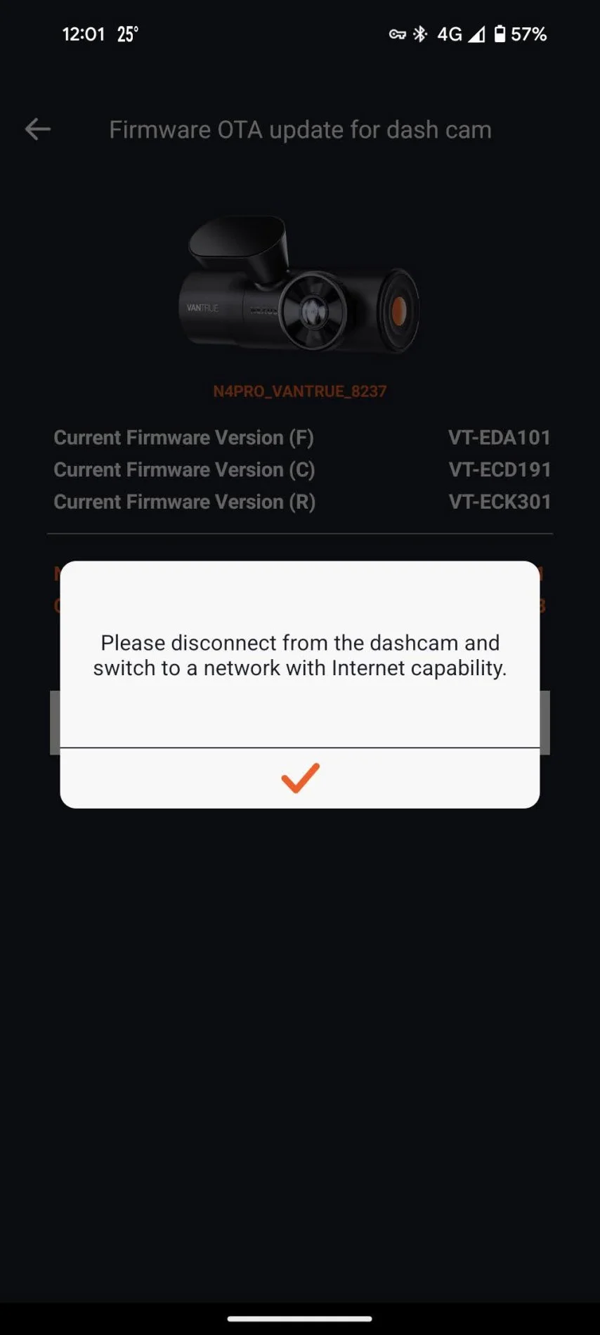

Anyone seen this when trying to update? I was in a loop - ticking the message got the app re-downloading the update each time and then throwing up the message again. It was doing this all on 4G so was connected to the Internet and not to the dashcam. Problem resolved itself when I connected to Wifi on home network. I can only think that the message meant something else and has been miss-translated?? Or the app just got confused - though I did try force closing it.

No sorry, updated this afternoon OTA via WiFi and all went smoothly .
I got the update for my N5 looking at the APP in front of my computer, then DL it, and pushed that to the camera the day after when i went on a drive.
What you have tried @wibbly i have also experienced in the car, but i think it would work if you turned off the camera wifi while you DL the new update.

But wibbly seemed to have a update alright just not able to get it onto the camera / DL it in the first place, and i had that happen too in the car, but looking away from the camera ( i assume via mobile data as i dont like to run WIFI in my apartment )
I assume it would work in the car if you turn off the camera wifi, so it is not there to trip up things.
IMO wifi is strange in phones, why do i have to get the " there is no internet access on this wifi " when i connect to a dashcam, i bloody know, i assume just a precaution Google and Apple have to make sure they can milk their slaves data, so the phone wifi will always put internet access over anything else.
