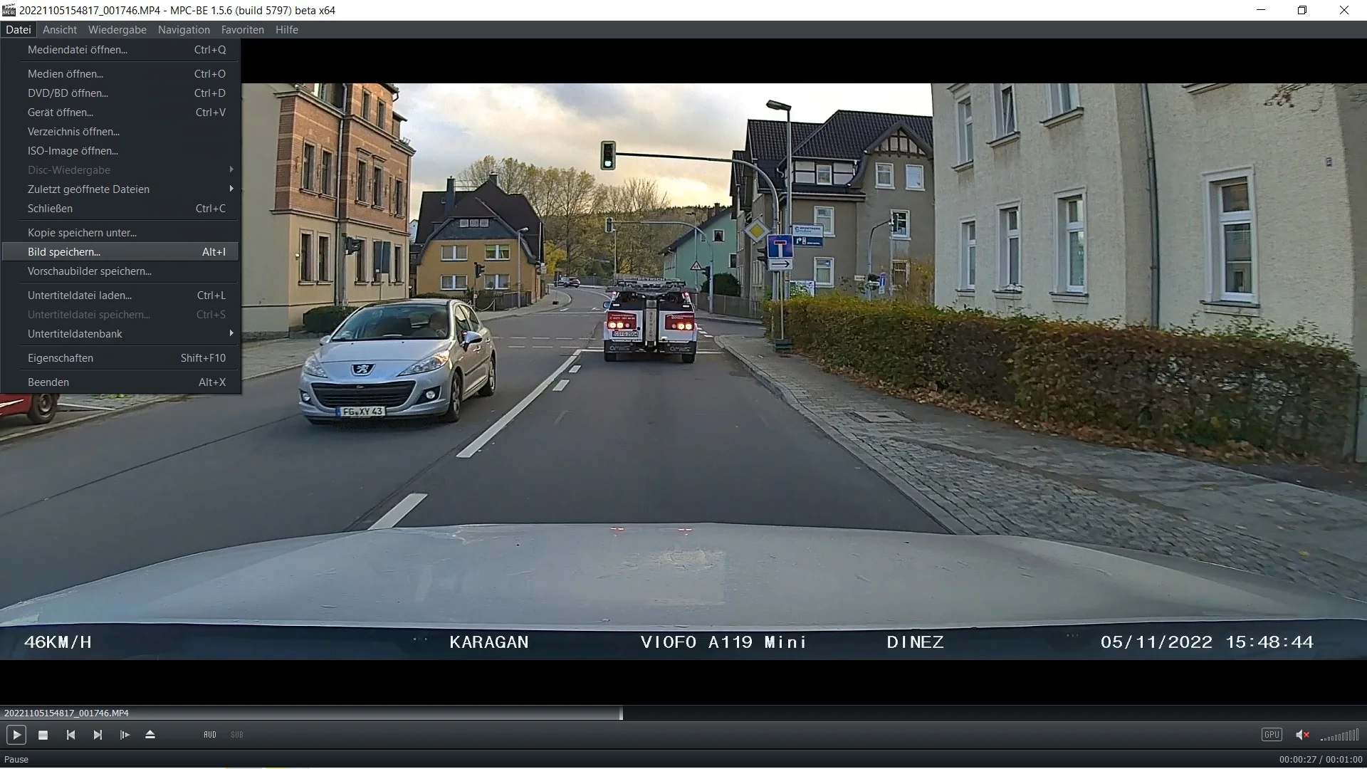

Which method/program do you use to zoom into the number plate?
In MPC-BE press numpad 9 for zoom in. Press 4 or 8 or 2 or 6 to move the zoomed area. Pressing 5 will reset the zoom.
When you have on the screen the desired zoomed area you can take a screenshot.
To take a snapshot of original frame press Alt+i in MPC-BE and save as PNG.

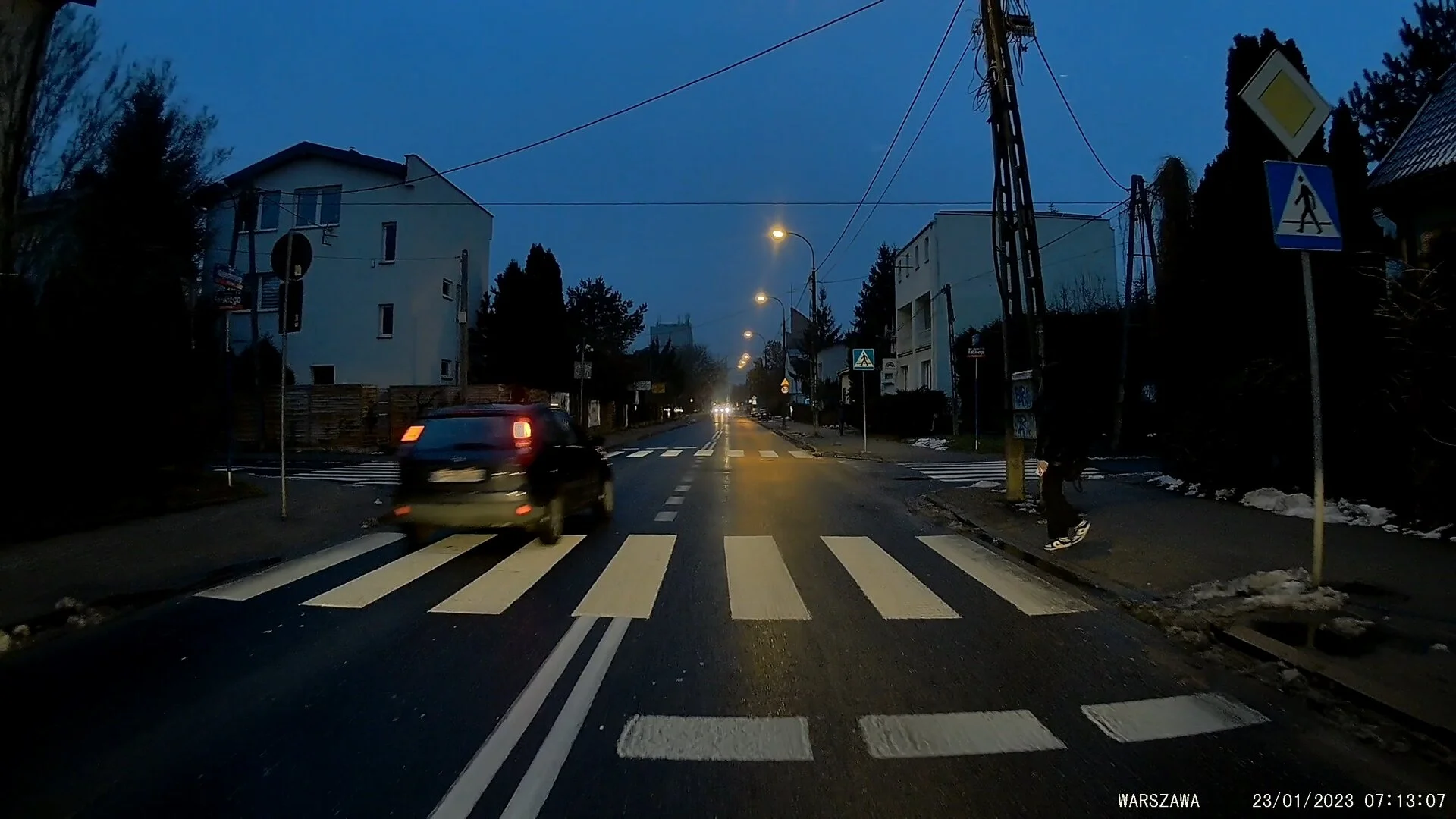

What firmware and what settings do you suggest for A119A for driving at night?
I need good visibility of license plates.

The latter on the official website shoots no worse.
What software are you using to freeze the frames?
That's just motion blur as the camera is using a slower shutter speed to compensate for the low light conditions. Unfortunately, that is about what you can expect under the circumstances. Notice that everything else in the image that is not moving is perfectly clear and sharply delineated. Some firmware will perform better than others but there is a limit to what you can achieve under darker lighting. In bright sunshine the same image would be sharp.
I thought I had bad firmware.
I understand that other settings in this situation will not help?

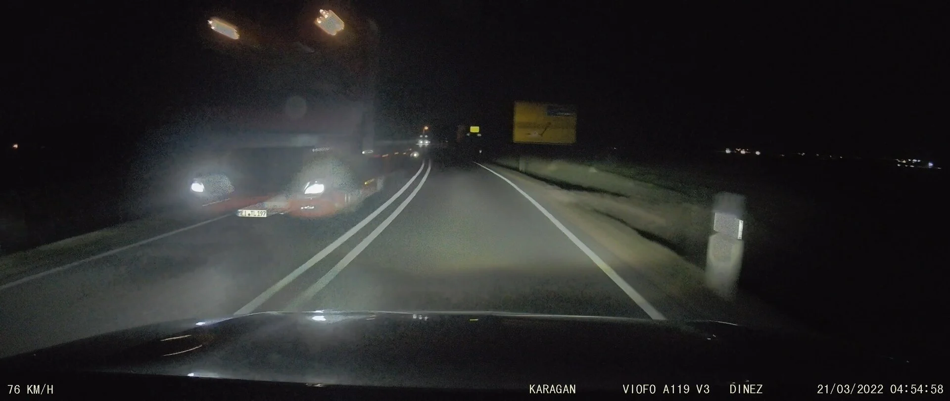

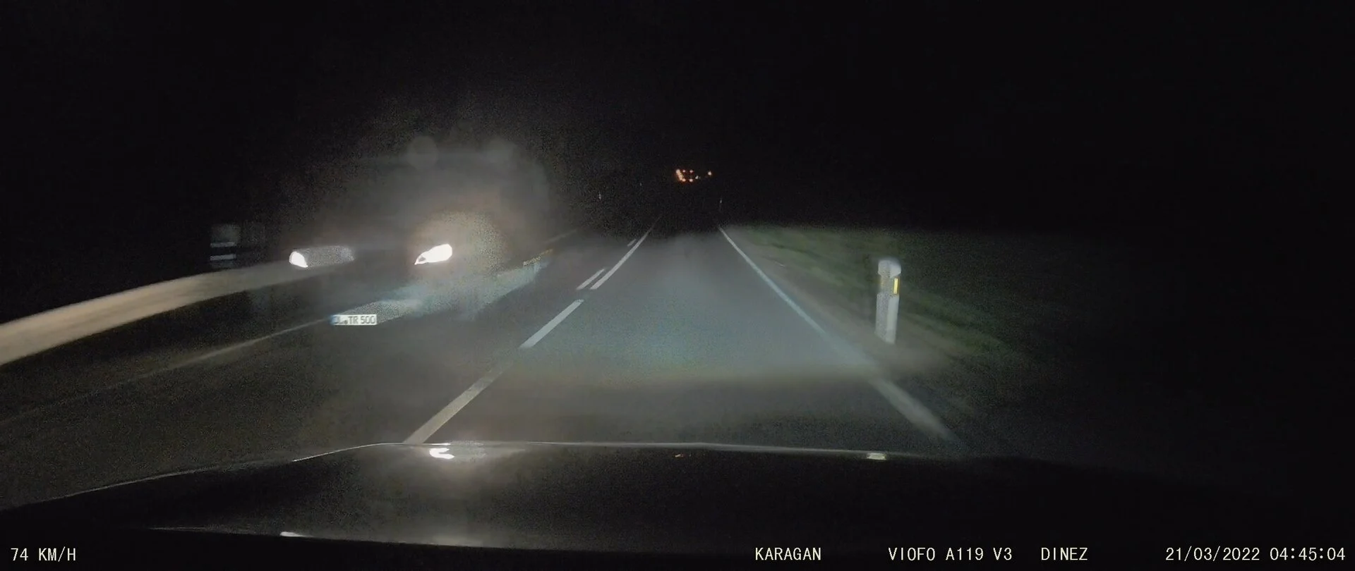

It turned out that I have the firmware you suggested. The settings are the same.
But the videos are of poor quality. What could be the cause?
View attachment 63816View attachment 63817
Your video is of normal quality, except for reading numbers. In such a situation, it will not be possible to see the license plates on a black car,
but on a red car, with HDR turned on, the numbers should be readable.
  • Like
Reactions: gse
This is true but it wouldn't be the case for anyone from a country with smaller plates such as the USA, Canada, Mexico and most of Central or South America. It would be nice if the camera could do it.
