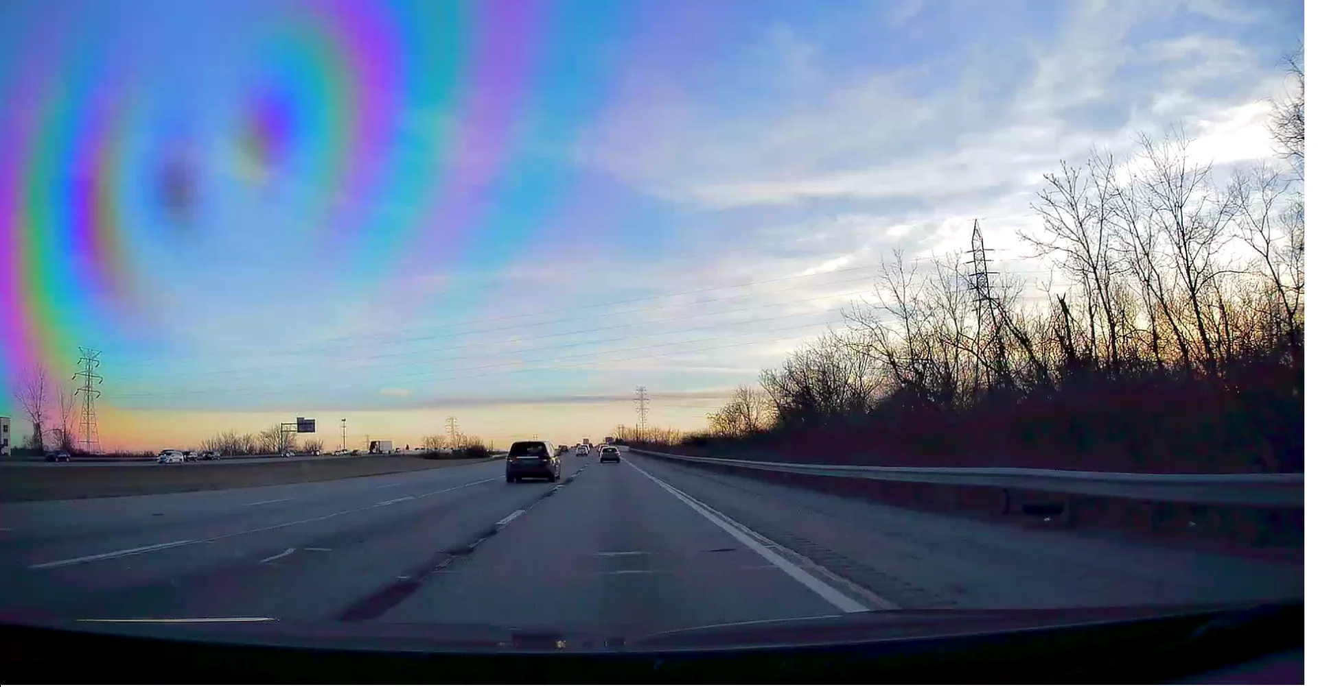

Ok so I need to pick your brain a little bit. Sorry, as I'm new to Viofo Brand. Please bear with me.
1. So I was reviewing some of the video from my A129 Duo (Front + Rear). I noticed a Halo Effect on the Front Camera caused by the CFL Filter in daylight / dusk situation. See attached image. Is it normal to have said "Halo" effect from said CFL Filter in daylight / dusk?
Note: I also have WDR enabled along with the CFL filter. Do I need to DISABLE WDR? Also, my front windshield has 80% tint on it, too. (Decreases sunlight 20%)

Did you remove both of the protective plastic films from the CPL? There is one on both sides of the CPL. Is the effect there without the CPL?

Plastic removed on both sides of CFL. Will try to cruise around without the Filter and see. Pretty certain the halo is from the CFL. Which is why I wonder if I need to turn off WDR. Maybe WDR is trying to compensate for lighting changes and the CFL is overkill with both features working in unison.
My window has tint on it..but doubt that would be the deciding factor. Will report back later as I'll do a drive without CFL and check to see if halo is gone.
I looked at other videos and the Halo wasn't there the entire time. You can definitely see colors from the lighting, which again I think is the CFL filter. Gray outside so don't think I'll get a good test of CFL vs no CFL. Really need to see if disabling WDR with CFL takes away that Halo.

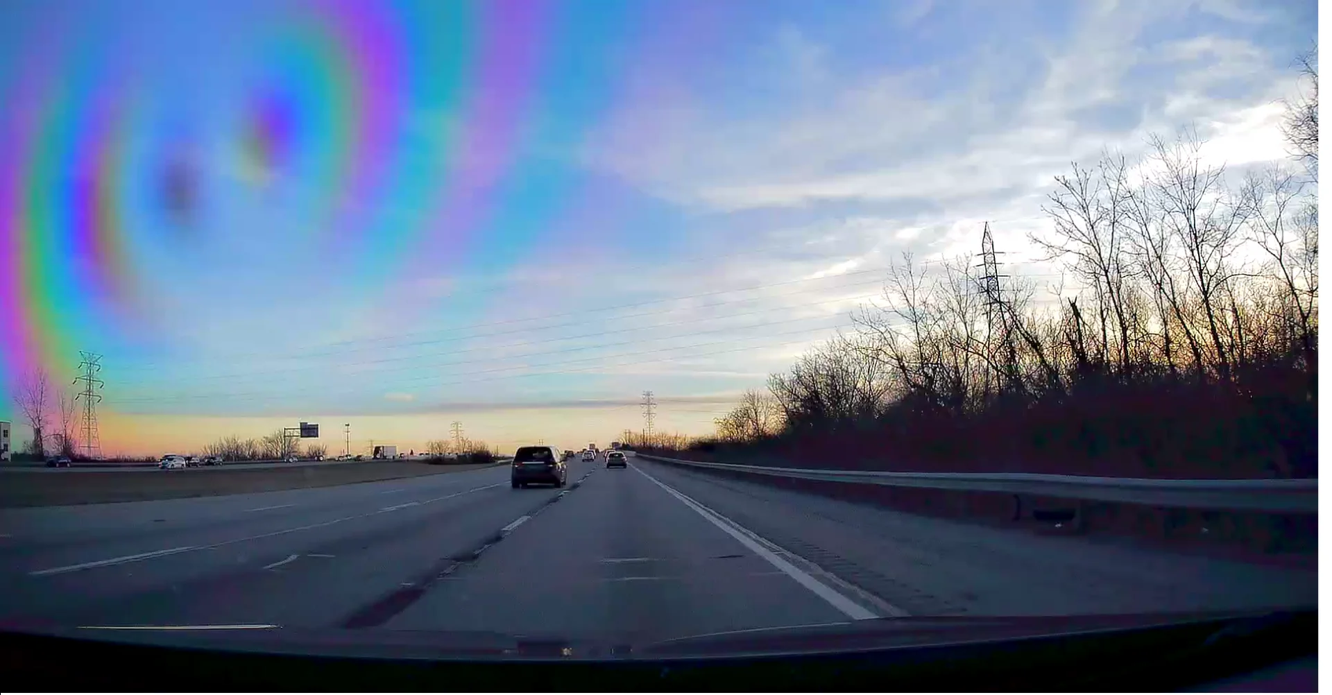

The rainbows you are seeing in your windshield is a phenomenon in physics called birefringence. Birefringence is a double refraction caused by the interaction between the tint on your windscreen which is polarizing the light in combination with the CPL which is also polarizing the light, so it's like having two polarizers which is not good. (See also) You will likely notice the same thing if you wear polarized sunglasses and look through your windscreen. With your particular windshield glass you may not be able to avoid this problem if using a CPL.
See this article for a more comprehensive explanation: https://www.revantoptics.com/blog/why-youre-seeing-rainbows-in-car-windows/
You can obtain excellent results eliminating windshield reflections from your dash cam by installing a good dash mat instead of a CPL. There are a few good threads about that here on DCT. HERE is an example of one in use (with no CPL) and a photo of a dash mat further down in the same thread. There are other DCT threads specifically dedicated to dash mats.
  1. So will removing the CFL filter solve the issue? Or will I always have some polarization due to the tint?
  2. What about WDR? Recommend on or Off with Tint? What about CFL? Will disabling WDR correct the birefringence at all?
WDR won't change anything, either remove the CPL filter, or remove the tint, the tint and the filter together is the issue, the CPL is only about taming reflections from the dash, see if you even have that issue before going any further
Thanks. Will do. I believe you are correct that it's the CFL filter. I'll take it off and see what happens. I know when I placed CFL on my rear camera as a test, I got that same halo affect most likely due to tint. So pretty certain the same problem exists with tint + CFL on front camera. Rear tint is much darker at 20% (blocks 80% light). Front is 80% blocks 20% light.
Yes, removing the CPL, as @jokiin has already explained should eliminate the rainbow effect. My post was very clear on that, as were the links I provided. No, WDR will not correct the rainbows. WDR has nothing whatsoever to do with this problem.
The tint is entirely the culprit in your front windshield which is made from laminated safety glass. Your rear windows and side windows are made from tempered glass which is a different kettle of fish which causes its own set of birefringence issues such as patterns in the glass (and rainbows) when seen through a polarizer (and or tint).
It sounds from your remarks as if you haven't read the article I linked to, or maybe you didn't read it carefully. If you take the time to do that you'll understand this issue better.
I see that for some odd reason you linked to a dead, parked domain up for sale - birefringence.com rather than any of the links I provided. Maybe that's the reason for your confusion about this? As suggested, try the links embedded in my earlier post. πŸ™‚

My advice for your image quality issues :
  • load MOD-4Uj for 130 FOV or 4Uk for 140 FOV Lens, both increase Bitrate higher than stock FW.
  • if the rear window is also tinted glass suggest using 6Uj and ignore rear camera quality.
  • leave WDR off to reduce motion blur but lower Lens angle slightly to increase road brightness.
  • to reduce that colorful circular wave pattern on tinted windshield remove Circular Polarizing Lens Filter , if significantly reduced without CPL consider slightly rotating CPL glass 1mm either way as a test (probably won't help).
  • all tinted windows cause image quality issues , to compensate for darkened image remove CPL, aim camera lower and order 140 FOV uncoated brighter Lens, many enable WDR for dark rear tinted windows.
Don't expect perfect video when tinted windshield reduces brightness degrading image quality from any Dash Cam especially at night.
My rear window is tinted and videos from rear cam are dark and grainy. I just ordered a CPL for the rear because night videos are really 'washed out' by car's headlights. Is it not a good idea to put a CPL on the rear cam?

Circular Polarizing Lens Filter darken the image slightly but worth it if you want less dash reflection in the recorded video. Owners wanting the maximum brightness for accident evidence and don't collect footage for other uses prefer zero CPL. Other Dash Cam brands don't even support CPL Filters marketing instead for brighter image. I always recommend using CPL for more realistic scene unless you have tinted windshield. My A129 Duo has CPL Filters on both Front and Rear cameras to reduce the horrible horizontal plastic surface reflections. Order the new Larger CPL Filter for 140 FOV Lens but also for any future unannounced wider angle Lens, it works perfectly on narrower 130 FOV Lens.
CPL is cheap, order it for both cameras, its most noticeable effect is on bright sunny days with sun shining from side to reduce/eliminate horizontal surface reflections in recorded video. It does help with rear view headlight glare but not as much as you'd like. I suppose its time for a CPL on/off video.
