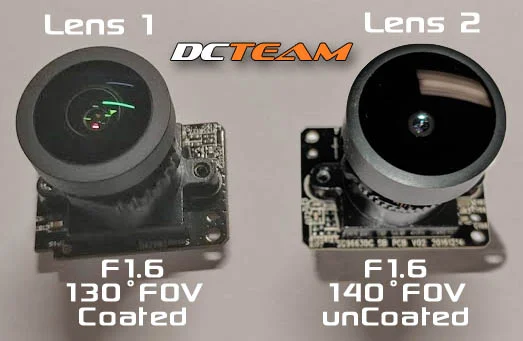

I created this Lens comparison graphic for easier Lens identification.

Ignore the Lens specs on box, look at the Lens graphic I posted above to correctly identify the Lens shape, or post a photo here of your Lens.

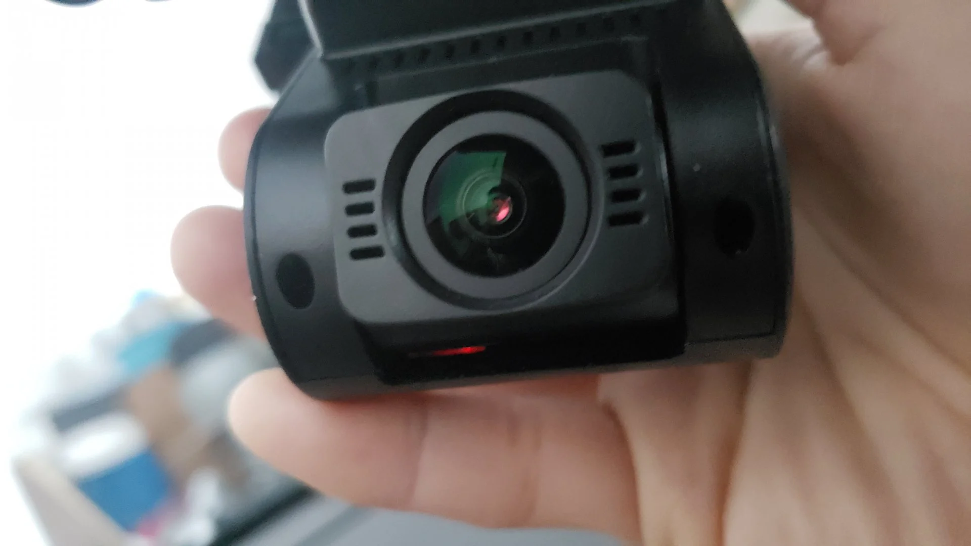

Looks like the faulty first camera and the replacement camera I received are the 130 FOV. The replacement Viofo is in the new packaging and the "2019" model on Amazon...but apparently not the different lens.
So which camera is better? 130 FOV or 140 FOV... See my image of camera.

Look at the picture comparison of the two lenses BCHobbyist linked. You have lens 1, which is the newer lens.
The A129 and A119S will only be sold retail with the newer narrower coated 130 FOV Lens once all old 140 FOV Lens stock is sold out so there won't be any choice or question which is better. In my opinion the original wide angle 140 FOV Lens was a mistake which required precise Focus adjustment, wasn't Beta Tested enough, sold too early and required a larger CPL Filter which wasn't available but A129 was sold to the public anyway with many complaints of soft center Focus and vignetting with original CPL Filter. Changing the problematic Lens was necessary.

Well then I am happy to say I have the 130 FOV as reported in my post above. Was downtrodden thinking the 140 FOV was better, but guess not. That being said, I am testing Stock Firmware + WDR ON and CFL removed from Front Camera.
What is the best firmware for the 130 FOV? The Modified FW 4Uj seems to be a good balance? 24 mbps front and 20 rear. Not really compromising a huge amount from rear but giving the front a sizeable boost?
