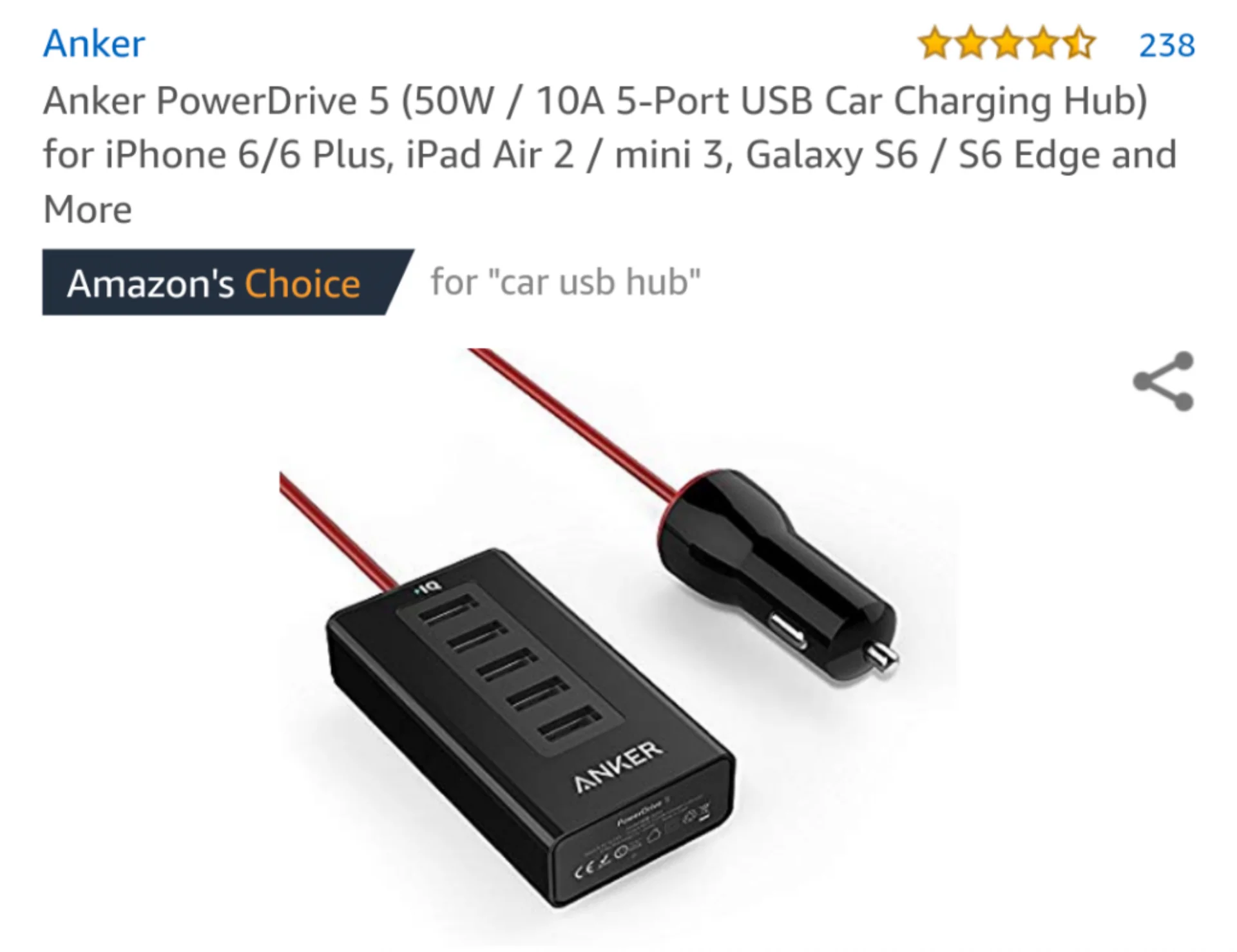

I've been using this 10A 5-port USB supply for nearly all my dashcam testing over the past two years, including 9 months with the A129.
44791
It's been very reliable, however I will swap the A129 to a Viofo charger to see if that fixes the problem.
The fact that it starts recording when I first start the car in the morning, but not when I start the car again a few minutes later is confusing.

I honestly think the power draw might be too great on your 12 Volt Cigarette / Power outlet. Presumably there's a 15 Amp fuse and you are instantly trying to power 3 cameras from it. If this is the only one in your vehicle, and you don't want to hardwire, try setting the delay from 5 second ---- > 10 or higher. Give other devices chance to power up before the Viofo.
unplug the other cameras can test that
Yes and no. He can unplug other cameras, and leave in the Viofo, to see if the issue is revolved. If the issue is resolved, then his solution is to either move other cameras to another 12V socket on a different fuse or to do as I suggested. Set the Power delay to 10s or longer and see if that gives enough time for other cameras to boot, before Viofo turns on.

Obviously you are an expert on these things, what would you think of him chopping that cigar lighter plug off the end of the cable, crimping on a fuse tap and hardwiring it that way? Would it solve all his problems?
That would be almost identical to what I have in my car, currently powering two dual and 1 single dashcam, except mine is Orico not Anker.
Never said I was an expert...I had a Mechanic go through hardwire and testing process with me. And what he did made sense. Doesn't make me an expert by any means...But I'm happy to try and help if there's a question.
Why would you want to splice the wire and hook on a fuse tap? Seems you still run the same risk of overloading the circuit so that the devices on the Orico / Anker still do not function properly.....I.E. Running 5 Devices off a 12 V / 15 Amp Circuit...
The problem here appears to be too much of a power draw, causing the cameras to function sporadically.....Not sure what a fuse tap would solve here except protecting the actual circuit on the vehicle from being damaged and any systems running on that circuit...

12V/15A means that 180 watts is available, my 3 cameras use around 8 watts in total, there is no risk of overloading the circuit!

According to Viofo's website....The Amperage from the Viofo alone is 3.1 Amps and the draw is 5vs.......Not sure the power draw on your other cameras...But if it's under the load limit of the fuse, and you have a fuse tap, then your vehicle's systems should be protected if your manage to blow the fuse...

I've done some in-car testing with a USB meter:
The A129 draws <0.2A during boot, then 0.5-0.7A whilst recording
The Mobius 1 draws 0.3-0.45A
The Mobius Maxi (capacitor) draws 0.2-0.5A
The Mobius Maxi (battery) draws 0.25-0.5A
So my peak current draw across all four cameras plugged into the 5-way USB adapter is 2.15A. That's about a fifth of the stated 10A maximum output.
I can switch to using the Viofo adapter, but my cabling is much tidier when they're all in the centre console and it's easier to swap them into the powerbank for ad-hoc parking mode.
All three Mobius cameras have started recording long before the A129 is done booting up.
I have reset the A129 to default (MOD 6Uk) and reformatted the card. If that doesn't fix it, I'll roll back to 7Uj that I was using before I noticed these startup problems.

0.7A max x 5V = 3.5W
Ah so the camera only operates at .7A not 3.1. Confused input for actual draw. Thanks or clarifying. So you are correct that it uses a maximum of 3.5W and by all means .7Amp shouldn't create a problem if there are 15 available.
Jokin said it best. Try the Viofo A129 without other cameras plugged in. If it works, you know either cord or other cameras are issues. If the problem remains, could be the camera itself or the firmware. Of course, starting with another firmware would be best bet.

default power supply, cable and factory firmware is a good starting point
Alternatively, I'm retracing my steps back to something that was stable a month or two ago.
