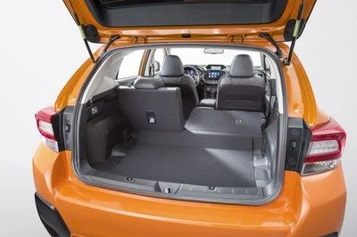

Right. An install on top would be easier but I'm just worried about the side curtain airbags. In the link that I gave above for the floor install, it looks like the 6M cable was "just enough", so no slack and not tight.
I'll have it professionally installed this weekend but I want to be the one instructing them what to do and how to do it. I know I should just be the one doing it but I just have no confidence in myself for cable routing as I'm a new car owner :) I did, however, was able to hook up the hardwire kit already, so no issues there as my course in college is all about electronics, lol.

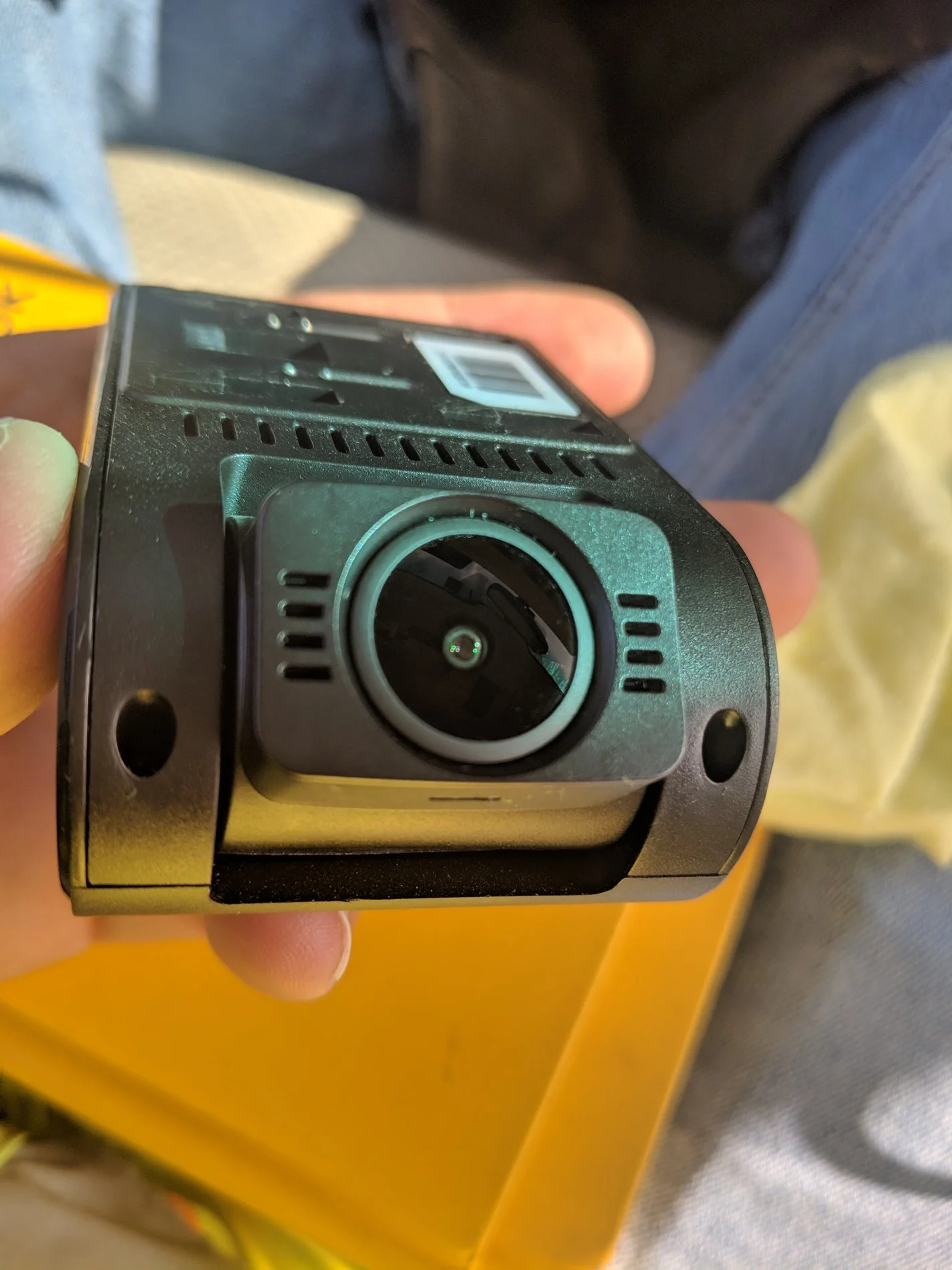

You ordered the Large CPL which is newer and works/fits all VIOFO Dashcams.
I created this Lens comparison graphic for easier Lens identification.
Looks like I've got the uncoated 140 FOV
Ignore the Lens specs on box, look at the Lens graphic I posted above to correctly identify the Lens shape, or post a photo here of your Lens.
4Uk or 6Uk is better for wide angle uncoated Lens sharpness.
So I should remove the CPL from my rear cam because my rear window is tinted?
Now how do I convince CaptureYourAction to replace my cam with the newer 130 FOV Lens? :p
CPL in rear window is useful to reduce glare but will dim brightness more if window is tinted. For heavy tint always remove CPL since it will also increase motion blur especially at night.
Probably a good idea to keep that wide angle Lens, its brighter without the coating so less motion blur at night, just remember to use the large CPL Filter. Many owners prefer it over narrow view and works best with full size windshields.
