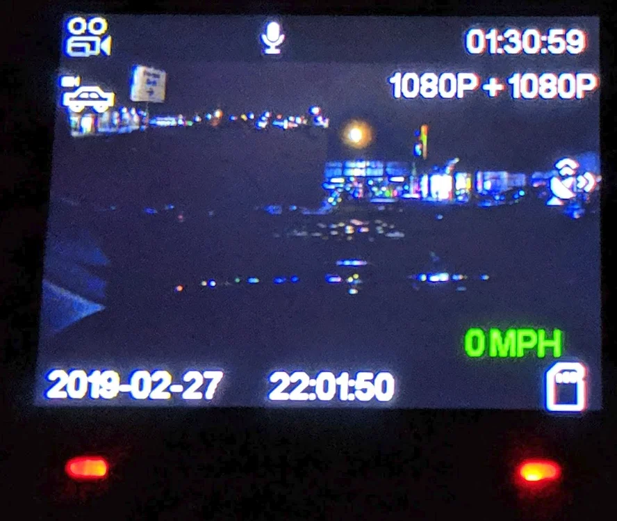

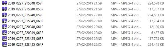

My A129 failed to commence recording last night, which is the first time I've seen such behaviour on this camera.
I parked at 22:00. Plugged in the powerbank at 22:01. It started up OK with the chime and the screen came on. Returned to car at 22:34 to find the screen was still on, but the camera was not recording. I unplugged it from the powerbank and the screen slowly faded to black. The camera resumed recording at 22:35 when I plugged it into the car adapter again. No files were saved between 22:01 and 22:34. No problems found with the recordings prior to or after this issue. The microSD card was reformatted in-camera on 25/02 when I installed MOD-9Uj, and the card is not yet full to commence looping.

I've used that powerbank many times before, including for 2hrs parking just 15min before this occasion, and it still had plenty of power. It's a PD powerbank capable of delivering 5V/3A so more than adequate for the A129.
Ambient temperature around 5degC so don't think that's a factor.

I just plugged the camera into the same powerbank and it started recording OK, so I can't replicate the problem.

Your A129 froze on Parking Mode detection, it's from the code designed to sense voltage from hardwire kit, with no signal it freezes after time out. Can be replicated easily if you select any Parking Mode Time Lapse setting and connect Power Bank to side power port.
