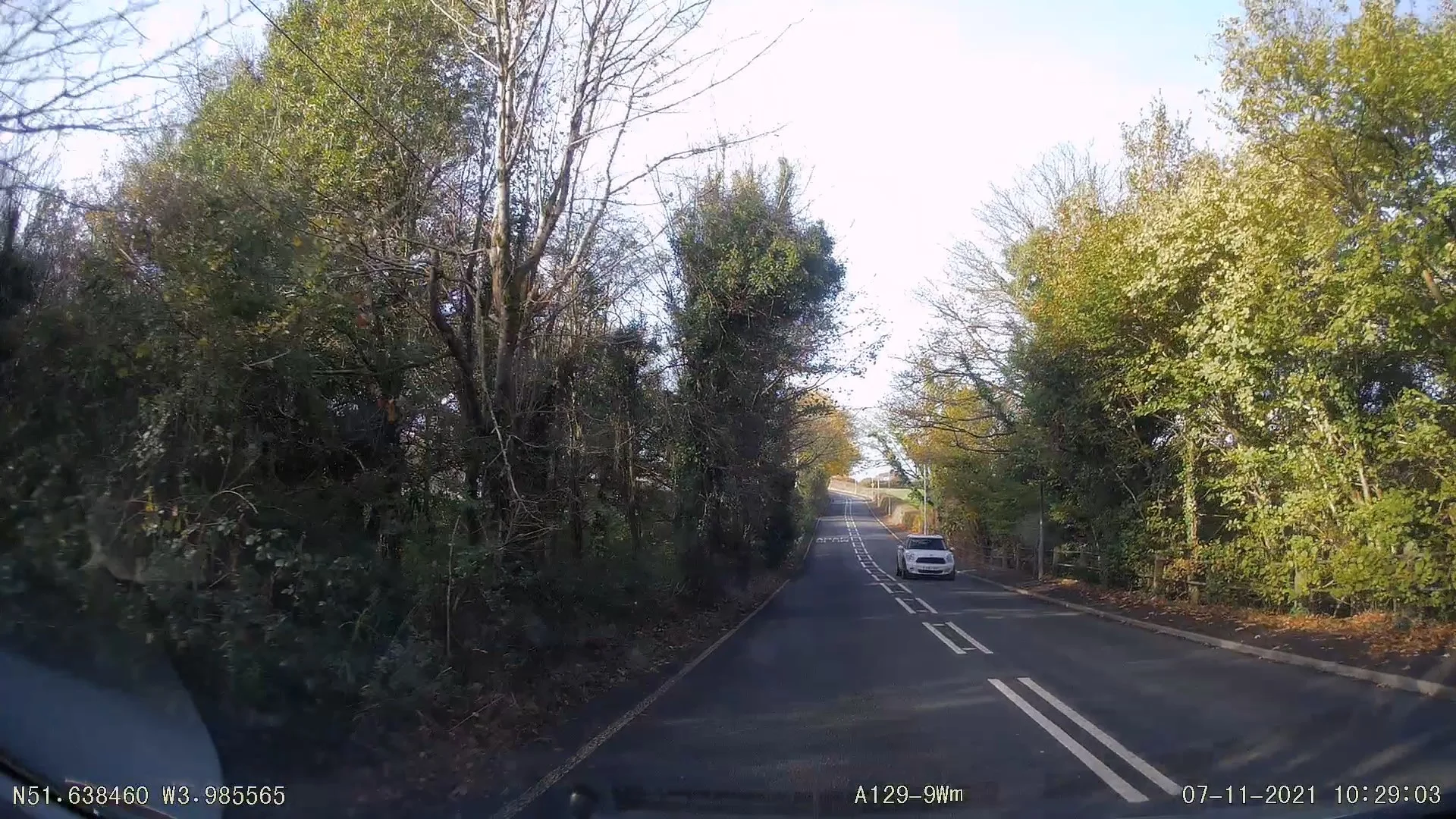

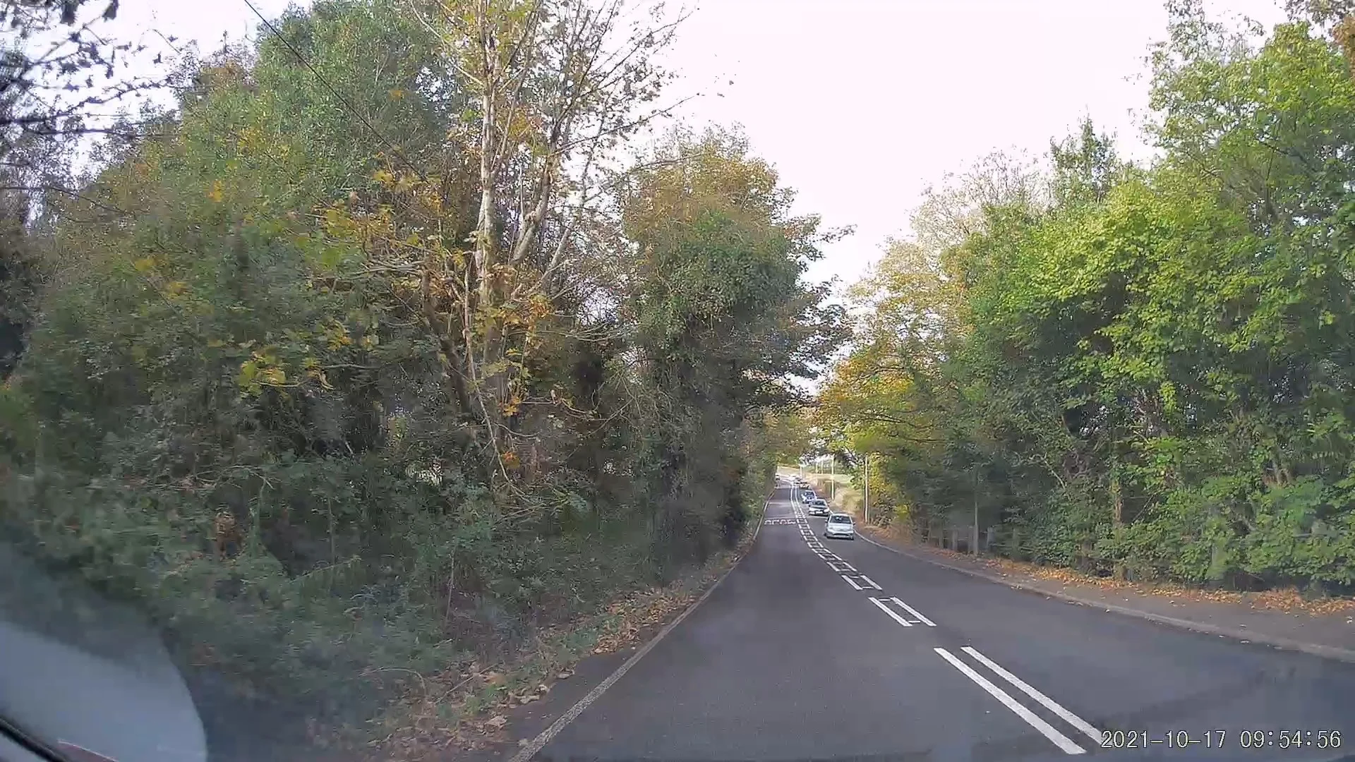

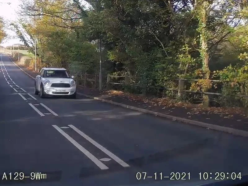

Sure. I'm using FWA129_MOD-9Wm_v1.90+29F+15RMbs+Sharp32+Dice.bin , plus a Sandisk Endurance 256 GB SD card, which gives me a good duration of recording despite the higher bitrate (29 mbps vs 16mbps for the stock FW).
I've tried to match the location to make it as fair as possible, but obviously there's some difference in terms of time of day/sun angle as the clips were filmed a month apart.
Stock FW:
MOD-9Wm FW:

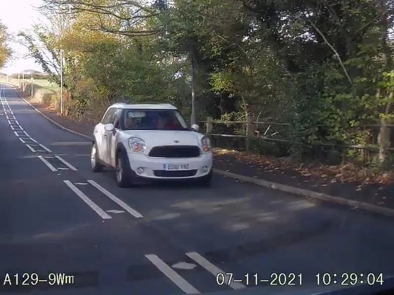

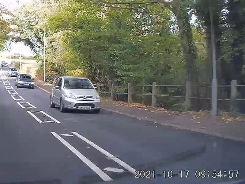

For number plates, I've taken the frame grab as near to each other as possible location wise and have picked the first clearest number plate frame. For the stock firmware, this was the only frame near legible, for the modified firmware there were several frames when the vehicle was closer where the plate could be partially read and so a good guess at the plate could be made.
Stock FW:
MOD-9Wm FW:

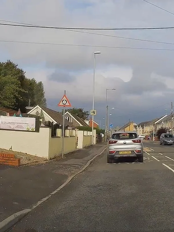

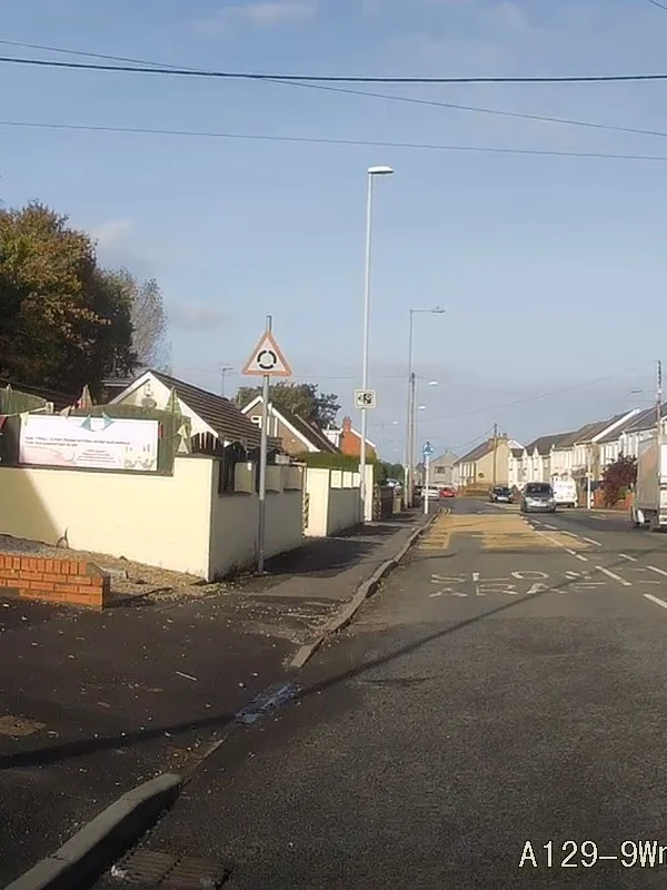

For signs I've again matched the location as closely as possible to the nearest frame
Stock FW left, MOD-9Wm FW right (or below if it wraps):

1. Sorry, I don't use parking mode as I've not got the dashcam hardwired
2. Generally speaking, the much higher bit rate of the mod does make number plates and signs easier to read sooner and make them more clear in the footage I've reviewed.

The vehices do look more detailed and image more clearer on the mod firmware vs. stock. Thanks for the comparison.
