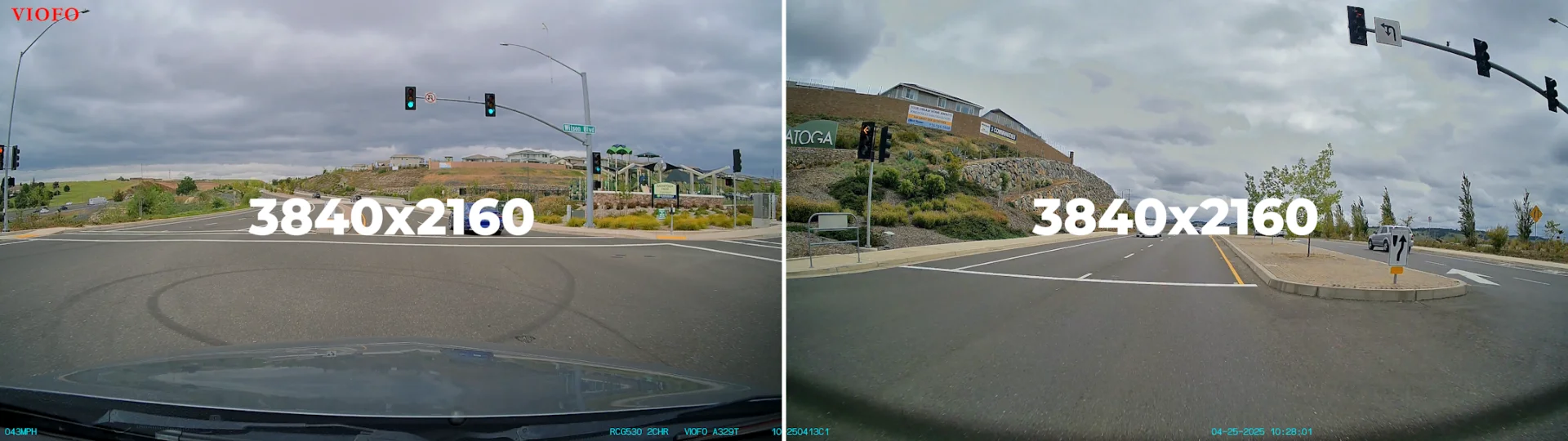

So...is it two 4k videos at 8K size on a monitor, or is it two 8K videos on a monitor?
The first frame grab rcg530 posted is from an 8K width video file, it contains the images from two of the cameras, multiplexed side by side into a single video file. Guarantees synchronisation when watching, and when you transfer/store the file, you will never lose one of the views, no more having to download the front video file to the phone, then having to search for the matching rear, and likely choosing the wrong one for download! Both views are in the same video file.
Are you saying the new A329x does native 8K? If so, that would be a hardware advancement that would put VIOFO much ahead of many other manufacturers.
Or, are the two images being scaled to the 8K dimension?
When multiplexing 2-channels [front+rear or front+interior or telephoto] it creates a 7860x2160 30fps video with the front camera video on the left side and the second channel video on the right side scaled up to 2160p resolution.
Note: I added the white line separators for these screen shots:

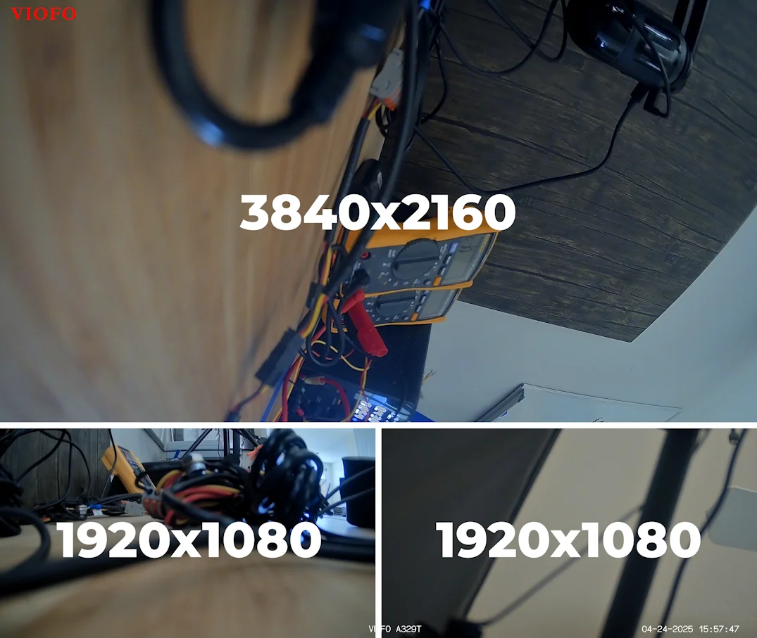

When multiplexing 3-channels [front + rear + interior or telephoto] it creates a 3840x3240 30fps video file with the front camera video on the top of the video and the two other camera feeds in the lower section with a side-by-side placement.

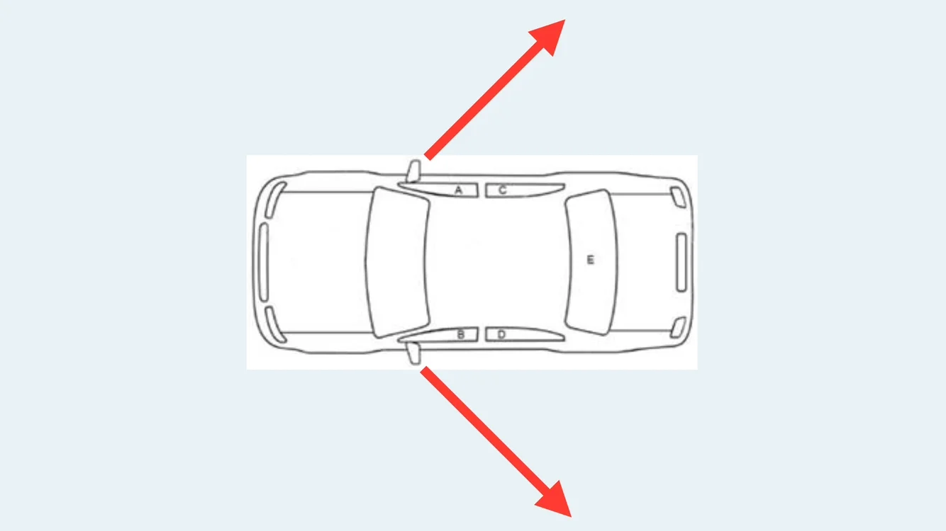

I think it will look really neat to have the 4K Front & 2K Telephoto side by side in the same video like this but better;
Also (2) two left & right side cameras side by side in the same video.

Here is another multiplexed video.
Do not forget that this video is from a beta firmware. Because of this and not only, I unchecked all data about Viofo from the video.
CPL on front and telephoto.
The next firmware will have the rear camera at bottom right.
By the way:
Be prepared for hundreds of no-name dashcams invading the internet and claiming that they are 8K dashcams. This is the worst thing about the great idea of Viofo to multiplex the channels. When ShytCam will see this they will start to sell fake 8K dashcams, upscaling and multiplexing any resolution, any poor image. Average Joe will be doomed.
And the 3CH multiplexed resolution is 6K, not 8K.

The 2nd frame grab that rcg530 posted above is from a 4K video file (3840 pixels width), with reduced resolution for the telephoto, which is not so good.
The multiplexing should be considered different from the viewing, it is about how the video is stored, so the width of the file is not so important.
How the video is viewed is up to the phone/PC app, which should be able to display the 8K Front+Telephoto video on a 4K display at full resolution, but only half of it at a time. To view the whole video at once, it needs to zoom out and not display at full resolution. If you have two 4K monitors on your device then it could put one camera view on each screen at full resolution. A single phone screen is probably too small to be worth displaying Front + Telephoto together, but it can have a button to simply switch views while playing, instead of having to stop playback, go back and open another video file to see the telephoto view, at which point you have lost your position within the file! The new app updates for phone and PC will be interesting...

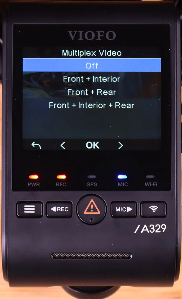

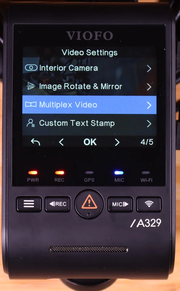

One of the new features for the A329S/A329T is the new multiplexer feature. It allows you to combine the camera feeds into one video file.
From the A329S firmware you'll see this new video setting:
View attachment 79885View attachment 79886

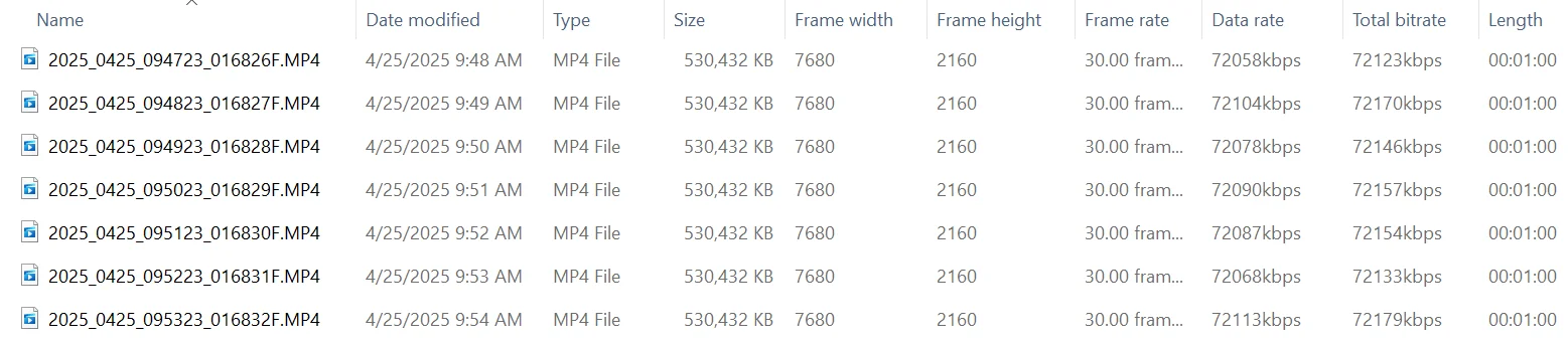

When using the multiplex option to combine 2 or 3 channels into a single video file, does the camera save ONLY the multiplexed video, or does it also save the individual videos from each channel?
It only creates the multiplexed video file as the front (F) video file.
Here's a sample of the first few video files created last Friday. It only created the (F)ront files when I had it configured to multiplex the front+rear videos.
When multiplexing, the end name of the multiplexed file will always contain the F. I asked for M, but the reply was that this is not possible.
On the 3CH version of A329T for example, if you will multiplex front + rear, the resulted file will end with F and the separate file will end with T.

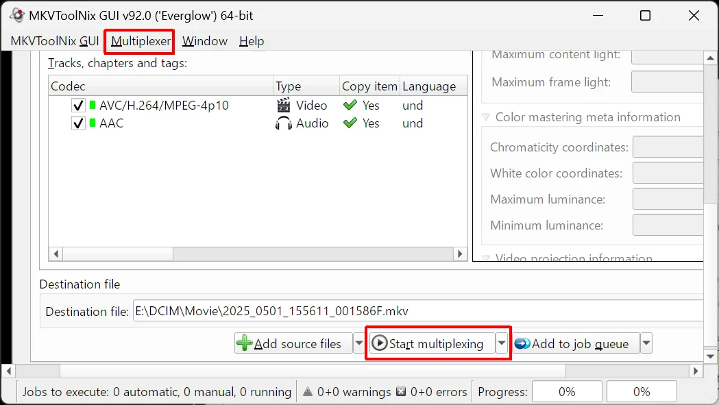

I was looking a little into this problem but even I can multiplex the 3 separate channels in one MKV file, for example, I couldn't find a way to play them as Picture in Picture. All 3 videos are there but I can chose to play only one a time with a PC player like MPC-BE or VLC. There are some discussions about ffmpeg and filtercomplex but I think this is too much to put the user to learn how to use command lines just to watch a video.
By the way, in my little video experience Multiplexing means when you add multiple streams in one container. For example you can create a MKV file with multiple video, audio, subtitles, chapters, etc. All those files are multiplexed in the container named MKV.
Here is a screenshot from MKVToolnix and see the Multiplexing buttons. MKVToolnix it is not encoding the video it is just creating a MKV container with multiple streams, the video and audio is untouched, original quality.
But I accept that the Multiplex name is a good one and I expect that people will understand that multiplexing means combining 2-3 videos in one video and they can not extract any separate channel from the multiplexed video created by the dashcam. You can edit, crop, but not extract.
