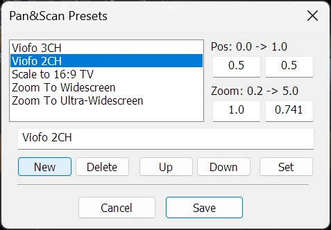

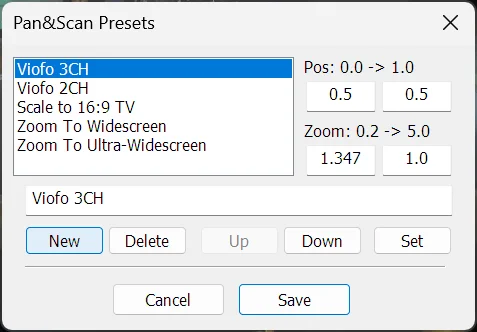

By the way, if you plan to watch 21:9 videos multiplexed as 2CH or 3CH when you will play them on the PC you will need some adjustment to obtain the correct aspect ratio. In the MPC-BE, the settings are showed in these screenshots:
These settings were created by me in MPC-BE at Pan & Scan Presets menu by pressing New, writing those values and then Set and Save.
The above setting is in the Pan & Scan menu of the player by right clicking on the video image.
When editing such a 21:9 Multiplexed footage you will need to correct the aspect ratio in your editing software. I don't know how to do this properly in an editing software, but the resulted 2CH video should have these properties:

As you can see the resolution of 2CH multiplexed video is always 7680x2160 no matter if the original source is 21:9 or 16:9. I don't expect this to be fixed in the firmware. So the advantage of 21:9 Bits/(Pixel*Frame) is lost when multiplexing but remains in separate videos.
In VSDC the only way I found it was to load the video and at the encoder tab I set the new resolution of 7680x1600.
Of course, after doing such correction of the aspect ratio, all data printed on the video will be oblated.
Normally all players should play the video by reading the aspect ratio and displaying the video image properly with the correct aspect ratio but if you want to be on the safe side it is better to reencode it by manually setting the new resolution.
For me, the only way to set the aspect ratio of a MP4 video was to convert it to MKV using MKV Toolnix and put the 4.8 aspect ratio in the settings before saving. Unfortunately, the VSDC editing software and maybe many editing software are not reading the aspect ratio of a video, but only the players are doing this properly.
Normally such an Aspect ratio flag should be also in the MP4 container but I couldn't find the proper tool to embed that flag in an MP4 video. The latest tool I used was YAMB, many years ago but it is outdated. Most of the software found for editing the MP4 header and adding tags, are for the music but not for video aspect ratio. The MP4 standards are allowing forced aspect ratio (display aspect ratio).

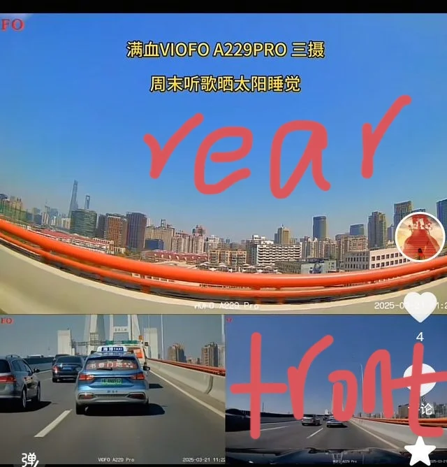

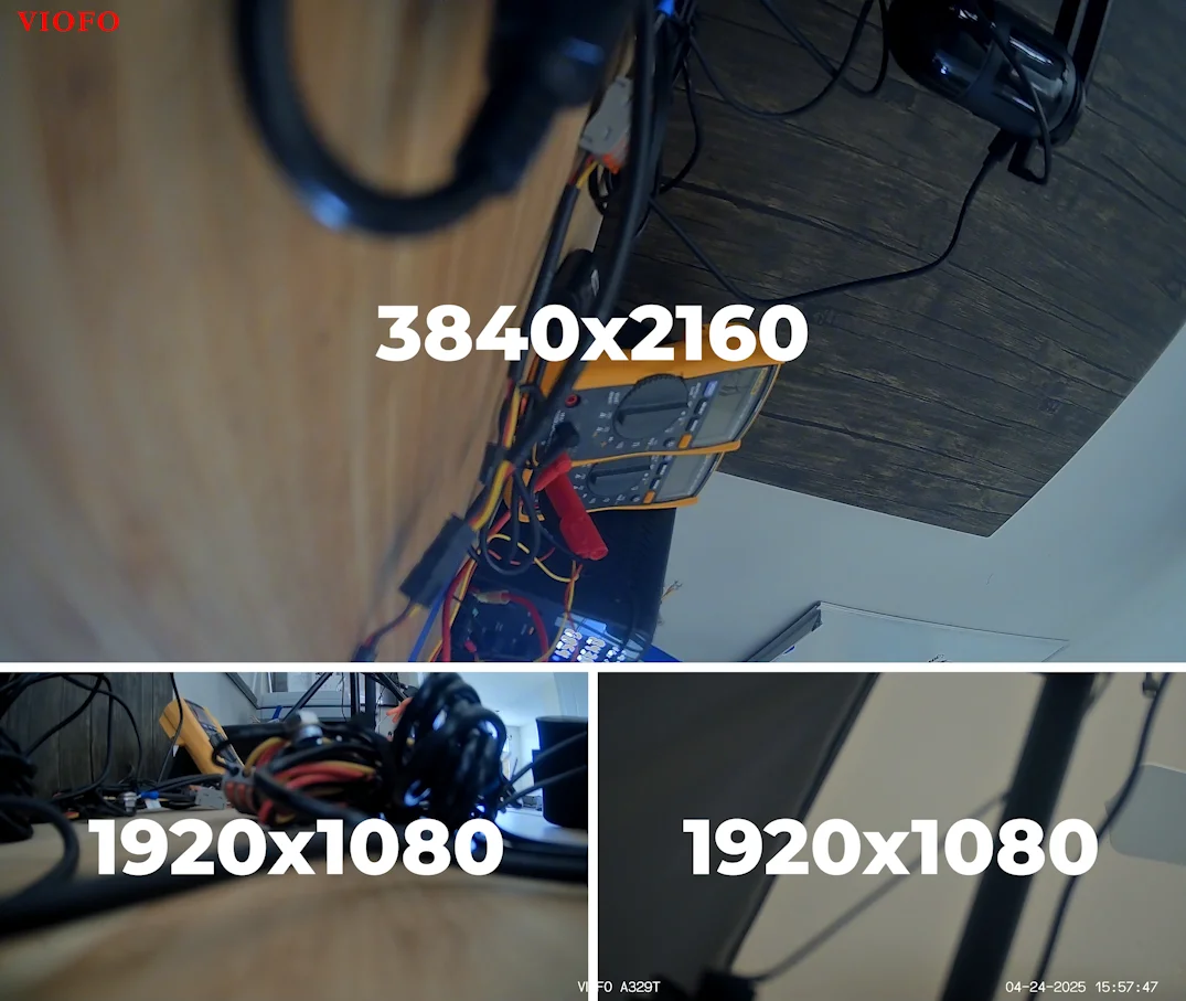

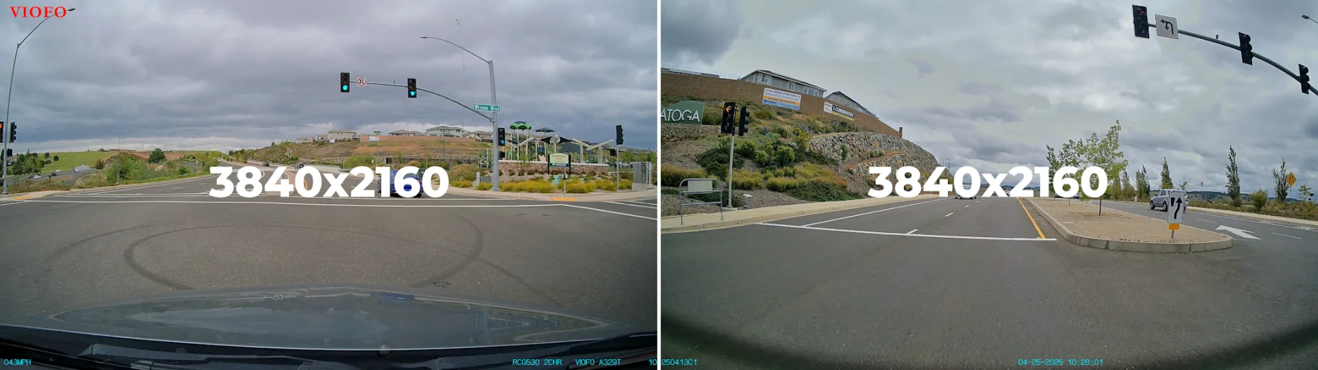

When multiplexing 2-channels [front+rear or front+interior or telephoto] it creates a 7860x2160 30fps video with the front camera video on the left side and the second channel video on the right side scaled up to 2160p resolution.
Note: I added the white line separators for these screen shots:
When multiplexing 3-channels [front + rear + interior or telephoto] it creates a 3840x3240 30fps video file with the front camera video on the top of the video and the two other camera feeds in the lower section with a side-by-side placement.

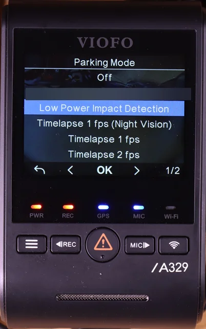

One of the new parking modes for the A329S/A329T is the "Low Power Impact Detection" [LPID] parking mode. I blurred out the name of the other new parking mode since I don't have the correct [new] hardwire kit to test it yet.
My initial tests of this parking mode were using a 3-channel configuration [front, rear, interior]. There are no settings specifically for the LPID parking mode, so you only need to select it as the active parking mode. The operation of this parking mode is very simple. When the ignition [accessory] power is turned off to the VIOFO hardwire kit powering the A329S/A329T, it will enter this parking mode and the power consumption drops to 34 mA @ 12.6V or 0.43 Watts. When an impact event it detected, the A329S/A329T resumes recording in just under 3 seconds [my tests show from 2.75 to 3.00 seconds]. When the interior camera is disabled in parking mode, the LPID parking records start in 2.55 to 2.65 seconds. A 1-minute recording will be created by default. If motion or additional impacts are detected while it is recording, the dash camera can keep recording for up to 3-minutes.
When the vehicle is started and the dash camera exits LPID parking mode, it will announce that an impact event has taken place while in parking mode. It then beeps every few seconds for up to 1-minute when the alert on screen will go away and the beeping will stop. It's nice that it it now announces the fact that impact were detected, but it seems like a really long time to have it beeping.
The video files created by LPID parking mode are stored in the "Movie\RO" directory on the microSD card.
There is another parking mode related setting that determines where parking mode video files are stored [Parking Files Storage]. The LPID parking mode will only store impact event video files on the microSD card. If you use a SSD as the primary video file storage for the A329S/A329T, you must also use a microSD card to store the LPID parking mode video files.

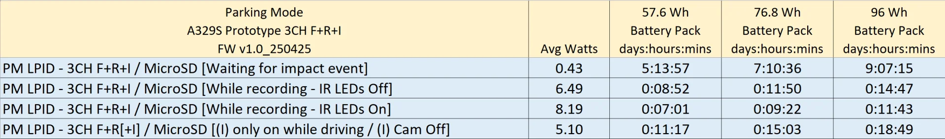

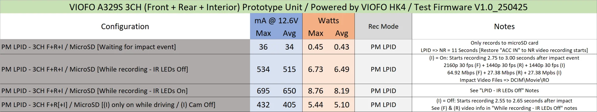

Power Consumption Info - LPID / 3-Channel / IR LEDs On and Off / Multiplexing Off
I included the power consumption data with the dash camera recording videos after an impact event so you can see how much power it draws while recording. The most important power consumption data is the "Waiting for impact event" since that is how this dash camera should be operating 99.9% of the time.
The power consumption in LPID parking mode is less than 10% of most other parking modes in previous VIOFO dash camera models.

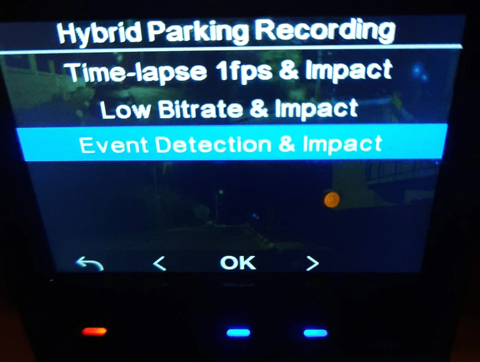

That's not how it works with the firmware I have. If I try to select any of hybrid parking mode settings, it presents a message on the screen of "Please set the Vehicle Battery Protection setting" and it disallows the selection of the hybrid parking mode. The only way to set the "Vehicle Battery Protection" setting is to have one of the new hardwire kits. The chart I have from VIOFO states that the hybrid parking modes require the new hardwire kit.
Go first to Parking Mode > Vehicle Battery Protection > Cut-off Time > Parking Recording Timer > 30 Minutes (for example)
and then you should have acces to this:
to have acces to this:
It appears setting only the "Cut-off Time" is sufficient to enable a hybrid parking mode, but it's only setting one of the two settings within the "Vehicle Battery Protection" section of settings. The other setting of "Cut-off Voltage" is the setting that requires the new hardwire kit. The VIOFO chart seems to be a bit too strict in its statement that the new hardwire kit type is required for the hybrid parking modes to work. If I get some time tomorrow, I'll test using only the "Cut-off Time" setting to see if a hybrid parking mode works with the firmware I have in my A329S. Thanks!
I consider to be normal and correct the hybrid parking mode to work if only enabling the cut-off time. In this way you are not forced to buy any special hardwire kit, you can still use HK5.
The hybrid parking mode is about saving the car battery and the cut-off time is for the same reason so they should work together.
