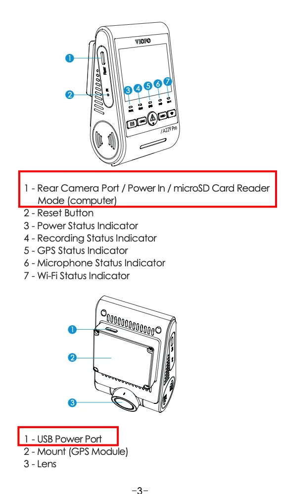

I see the BP-100 output cable is USB-C. Is it possible to adapt this to work with our A129 Duo which has a mini-USB port?
If not, the black Friday sale might be an opportunity to upgrade to something newer.
Type-C output cable is standard configuration, and we will sell mini USB cable individually later.

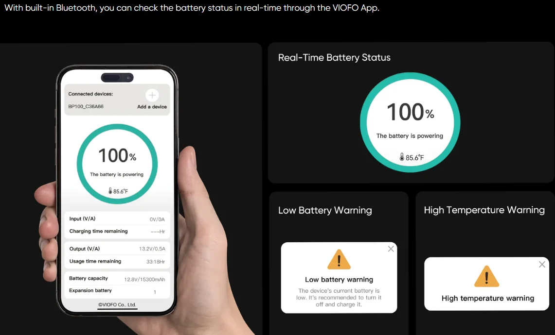

Does the Viofo battery app send notifications to a bluetooth connected device (e.g. phone) if the BP-100 charge is low, or do you have to open the app to check the status and see any warnings?
There are no push notifications from the battery pack/app. You must have the app running to see the messages/popups listed in the picture.
