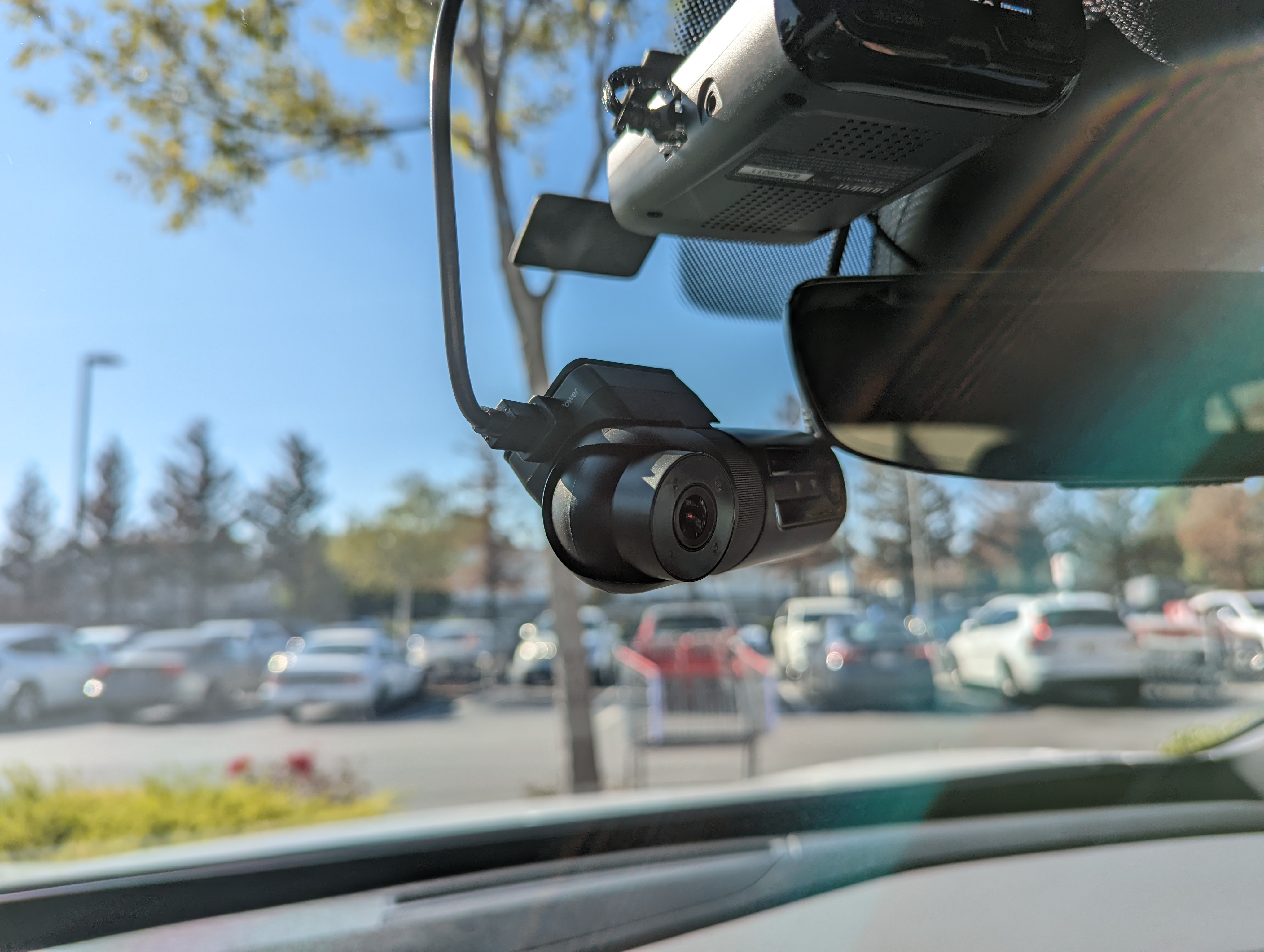

In my case the sticky pad stayed in the windscreen and the camera was hanging with the mount attached to it.View attachment 59138

Before gluing the T130 mount to the windshield, I cut out a strip of adhesive tape that came with the kit and glued the mount to the windshield. Our temperature was already -4 degrees, but the mount with the DVR is still in place.
