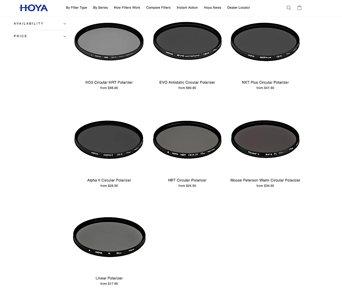

I've never worked out why they make most photograph CPLs quite dark? They are not all dark, some are quite close to 1 stop, but most are closer to 2, and some are 3 stops.
The quality and light transmission of a polarizer depends very much on cost, design, type of glass, thickness and coating technologies employed in their manufacture.
HOYA is known as the manufacturer of the finest CPLs in the world, especially their HD line of polarizers, which is now in their 3rd generation (HD3). It loses only 1 stop compared to their other offerings. Notice how much lighter it is than the others in the collection below. Check the specs on each of the models to see the transmission differences on each of those. I happen to own an original 1st generation HD1 version and it is quite impressive. They are rather pricey, however.
