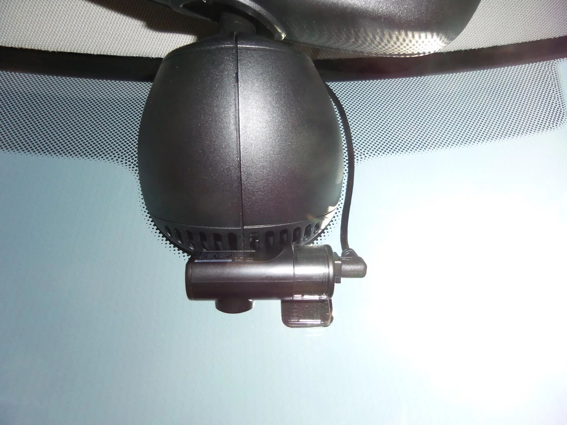

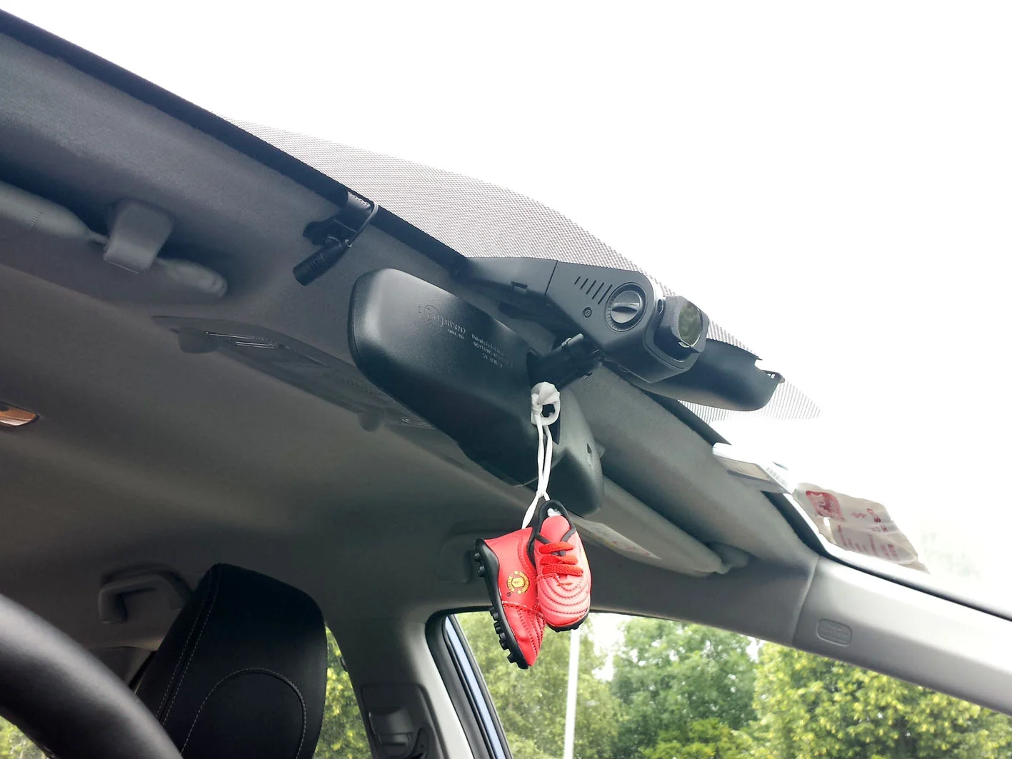

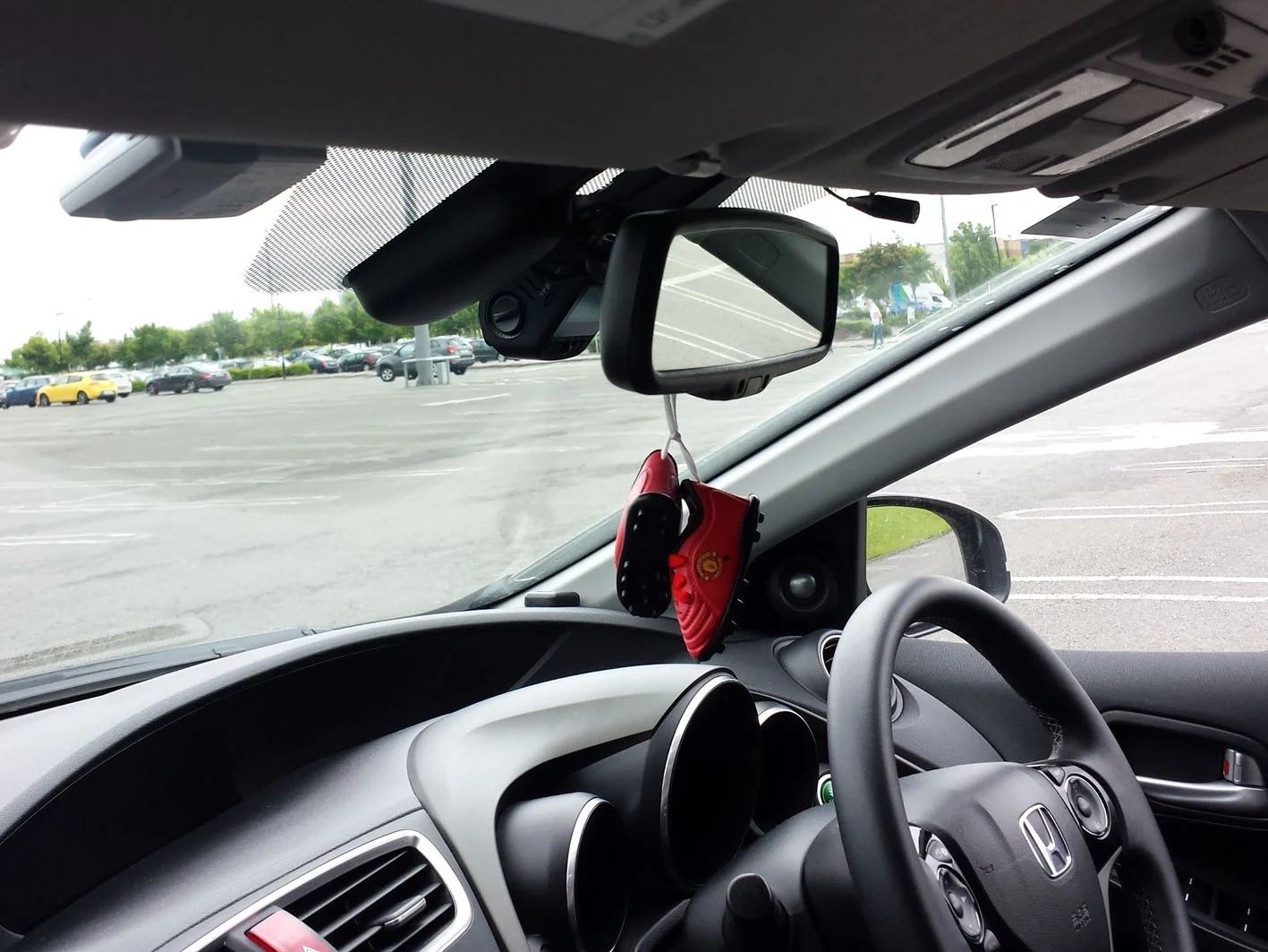

I previously mounted my SGZC12RC on the passenger side (RHD car) adjacent to the rear view mirror, as the sensor housing made central mounting a bit awkward.
I decided today to relocate it under the sensor housing, which is rounded, so it's possible to tuck the lens module under the housing, which acts as a background against which the lens "vanishes".
EDIT: Have now tested on the road, it seems to wobble about a little bit more than before but not enough to make any real difference. Added VLC snapshots of camera's footage before and after.

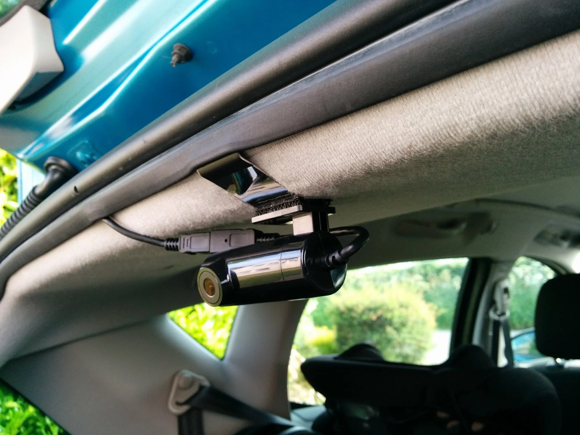

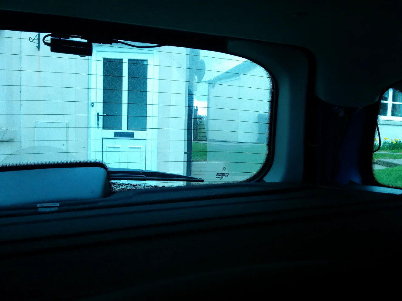

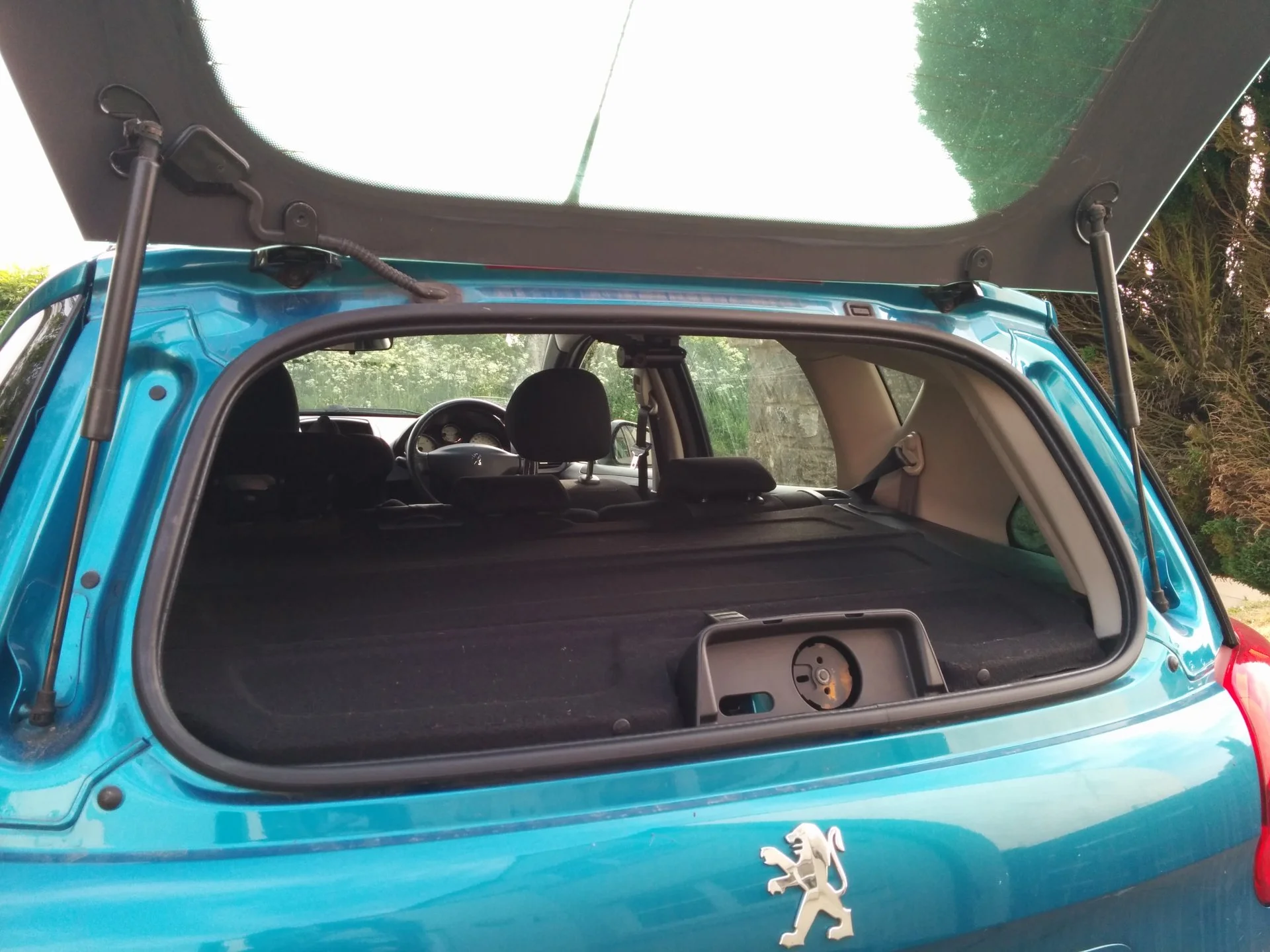

I reinstalled my CF-100's rear camera today, got sick of the wire getting in the way all the time. Also, since my cars rear door opens in two different ways, it needed more loose wire when only opening the glass hatch than when opening the full door. Failure to feed more wire through before opening the glass would result in snagging the wire. It used to look like this:
IMG_20160413_174232.webp IMG_20160413_174119.webpvlcsnap-2016-06-10-09h45m50s540.webp
And now:
IMG_20160609_182041.webp IMG_20160609_182139.webp IMG_20160609_182049.webp IMG_20160609_182114.webp IMG_20160609_182248.webpvlcsnap-2016-06-10-09h33m31s385.webp
That shiny thing is a bent money clip. I got the idea from here:
https://dashcamtalk.com/forum/threads/mobius-mounting-solutions.2654/page-32#post-166676
I just popped it in a bench vice and whacked it with a rubber mallet until it was roughly the right shape. The clip is stainless steel, grips really tight, and cost me 99p with delivery! I've put some electrical tape on the top side of it that faces the car's bodyshell underneath the headliner, just to try reduce heat transfer to the clip (I noticed it was getting really hot with the car sat in the summer sun). The camera is stuck to the clip using Command Damage-Free Hanging strips (3M Dual-lock, basically).

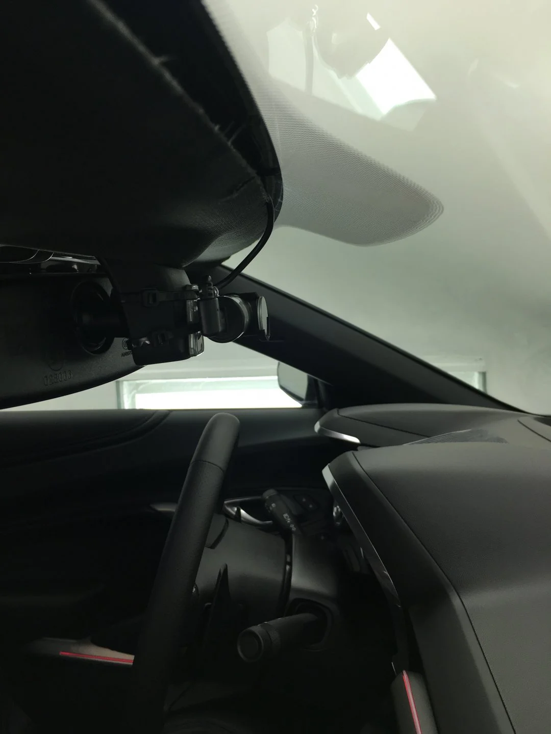

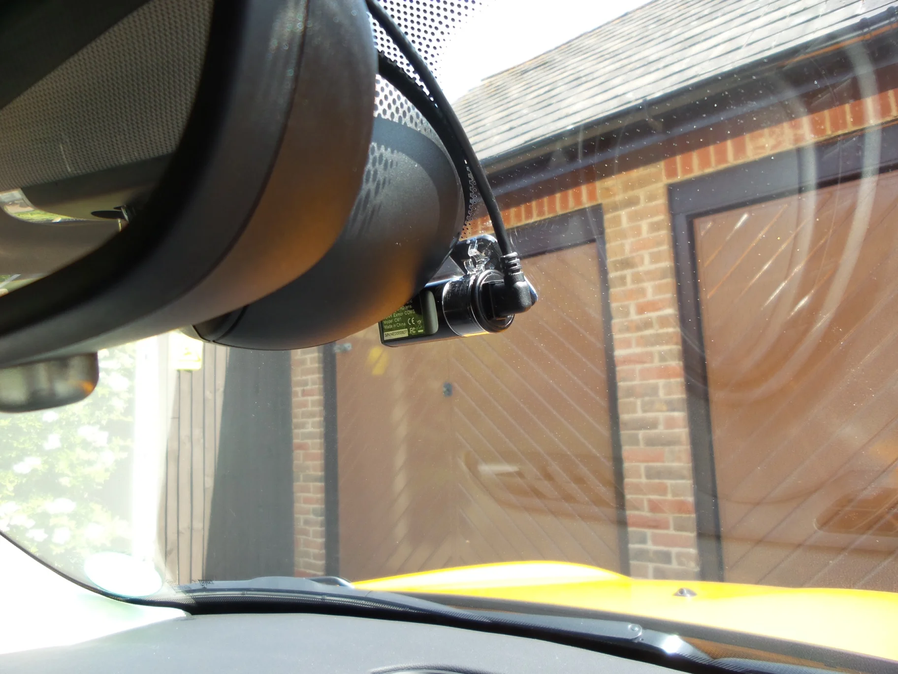

This is my Street Guardian SG9665GC v2 purchased from Hiniko, mounted in my 2016 Audi S1.
I flipped the GPS module and mounted the GPS in the top left of the screen.

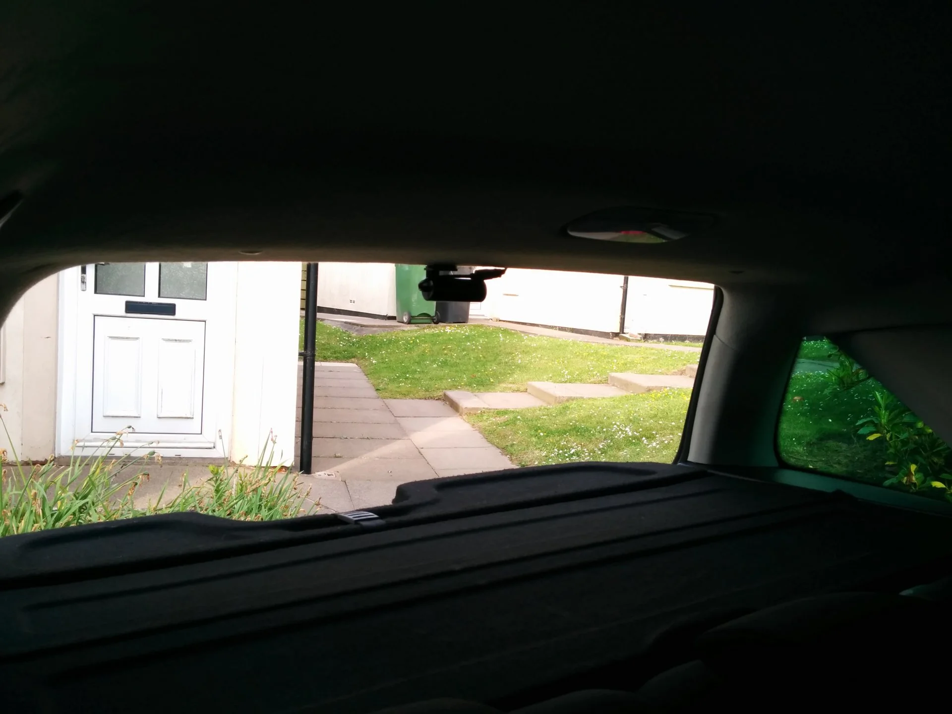

I think i have mentioned my rear camera several times, but allways linked to pics of the old way of dooing things.
So here is a couple of pics of the x camera and the metal bracket i have formed and screwed onto the x camera to space it out from the neodynium magnet on the frame of my rear hatch.
Works perfect only camera peek out in the window, and even at the very top of my rear window its still covered by the wiper.
Just unplug USB plug and ripp the thing off the magnet, only takes a couple of seconds, and no messing with the little SD card in the car.

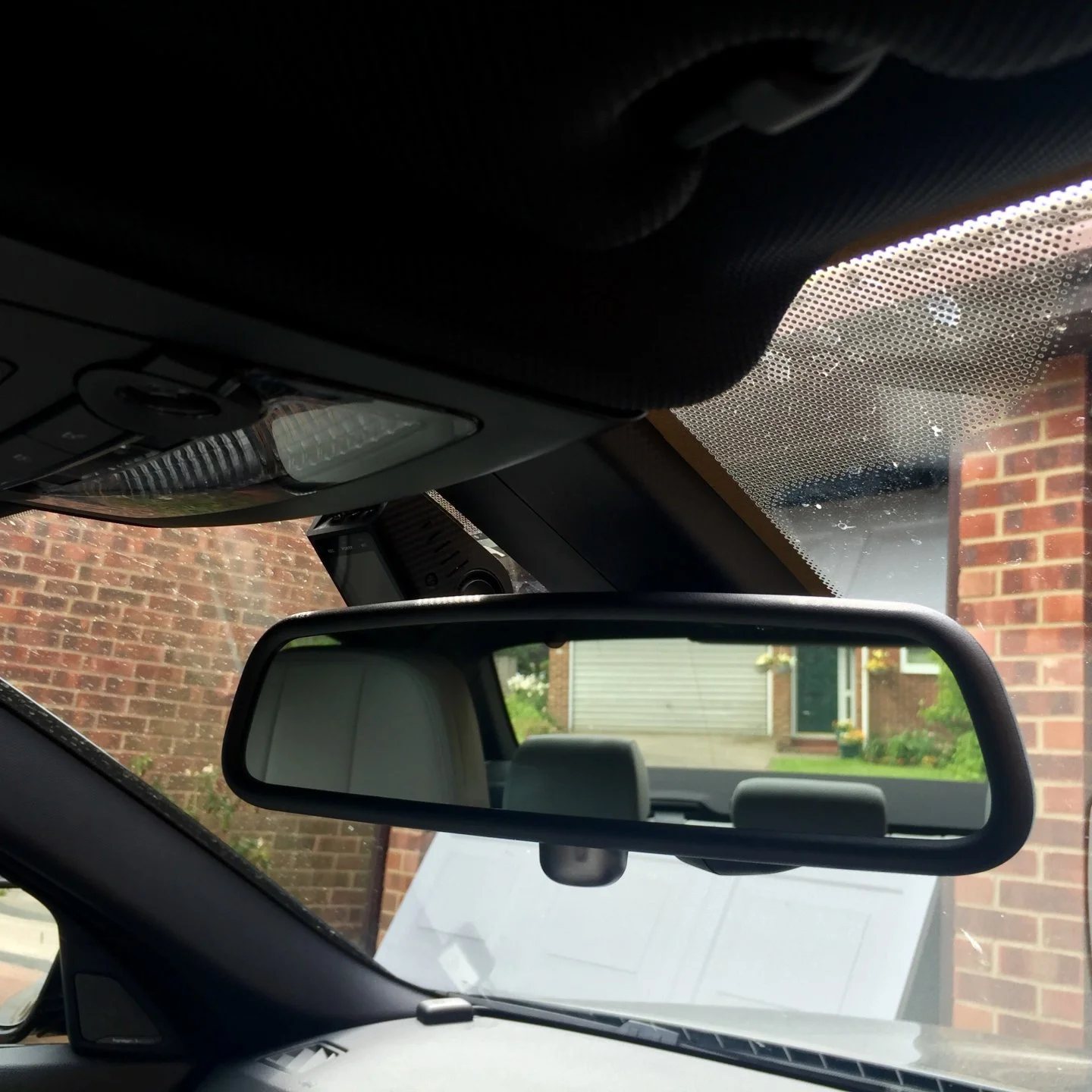

Hello everyone - first time poster here 🙂
Here's my installation of the SG9665GC v2 with CPL into my BMW 5 Series (F10). The rear view mirror and housing is pretty large which makes it perfect to hide the SG behind.
You can't get it up tight against the mirror house, otherwise it is visible during video play back.
I'm pleased, it is fairly stealthy, and is hard wired around to the passenger side of the dash, with the GPS unit in place on the dash.
Video quality is great, and I've had no issue with it after a couple of weeks use. Auto switches on and starts recording upon ignition after short delay so I don't have to worry about.
I have the mic switched off so cannot comment on that. GPS works perfectly and tests show perfect mapping of journey alongside the video footage.
Old earphone socket into the AV out means I don't have to worry about the screen on delay either - thanks to this forum for that little tip!

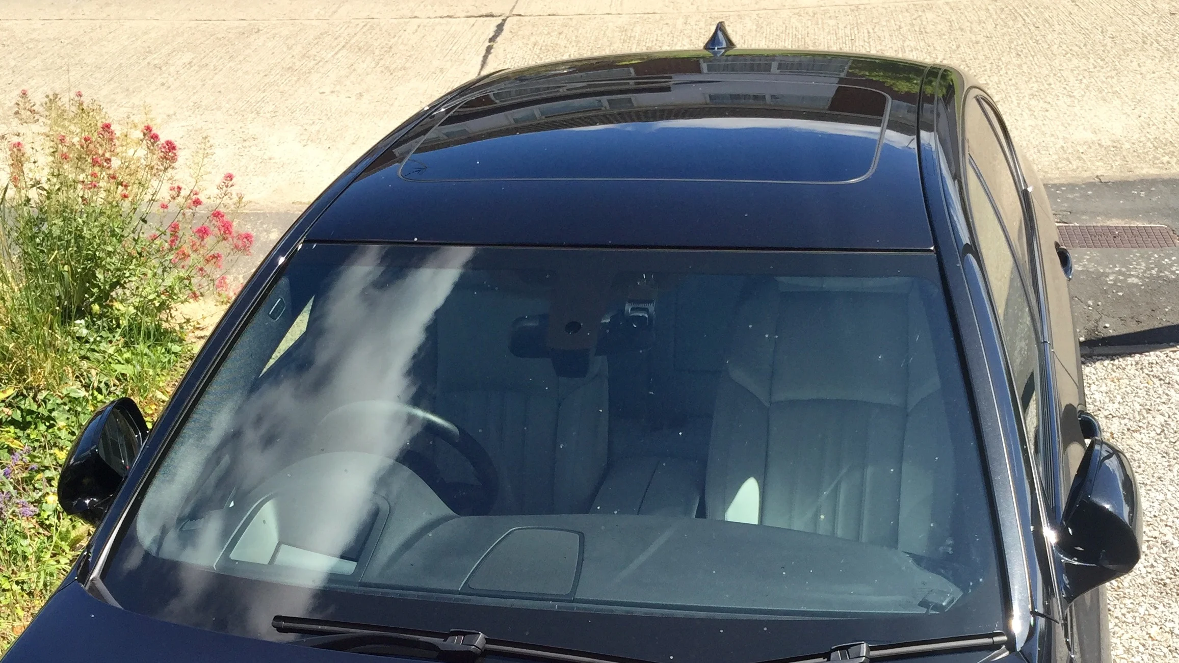

Excellent service from Nikolai @ Niko Distribution. Real fast delivery through Amazon, a follow-up email from him with advice and links to help/advice topics, and he was responsive when I emailed him. Thanks to this forum for helping me find him, and helping choose this great dash cam.
