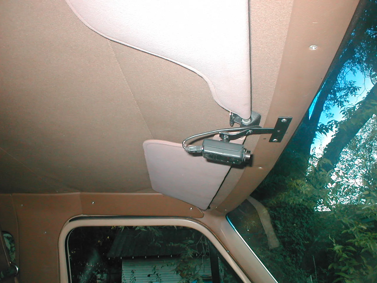

Mobius has been in front from day one, works great where it's at. JooVuu X cam may take it's place soon. Had to lose the mirror, but I have only used the outside mirrors in my vans so no great loss. I might do a small one in place of it someday.P8240032.JPG

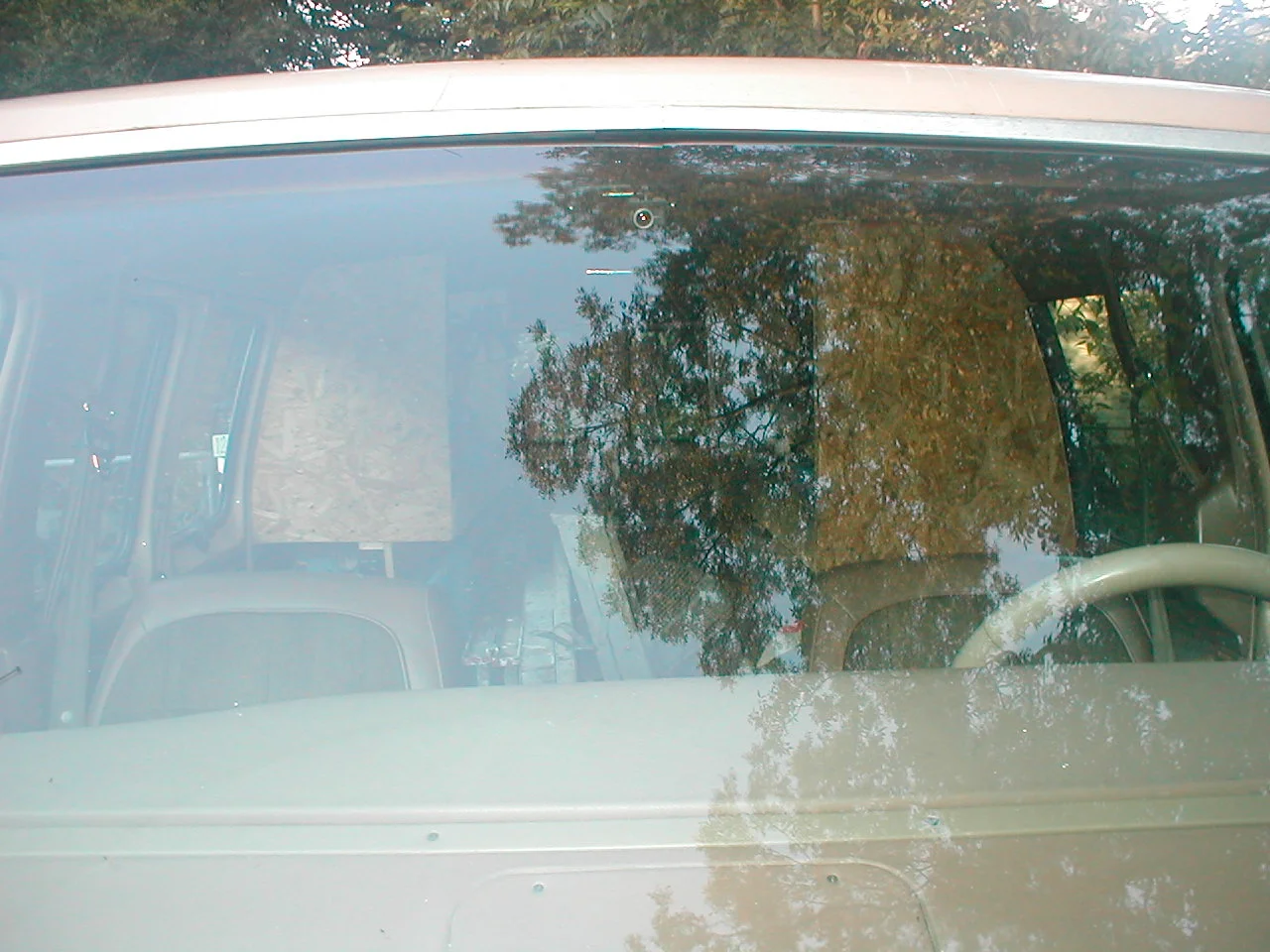

Normally invisible.

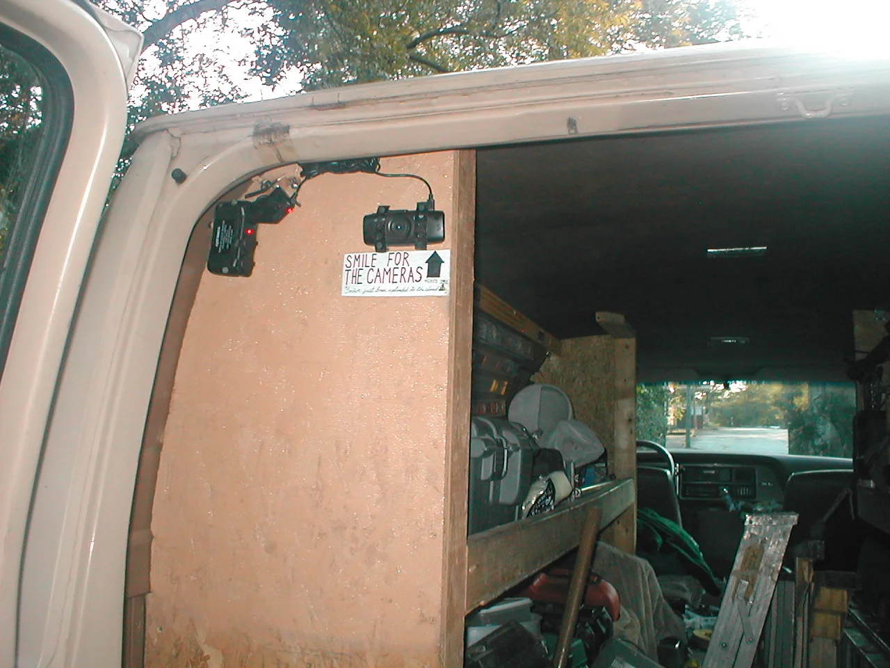

Ignore the mess please. Haven't cleaned or reorganized the workhorse in 3 weeks :oops: That's a 3-way socket far left so I can power other stuff from the back too. The PS for the cam has a screw behind it so it stays in. Painted plumbers strap and screws hold the cam and rubber vacuum hose at the top behind it tilts the cam downward for best view up close. There's a hole behind the cam so I can see the light of the viewscreen fron the front to know it's on. ;) The fine print on the sign says "You've just been uploaded to the Cloud" which we know this cam doesn't do but potential thieves don't know that. You can see Mobius up front.
Sorry about the reflections of the trees making the window looked scratched. I do need to clean the beast and tomorrow it will be spotless with everything back in it's place. I am currently running both cams 24/7 until I finish the wiring. There's a 10ga wire running through the upper left body framing down inside the windshield pillar then to a fuse tap. There's a 4 conductor 24 ga cable with it for future uses. It took 2 hours to fish those cables in :eek: but now they're safe, hidden, and protected . When finished it will be a 20A circuit :cool:
Love the sign.

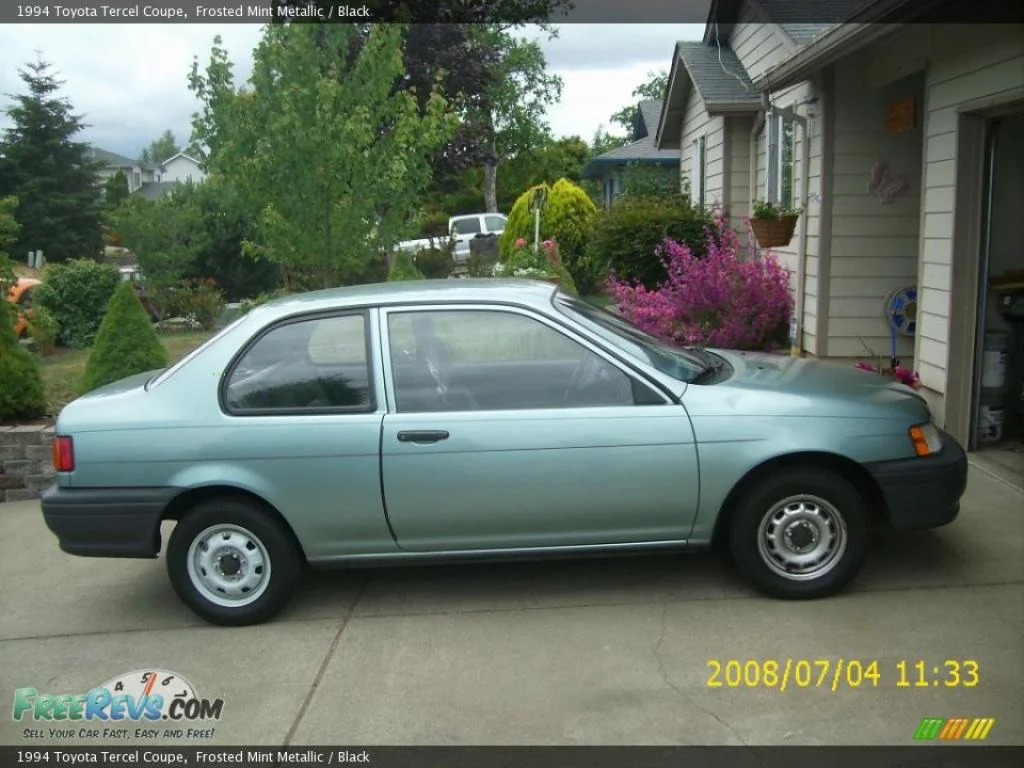

Back in the day, a lot of budget cars didn't have a passenger side mirror :D The Toyota Tercel and Nissan Sentra comes to mind.

The sign was for two reasons, first because the local idiots tailgate and knowing they're on video might help with that. Waiting to see if it makes a difference. Second is to provide some extra theft protection- the crooks face will be seen before he gets the door open and if they think it's already gone off-site to cloud storage maybe they will just walk away. They can at least be certain there is a cam there wh ;)
My van is usually well organized and stocked with a little of everything. One old boss said of my van "If Phil doesn't have it, you don't need it", and for the work I do it's a real time and money saver to have it all. I'm a rolling hardware store :cool:

From what I can see, you could mount the camera much higher on the dotted frit with just the lens visible from the outside.
I tried that, but there isn't enough space between the mirror and its mount. The windshield slopes in, so the higher you go the tighter the space becomes.
Have you tried moving the stem holding the mirror a little to the right and upwards, which'll give you more space on the left, you can adjust the mirror part as per the new setting that suits your view of the rear, that's if it moves at all.

I'm about to search for a cheap car like that green Toyota Tercel to buy as a commuter car. Pricing is about $1,000 USD. Got a new job and location will be close to 1 hour in bumper to bumper traffic each day. 20 mins with no traffic. An old company I worked for a teen had the same green car as a shop car. It was super reliable, couldn't kill it. It had no power steering, no power windows, no side mirror and manual transmission. I want the same thing, no features. I will buy a passenger side mirror if it doesn't have one though :eek: No use in putting all the miles and wear and tear on my good cars.
I will tint the windows super dark since it will be super embarrassing to drive a dinky old car :D
