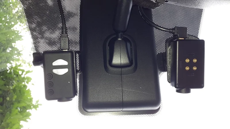

This is where I recently put my Mobius 1 and Mobius 2 tucked in behind the rear view mirror. They don't intrude much beyond the black dot shaded area.
This is close to the view from the driver's seat:

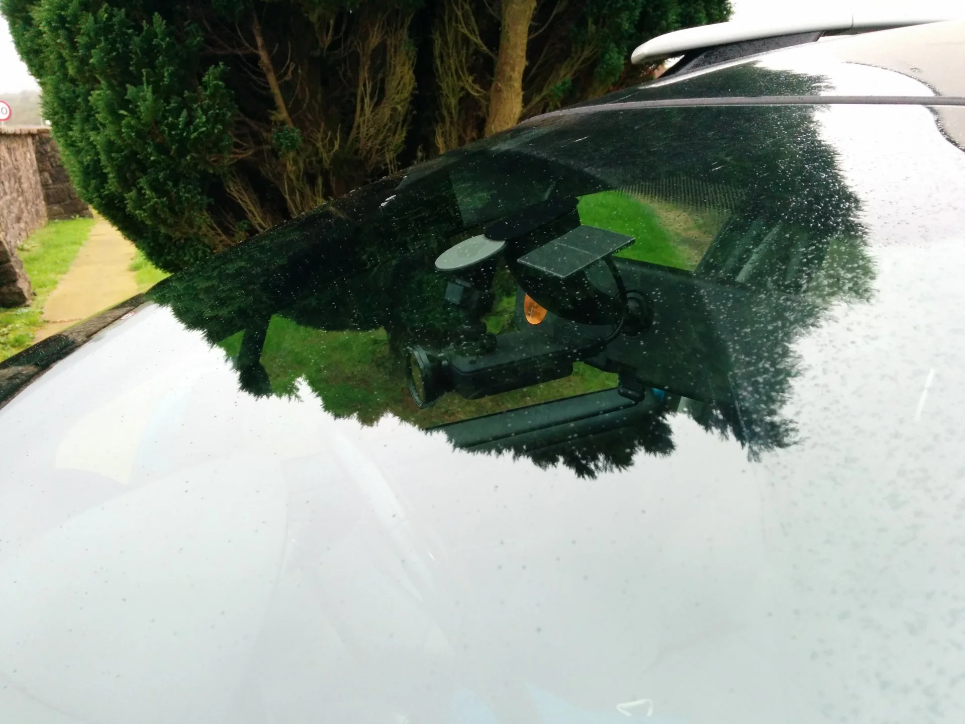

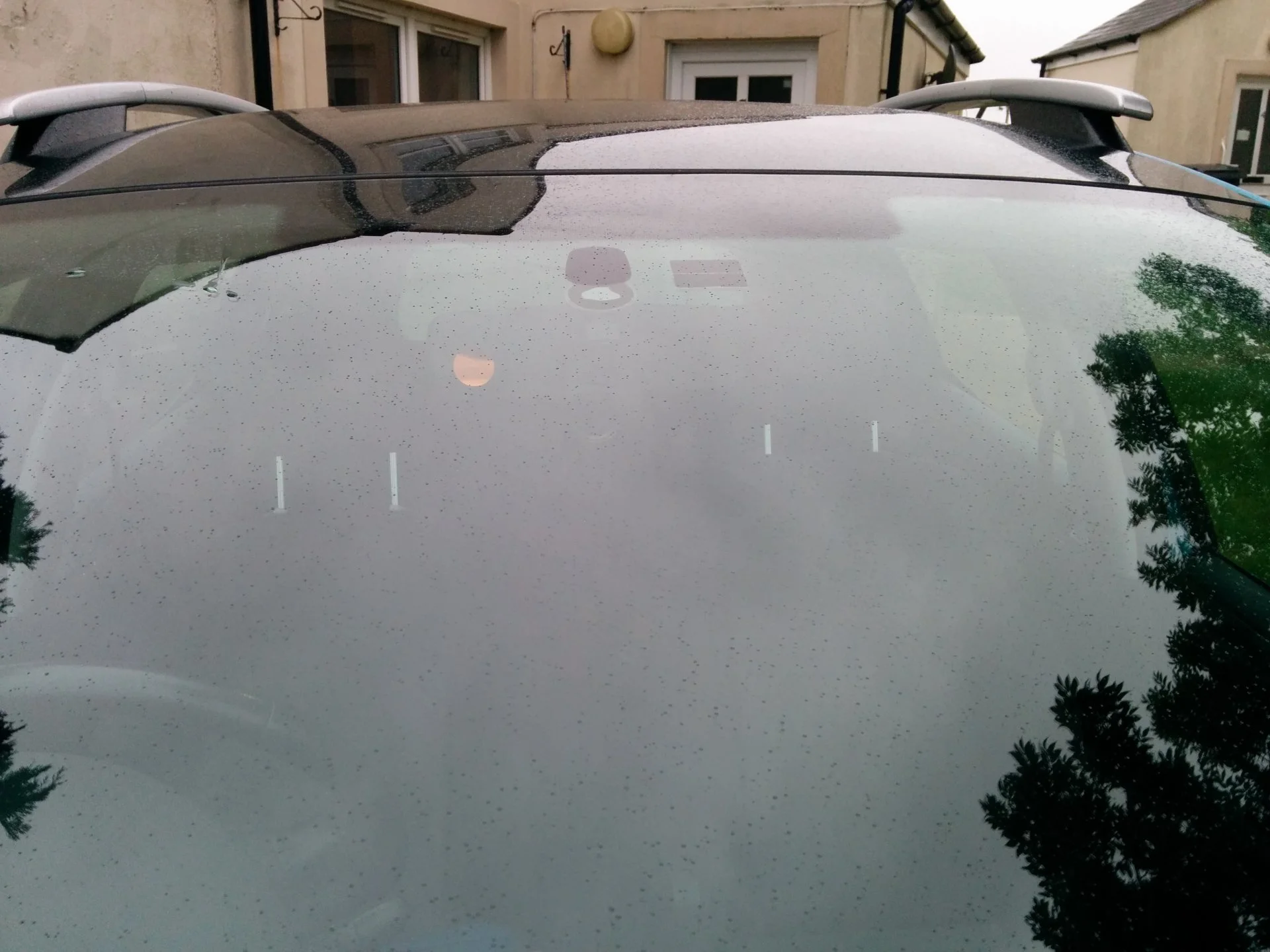

What I did with mine was apply some black vinyl adhesive sunshade material from ebay:
I can't remember exactly how I did it, but I'm pretty sure I stretched it as best as I could, used a craft knife to make corner cuts where necessary and then used a hair dryer to stretch it tighter. Overall, I thought the result was good and it's now very discreet in the car:

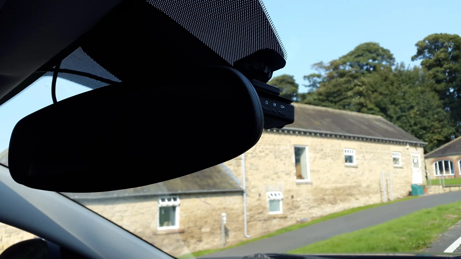

Update to my Mobius 1 mounting position, now using a lower profile helmet mount:

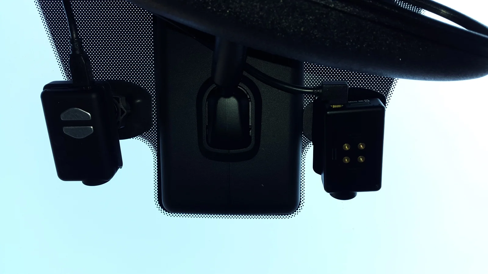

I've had the M1 installed on the passenger side of the rear view mirror for the last three years of MOTs without any issue. On the first occasion I played back the video later to watch what happened - ended up with a recording of the tester sat in my car having a private phone call with the police :eek:. I deleted the file straight away.
I've not had an MOT since installing the camera on the driver's side. From where I sit I can only see half of the camera sticking out beyond the mirror, so it's barely noticeable.
