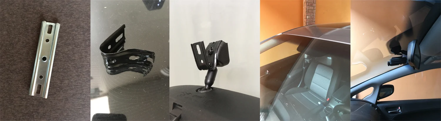

I ended up going with a mobius (from the question in this thread - https://dashcamtalk.com/forum/threads/cam-suggestions-for-3rd-world-driving.21475/) and its so small and light i figured i could fab something up with my not so skilled hands; which i did, using a cheap aluminum strip (the kind used to attach stuff to those small, inset electrical junction boxes, or whatever you call them). I just bent it to shape with a hammer and painted it black, then attached it to the rearview mirror via the existing screw hole. Luckily i had a longer screw with the same threads. The mobius sticks to the strip with velcro. Still working on the wiring, thus cam not wired in the photo...
Ingenious DIY. Great job! 🙂
Dude! That is pretty brilliant! I approve.
