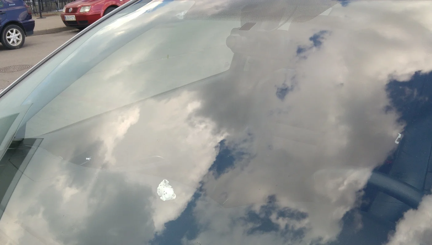

Viofo G1W-S looks hidden when seen from far away. I used to black electrical tape to cover the Viofo logo & white light.
You can only see the lens in this closeup of the windshield.

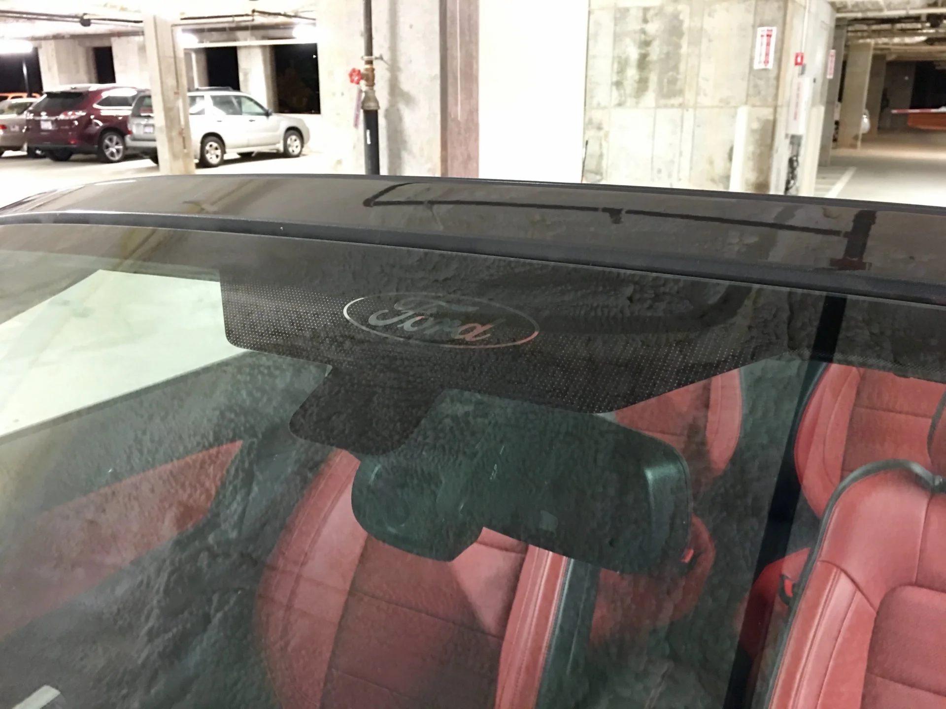

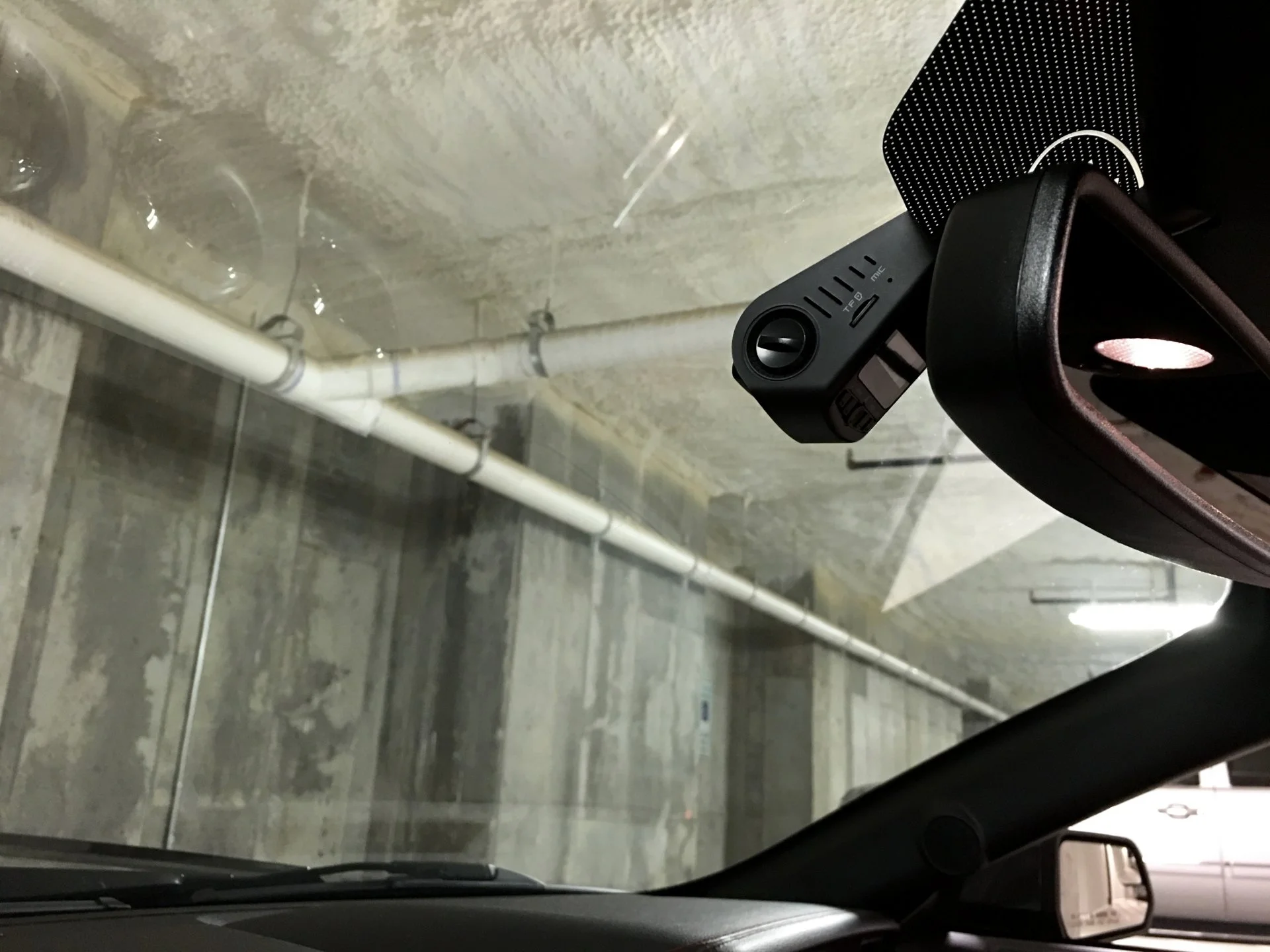

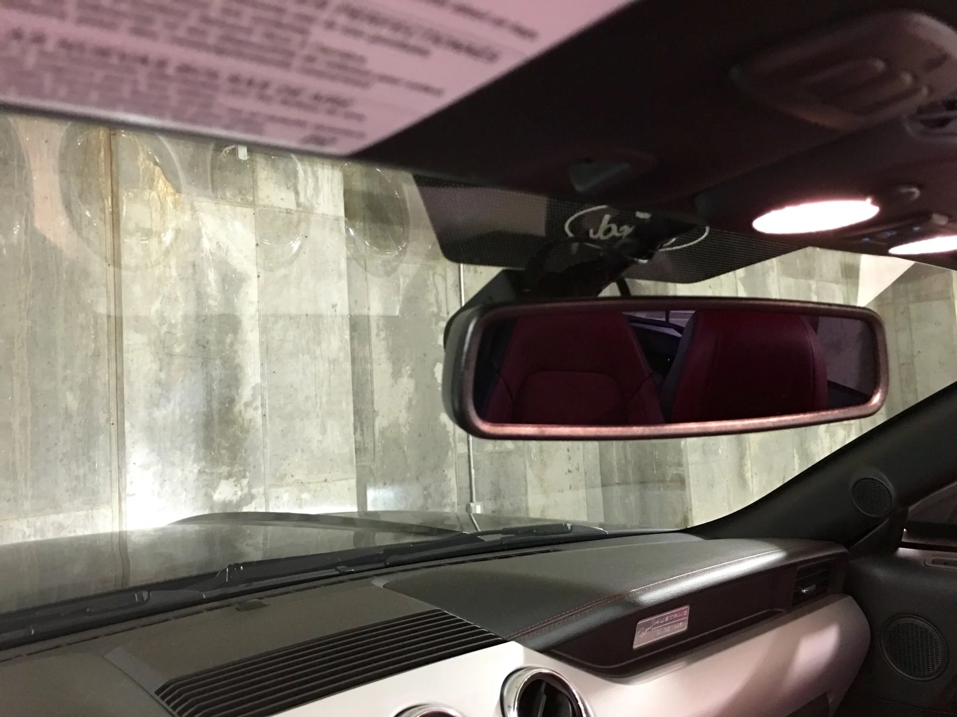

I tucked mine up behind my rear view mirror and ran the wiring down the passenger a-pillar to the fusebox.
Same here. The factory conduit for the mirror cable had an opening on both sides, so I was able to use that to make it appear factory.

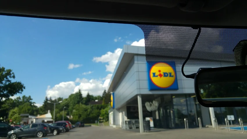

I had to mount my SG9665GC down from the top of the windscreen to get the lens within the swept area of the wiper blades. It protruded well below the black dotted area at the top of the windscreen.
I used black vinyl to hide the cable tidy and the camera body. I only thought of this as I saw a post from @Blackdog doing something similar.
  • I marked the area (to be covered with vinyl) accurately on the outside of the windscreen with masking tape.
  • I cut the vinyl to size using a straight edge and a Stanley knife on a sheet of wood.
  • I sprayed the inside of the windscreen and the sticky side of the vinyl with a water and washing up liquid mix. Then I applied the vinyl to the inside of the windscreen (lining it up to the masking tape on the outside of the windscreen). The water and washing up liquid mix allows you to position the vinyl easily.
  • Used a wet cloth to wipe over the vinyl while making sure it stayed aligned with the masking tape.
  • Finally used the scraper with a rubber edge (supplied with the vinyl) to work all the air bubbles to the edge of the vinyl.
  • Left for 24 hours and mounted the camera.
Am pleased with the results and the colour match is good.
