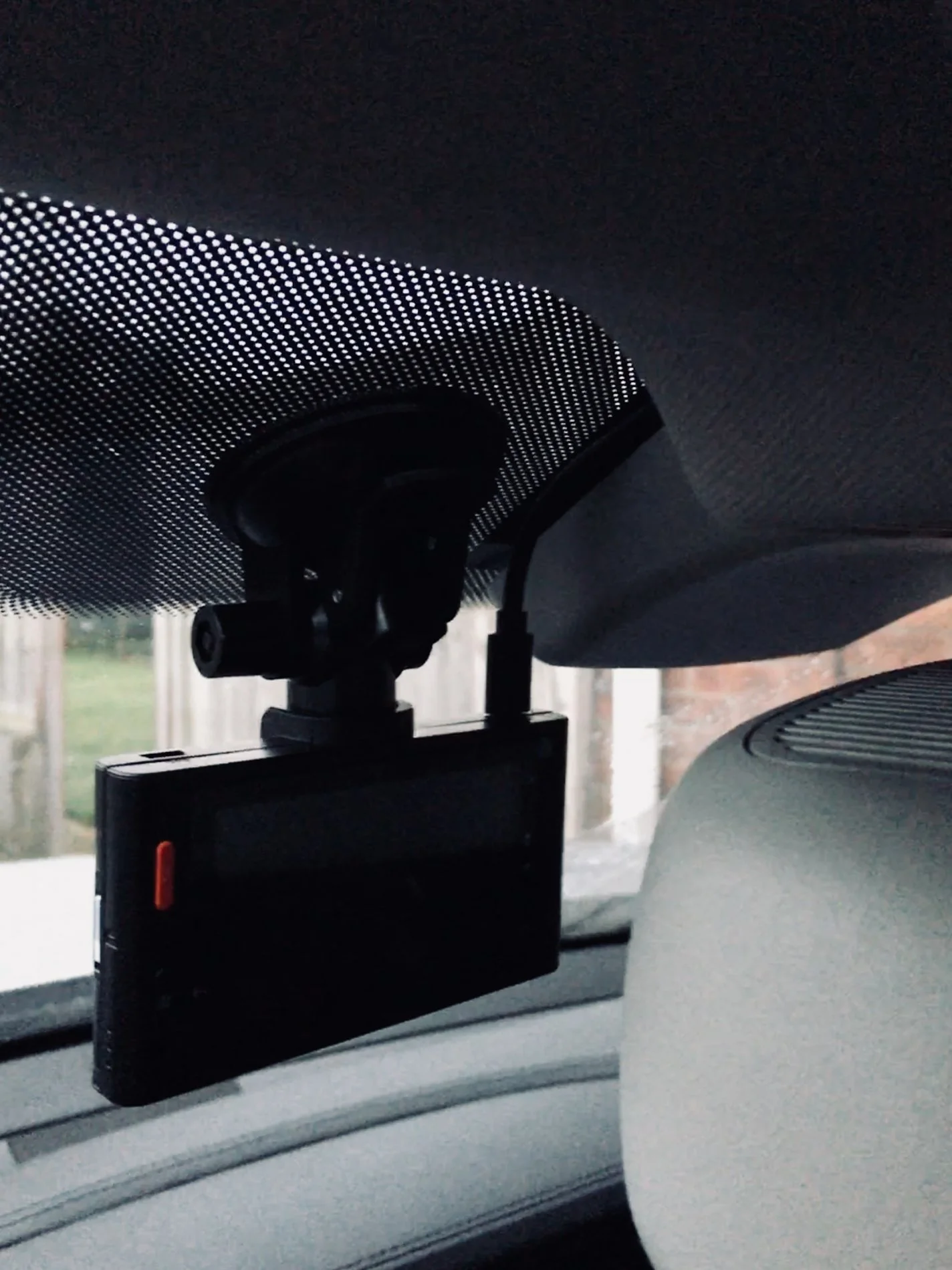

A nice install 👍 Might want to aim the lens down a notch if you get washout in bright sun 😉
And Welcome to DCT 😎
There is a big problem with the headrest mounting location... In my car at highway speeds it vibrates a lot. It seems like a harmonic vibration

Why not get a mount to stick it on the windscreen glass or dashboard.
Hell if I can fit it to the rear screen of an S Class Coupe ( an extremely low-raked screen) pretty sure you can get a bracket?
Not exactly a great job, but pretty much hidden by the mirror from inside ( 100% hidden from driver , circa 80% hidden from passenger.
And all the mounting crap is hidden from outside by the black hatching on the screen ( its solid gloss black from outside!)
And hopefully will improve the look when I go to the much smaller compact 3M sticky pad mount.
If you just dip your head, you can just see the comforting red “recording led”in tne bottom left hand corner.

Because having the interior of the car captured too is pretty cool. And because I don't want mess with my A pillars because there are airbags mounted in them
I definitely understand you concern of messing with airbagged A pillars. The covers of my A pillars are very firmly fixed , I was lucky one could just fit the cable under the edge.

I think you're right, the aluminum could be dangerous so I'm removing it. I put the camera on the windshield and ran the cable behind the visor and velcroed it to the grab handles, then ran it down to the cargo area power port.
The Golf has no gap between the headliner and the body, it's really tight, and there are airbags along the entire length of the roof
