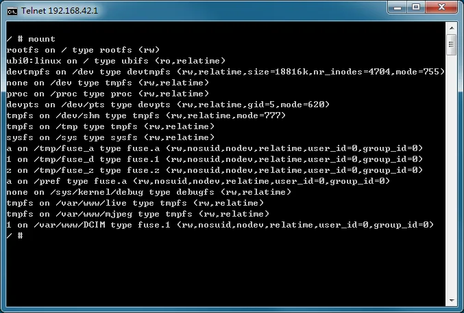

I run this code in window command line, nothing happen.
Code:
telnet 192.168.42.1 8787
what else I can try?
edited: no need to type the port number
Code:
telnet 192.168.42.1
it works now:
mount as read & write, use as your own risk:
Code:
mount / -o rw,remount
