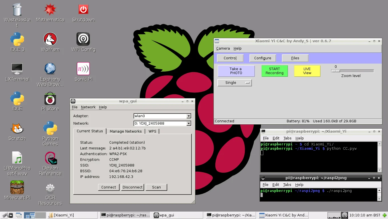

Not able to dismiss the error dialog - won't respond to mouse clicks on the button.
Of course, once I made the WiFi connection, got it going - even though it's not the colorful, organized interface I expected.
Still, I couldn't dismiss the error. Had problems displaying other windows too, but, one thing at a time.
Oh, yeah, Mac/Python.
Any help?

Hi @Andy_S
I think at the moment, you need to find out the correct wpa_supplicant setting by yourself.
@luckylz: it is not about the setting, wpa_supplicant refuses to launch at all to do its first scan (for which it doesn't need any setting)
@Squeamish: It really looks WEIRD on your computer, what OS version are you using? some older one? Also you need python 2.7.x. I am developping new version of the app using different framework (kivy - goes over OpenGL) so it will look totally different.
@luckylz: ...It really looks WEIRD on your computer, what OS version are you using? some older one? Also you need python 2.7.x. I am developping new version of the app using different framework (kivy - goes over OpenGL) so it will look totally different.
Nothing weird about the system: Plain vanilla Mac OS X 10.10.3 - the current version with no system extensions using Python v 2.7.10 as you suggest. Tried again, connected properly first, and got same result.
The other issue I'm having is that the "Configure" window is empty, aside from the blue bar at top and buttons with no color. The "Files" window appears OK - except the buttons.
Last item: After I exit the camera and end the Terminal session, VLC is still running in the background. Is that normal behavior?
Thanks.
Yes, VLC is launched as a separate thread, so you can close CC and keep vlc running.
